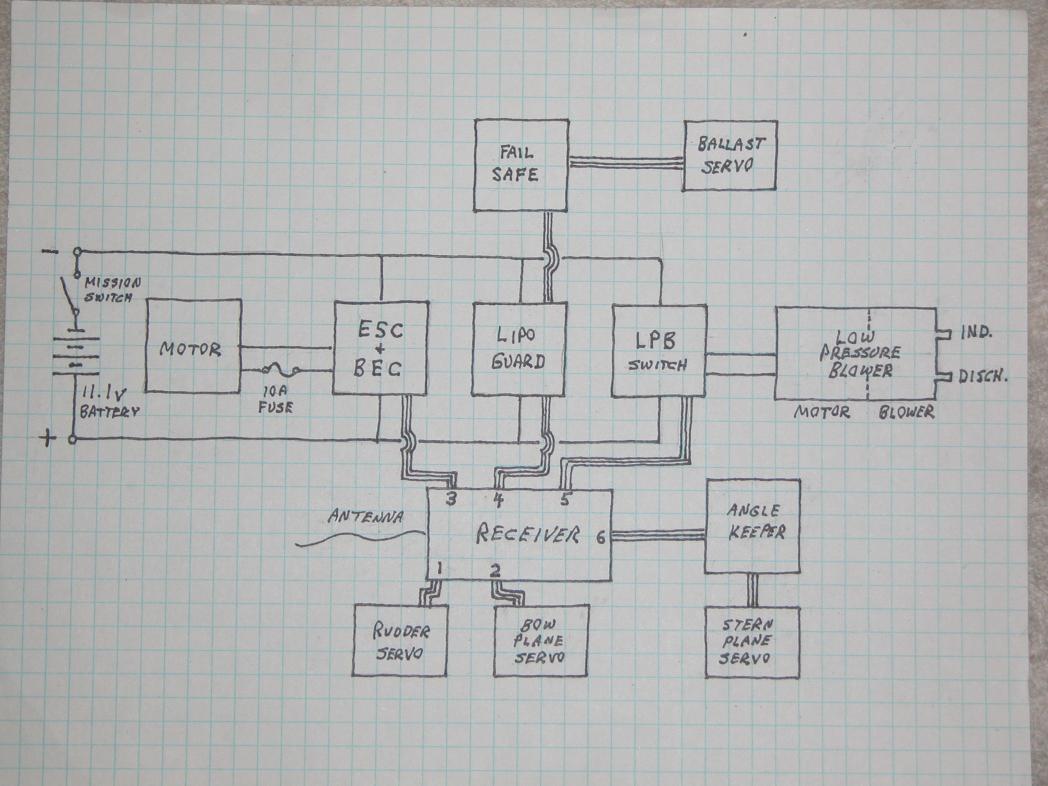

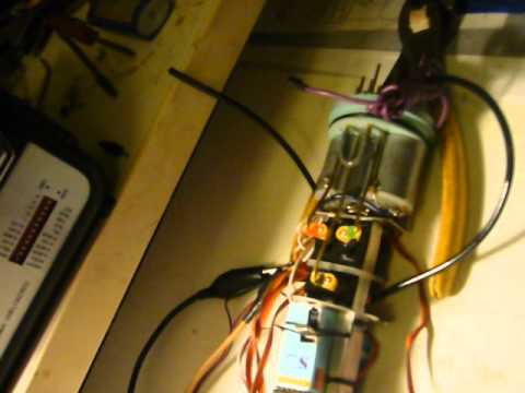

    so i am still a little confused and need some help is how too hook up the f/s side of the adf2...what can i say i am not getting it. also i have a Y harrness attached to the f/s adf2...a mistake was made in the vidio, the ornge servo is miss identified as the stern planes it's the bow plane.. another thing is is that normal for the speed controler to surge in reverse? thanks shane

    OK, from the receiver, ch-4 port:
    The Lipo-Guard plugs into the receiver ch-4 port; the Lipo-Guard outputs into the input side of the ADF's f/s circuit; the output of the f/s circuit (as you now have it configured) goes only to the ballast sub-system servo.
    It looks like, in your video, that you're operating the LPB off ch-8. Fine, but sometimes you forget and leave the pump running as you try to dive.
    I recommend you put a Y-lead to the output of the f/s circuit and drive both the LPB and ballast sub-system servo off that single, spring-loaded stick -- left stick 'vent', right stick, 'blow'. The entire ballast management done off one channel, ch-4.
    That stutter of the motors in reverse is bad. Try re-setting the ESC to your transmitter. And check your antenna wire -- are any bare wires hitting the device tray or other items?

      how about revising the above drawing to show:
      Myron
        • 13982
        good point, Myron. I should do that.

          I would also suggest it be included with every Subdriver.
            • 13982
            That's another fine suggestion, Myron. You're on a roll.
            • Snipah
              • Jul 2012
              • 67
              I also suggest it be put in a future Cabal report and place it on the website.
              That wiring layout is the missing link. chop chop cookie boy!!!!!!

                  ok got it figured out and the adf2 failsafe to the vent/blow servo and it works....
