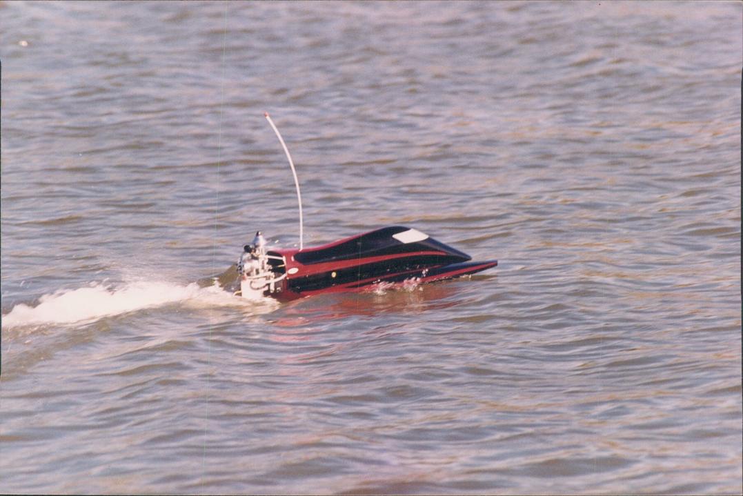

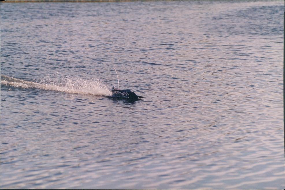

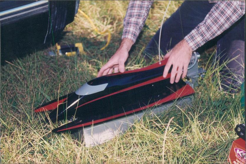

    My first glow boat . It comes as a kit made up of birchClick image for larger version
ID:	100009 and mahogany plywood. I tried some unusual things back then. I didnt like to see the wood grain on the surface of the boatClick image for larger version
ID:	100008 so I tried painting on CA onto the skin and let it soak in and then sand. After this treatment 6 heavy coats of POLY-U polyurethane.Click image for larger version
ID:	100007 It came out looking like a piece of glass. You could comb your hair in it. That was way back when I had hair.Click image for larger version

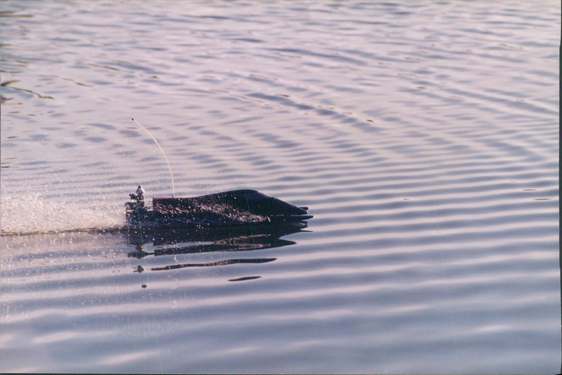

          Tragic circumstances led to the loss of this boat. Almost like the" Bermuda Triangle". I had modified the boat with a tuned pipe and was tuning it at a new body of water that I had found. It was a large lake that had a canal on the far other side that emptied into another smaller pond. As I had previously mentioned water had gotten into the radio box on several occasions but not a huge amount and I assumed everything would be OK as it was working fine at the present. I was having trouble getting the needle set the way I wanted and I figured I would have one more go at it. I launched it and it seemed fine. Then all of the sudden it took off like someone else was controling it. Murphys law had interferred and believe it or not it was heading for that canal!! The bad thing about the canal is that it would then leave my line of sight. If I could see where it went aground then I could make a recovery. Well as I watched it disappeared for a few seconds into the canal and then I could hear the engine race and then slowly die. I got in my car and drove over to the other side of the lake. All of the banks were heavily overgrown with thick brush and foilage. I came back the next day with a canoe and plied the area but could find nothing. The problems were many but one of them was that the boat was black (just like the water, black as ink)......................and it was never seen by mortal man again. On my next boat I painted it red and used a radio with a failsafe. Also I made sure that the radio gear stayed high and dry. That was the last time that I used that lake.I went looking and found a much more suitable location and I never lost a boat(permanantly) again. The End
