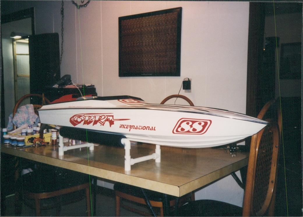

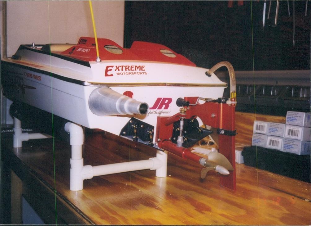

    Back in 1994 I purchased this boat from a Florida company called International RC. The owner John Mellis has since died and so did the company. It was truly ready to run with the hardware manfg. on site.
Name:	flash drive 3 321.jpg
    The hull is a Aeromarine 50" Apache deep vee. He installed in it a 30cc Homelite 2 cycle gas engine that he marinized.
Name:	flash drive 3 328.jpg

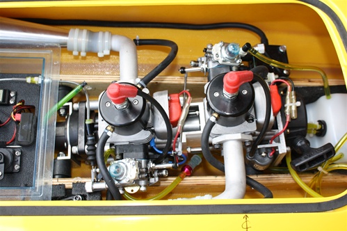

    I still have the boat but have recently re-engined.
Name:	flash drive 3 315.jpg

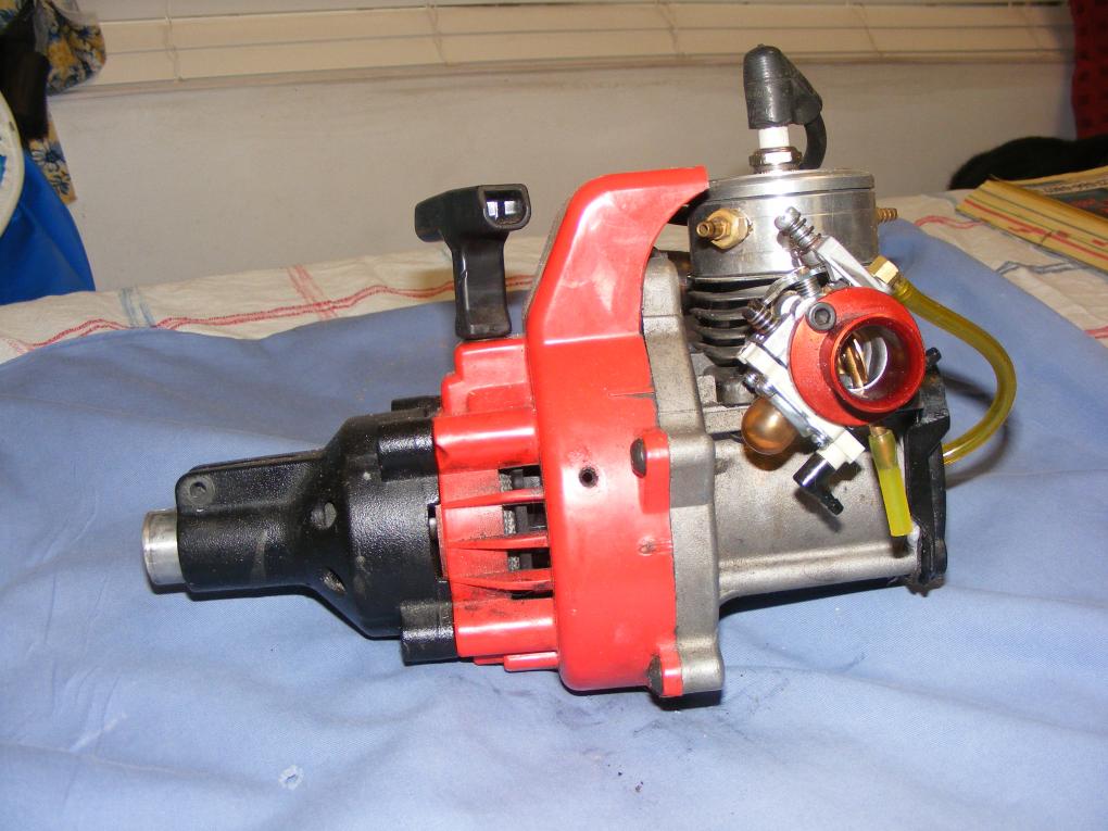

ID:	99988 Here is the old Homelite that he hopped up for me.
Name:	flash drive 3 324.jpg

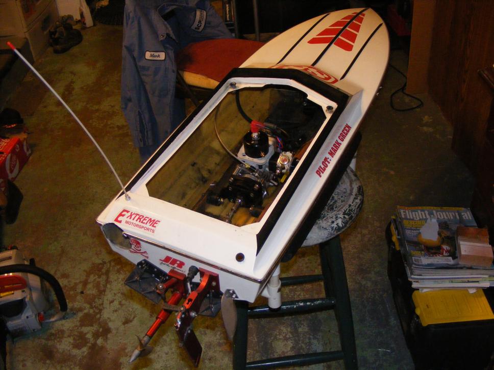

    Here is a view without the tuned pipe that normally sticks out the hole. You can see the fully adjustable outdrive and Octura rudder. More pictures and videos later.

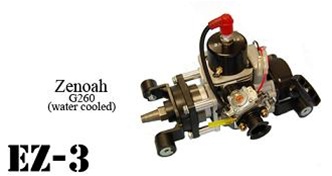

    The new engine is a Zenoah, surprisingly light and small but built much better.Click image for larger version
Name:	flash drive 2 242.jpg
ID:	58574 In this shot you can make out the clutch thats mounted on the output shaft end. The prop is so large on these things that you dont have to worry about cavitation so much that you have to launch it. You can just set it down in the water and slowly apply the gas and the clutch engages smoothly and you can either hammer it or just putt putt away as you choose.

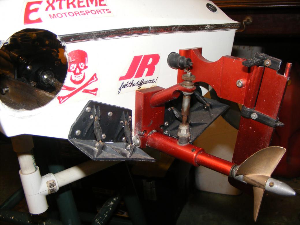

ID:	58631 Here are some better pictures of the boat.Click image for larger version
ID:	58630 You can clearly see in the one picture the trim tabs that I installed to keep the boat from chine walking at speed. You fine tune these tabs to get the kind of ride that you want. Aeromarine also makes a 55" Apache , a little bit longer and wider so that you can install twins if you like. Notice the ventilation holes that I cut in the upper deck. Out of view is the turn fin that helps give the boat some leverage in a turn.
