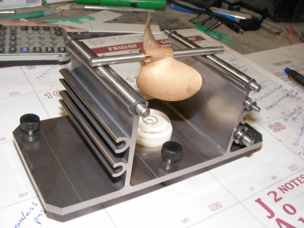

I took the day off of working on the Skipjack to sharpen and balance a couple of propellers for the 13cc outboard on the predator. Im looking for a little more speed(as usual). You just have to keep going up or down in propellor sizes until you find improvement. Here I have a Octura 1460 prop on the balancer. After that I will give the Octura X460 the same treatment. The difference between the two props is that the 1460 is a lifting prop while the X460 is not, although they have the same pitch and diameter.
