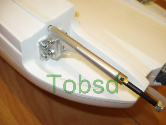

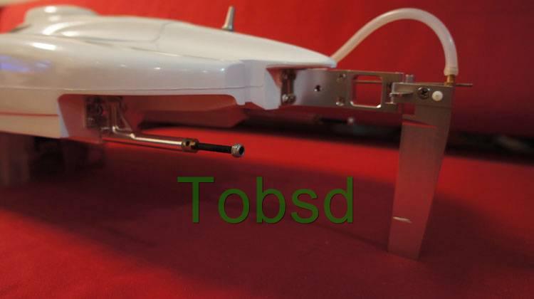

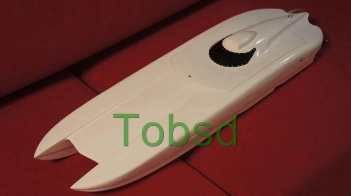

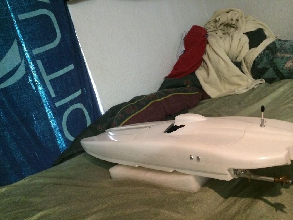

    I ran across these people on EBAY. A Chinese company that seems to have it all together. I ordered this hull from them yesterday. The slow boat from China should have it here in a couple of weeks. After I receive it, Ill then order the two brushless water cooled motors and the two 120 amp ESCs and counter-rotating props and udder stuff.

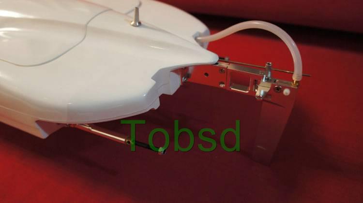

    Its supposed to hit 80 mph. The ESCs that he sells, are not water proof. So Ill be looking into that. Ill be using the now discontinued Spektrum DX2E 2.4 ghz radio that I have had so much success with. I can still find receivers for it on Ebay. His method of water cooling I dont like. He sticks brass water tubes down into the water. I have personally experienced many handling problems and lots of drag by using such a system. Ive got a better system in mind that has no drag penalty's with it. As far as a paint job for it , I think I will use the black/silver/red of the Budweiser Select/Bacardi silver boat, without the lettering and logos, unless I can find some in this boats scale.

      I did take delivery of this hull. I am impressed. So much so I just ordered the 2 540 brushless motors from them. We decided that since I will be running on 6s Lipo, that the motors will be of the 1800 kv type. Also 2 40mm counter rotating props and 2 water jackets for the motors. Since they dont sell water proof ESCs there, I will buy my 120 amp ESCs somewhere else.
        The elsewhere was Gonotro Hobbies. They had 2 completely waterproff 120 amp ESCs made by "Dynamite". I have taken delivery of them and am STILL waiting on the motors and props from CHINA................................STILL! Tracking says they made it to the states. They are in Chicago.....in transit.
          The slow boat from China arrived today.......................FINALLY! Beautiful, good quality product, or so it appears. Two huge Honkin motors with 5mm shafts with factory flatspot, with water cooling jackets and two 40mm counter-rotating aluminum props. I have everything else I need except the water cooling pickups......another slow boat from China. I wonder If it has set sail yet? Its either on a sail driven Sampan or on the Kobiashi Maru with 9 scheduled stops before it reaches the U.S.

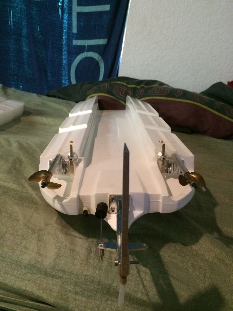

                  Today, was the day. Ive been working so much lately, that it was nice to get in some build time on this project. I installed the two motors on there mounts. What a Pain. Trying to get those screws to thread in where you cant even get your fingers. And then put blue loctite on them as you are slowly, methodically, laboriously, 1000th of an inch at a time, threading them down in. Then installing the receiver and hooking up the rudder and servo and linkage. Then the water cooling. Here you can see these special mounts that hold the tube in the water stream being thrown off by the props. In the first picture you can see the drive line angle that I have set up in relation to the bottom of the hull. A very important adjustment if you want to keep your boat from blowing off the water every time you nail it coming out of a corner. Next time, the ESCs.
                    The rest of em. In this shot you can see how deep the rudder is in relation to the boat. It needs it to keep it in the water.
