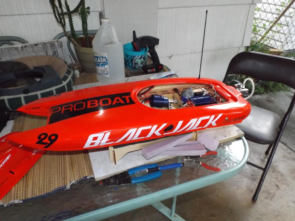

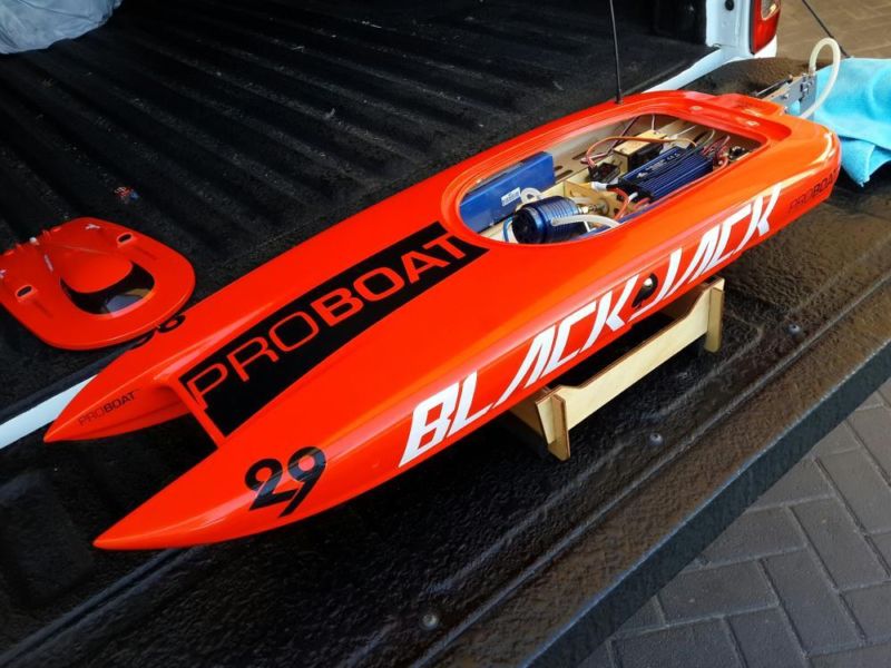

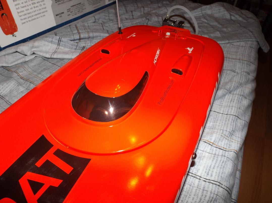

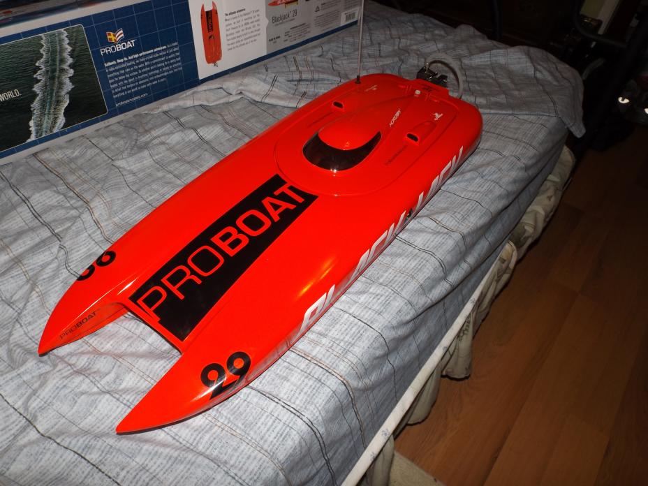

OK, got this this morning from the friendly, in a hurry , FEDEX guy. It was packaged very well and its bigger than I thought. Very nice construction. After I run it Ill give you my impressions.With the waterproof clear cover off.

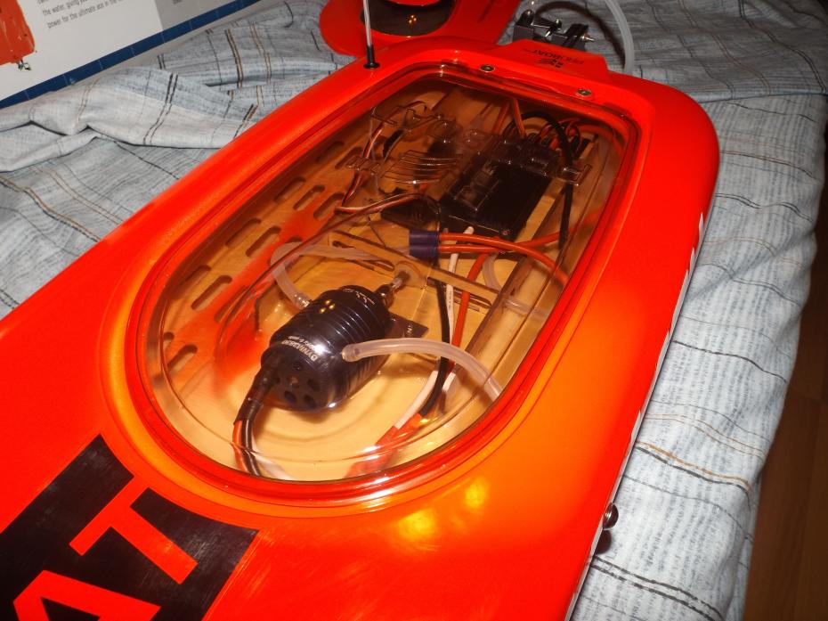

With the clear cover on.
With the cowling on.
IT TAKES GREAT INTELLIGENCE TO FAKE SUCH STUPIDITY! -

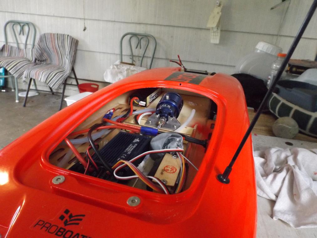

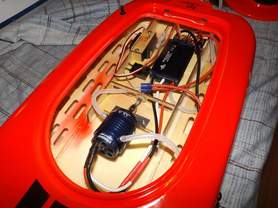

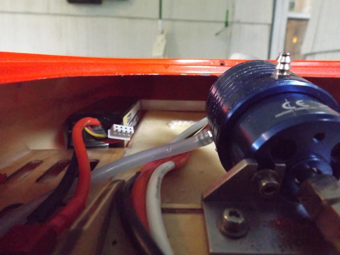

The exit for the water cooling nipple was in the way of the Battery storage. So I moved it back out of the way. I also trimmed some of the internal wood reinforcing, to make it easier the get the batterys in and out. It comes with a programing card for the ESC. Factory default is for the boat to run at 80%. Thats no good. Ill be reprograming that for sure after the first runs. Also you can increase the motor timing for more output as well. Ill let you know on Friday, how she ran.IT TAKES GREAT INTELLIGENCE TO FAKE SUCH STUPIDITY!Comment

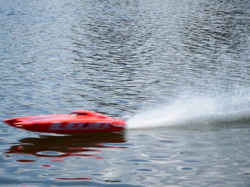

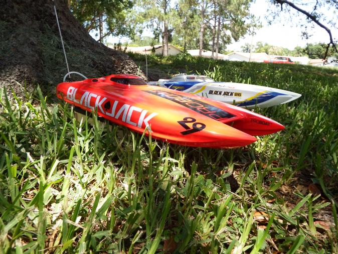

Sorry, no photographer was available yesterday as I hit the water. I was quite pleased however at the performance of this boat. The very first picture that I posted on this thread, way at the beginning, is exactly what I saw. I couldnt open it all the way up as it would have blew off the water. Ill be moving the batterys forward some more to get more weight forward, to help keep it on the water.
Using my new "no contact" temperature gauge, my motor temperature was in the low 120s. The batterys though were in the low 140s. Not good. They are 11.1 volt 25c lipos. They wont be able to handle repeated High drains. Ill relegate them to Submarine only duties. For the High drain stuff using dual Lipos, Ill need to get two more, at a higher c rating.IT TAKES GREAT INTELLIGENCE TO FAKE SUCH STUPIDITY!Comment
As far as future mods to this boat is concerned, I cant think of any. Right out of the box, after you program the ESC, with the included card, youve got just about the Max power that a 29" boat can take. With two 3s batterys in series , your running 6s power. Its going to be hard to keep it on the water. However, you can also cruise around with it and enjoy the scenery. Its ESC is not merely off and on like some boats. A good range of throttle..............Oh............by the way...............try hitting one of these with a Torp.............dude.IT TAKES GREAT INTELLIGENCE TO FAKE SUCH STUPIDITY!Comment

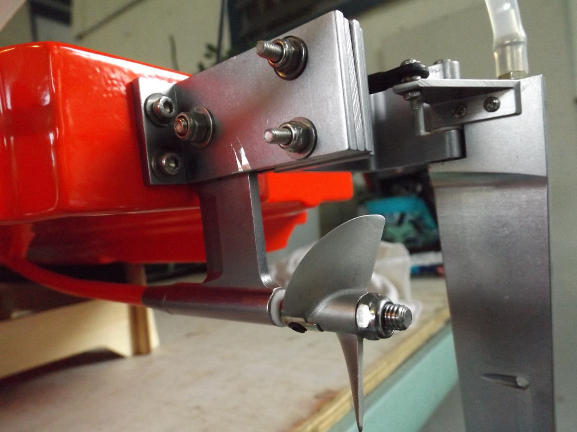

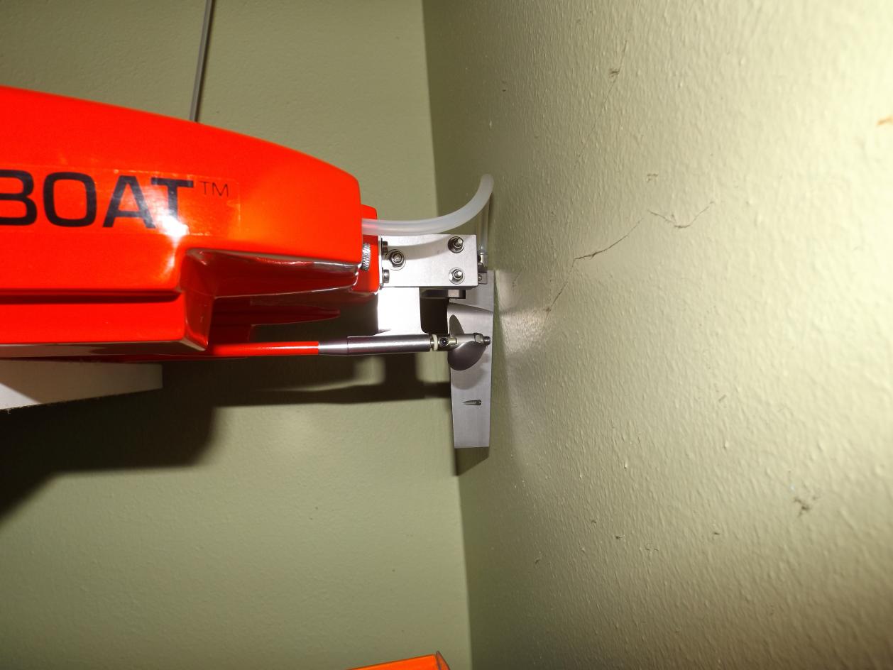

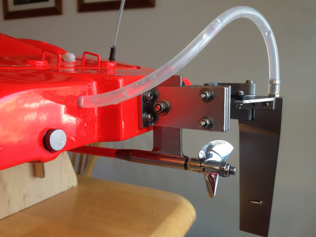

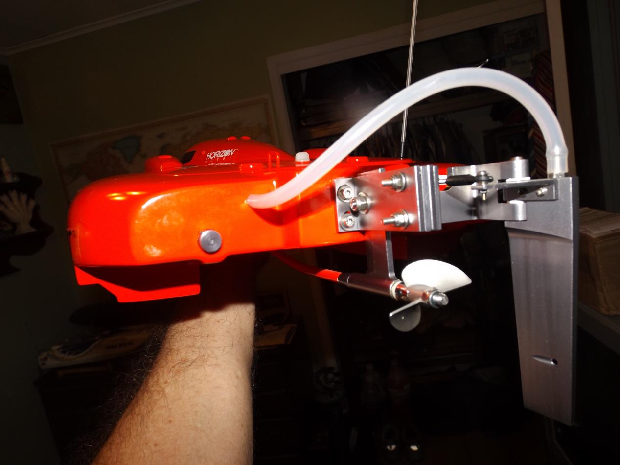

On to the water we went. I lowered the drive down as far as it would go to get the thrust of the prop to push the bow down....not up. Also experimented with battery position some as well. Heres what I came up with.IT TAKES GREAT INTELLIGENCE TO FAKE SUCH STUPIDITY!Comment

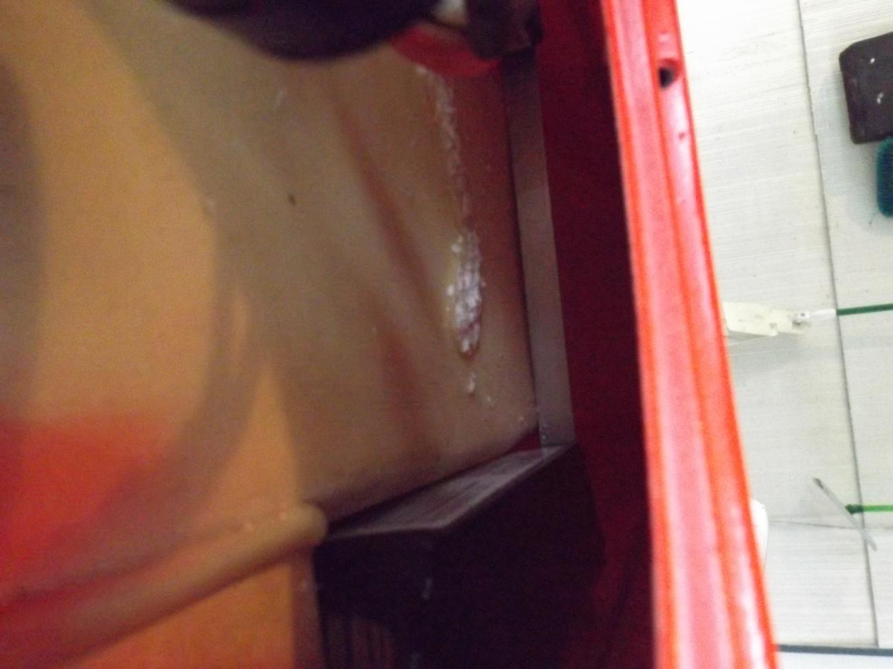

In these first two pictures, I tore out the cheap piece of white flotation foam that was in the way. Ill replace it with a nice piece of purple closed cell foam when I am done. If you look way up in there you will be able to see a piece of 1/2" aluminum angle. I silicon-ed that down to the deck to prevent the batterys from sliding forward. They sit right in a little cubby hole formed by the shape of the sponsons. We will try that and see how the boat rides.IT TAKES GREAT INTELLIGENCE TO FAKE SUCH STUPIDITY!Comment
OK......Back on the water, with photographer in tow. Re-positioning the batterys did help, but, Ill have to do more. Ive adjusted the strut angle as much as I can. Now Ill modify the stuffing box tube by cutting it down a little bit to enable me to go somewhat negative on the angle of the strut and prop. So for next time we will see the improvement. Videos to come. They take a long time to Upload.IT TAKES GREAT INTELLIGENCE TO FAKE SUCH STUPIDITY!Comment
