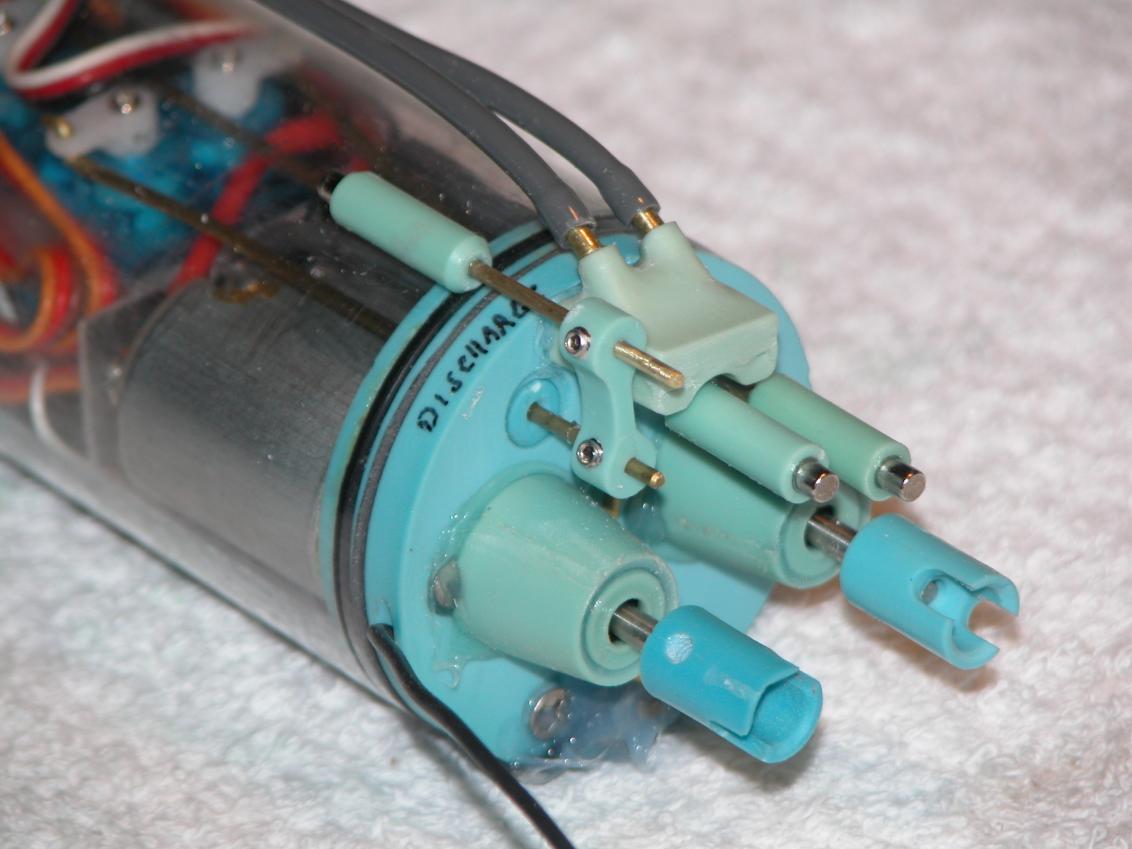

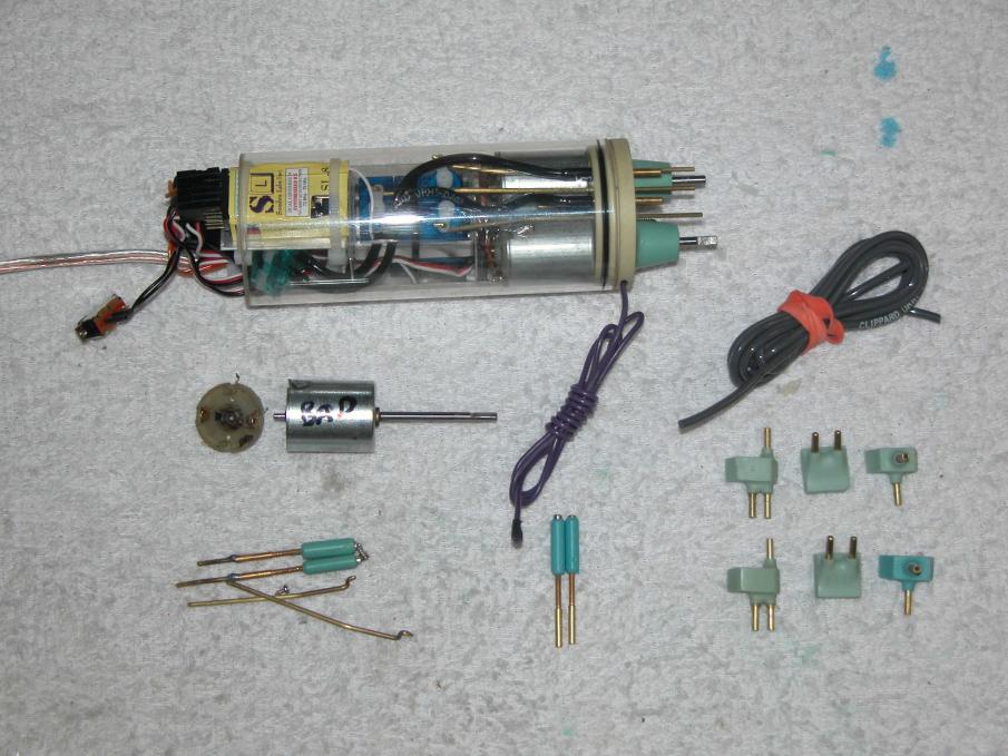

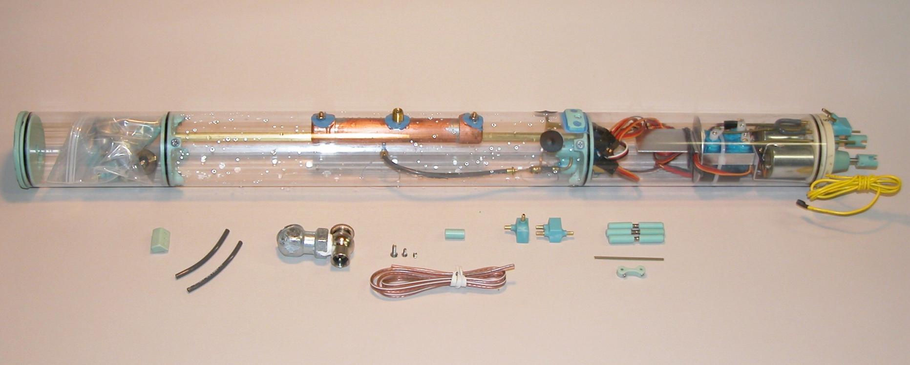

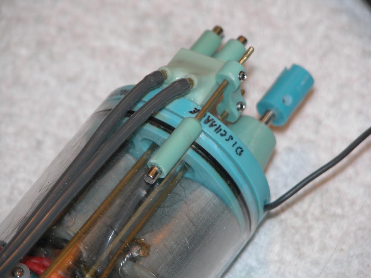

    You're likely talking about the LPB plumbing fixtures back there. How's this?
