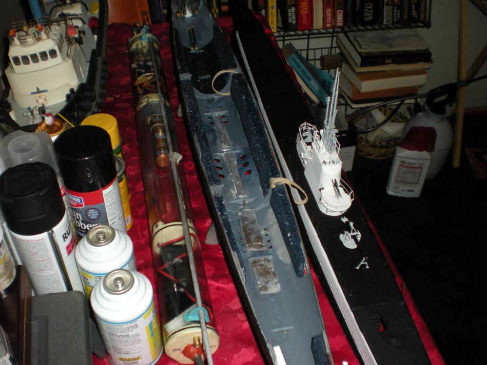

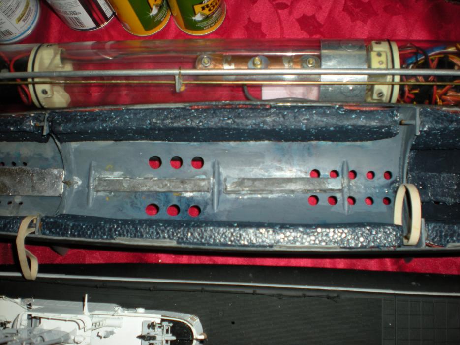

    Take the SubDriver out of the hull and show us the placement of foam within the hull and (if any there) the superstructure.
    • shamrock
      • Jan 2009
      • 69
      as ordered your magesty
      just the hull some foam painted blue
      horse power by the hour
      • shamrock
        • Jan 2009
        • 69
        no foam under deck just in hull

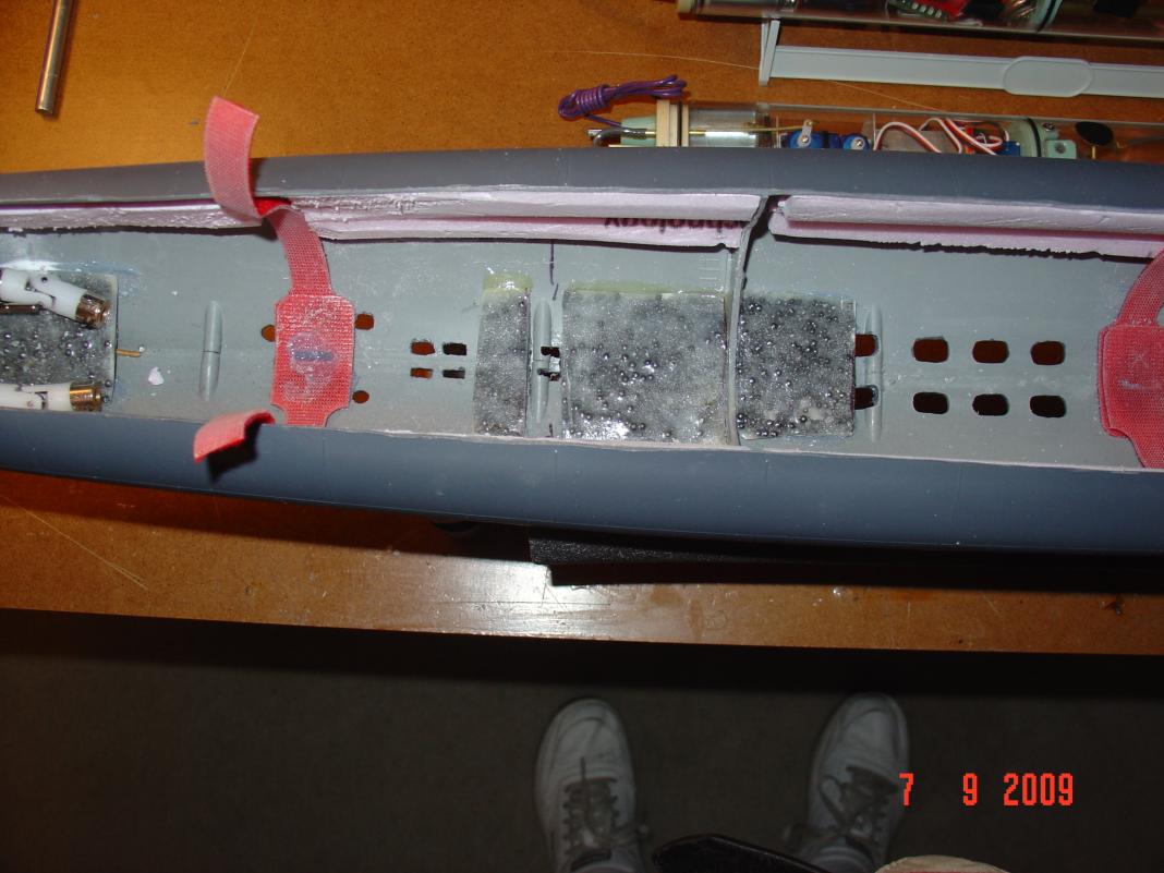

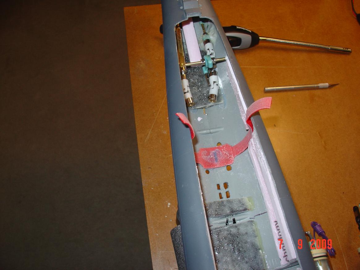

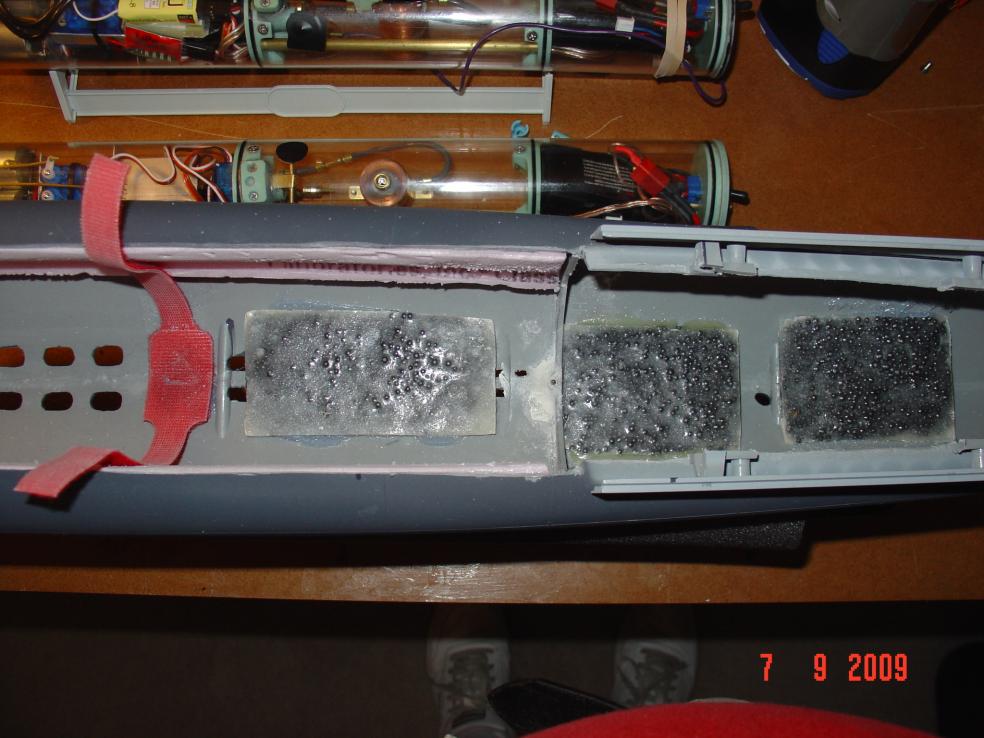

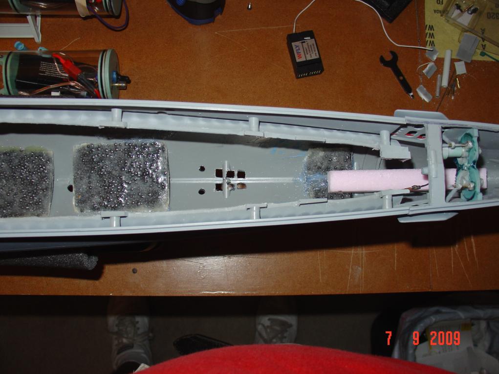

            It looks like I have allot more lead ballast than your boat. Remember when was complaining about the same thing. I added 9 onces of lead to the center of the boat to correct it. Look in my album about that complaint. See attached pictures. Good luck.
            My boat sits level in the water now.
            Jack

                Remember when I was complaining to you about my starboard list. See attached.
                9 onces of lead fixed it. Dead center in middle of hull.
                Jack

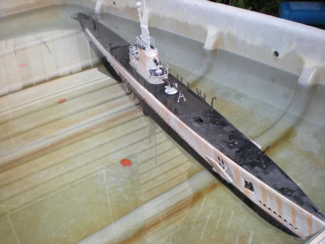

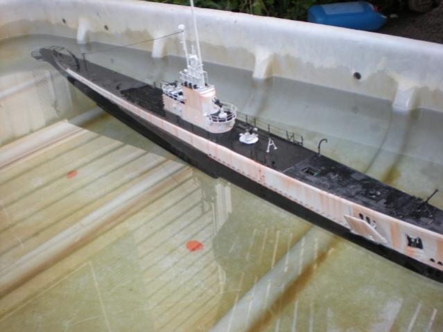

                    i added more weight to center of sub and a little more foam like david said to do .but this weekend rain would not let up so when it stoped for just a little bit i grabed test tank and draged it into house.bride is not to happy but sub is setting real good in water. need to find room for just a bit more foam.will post pics when done .thanks for help

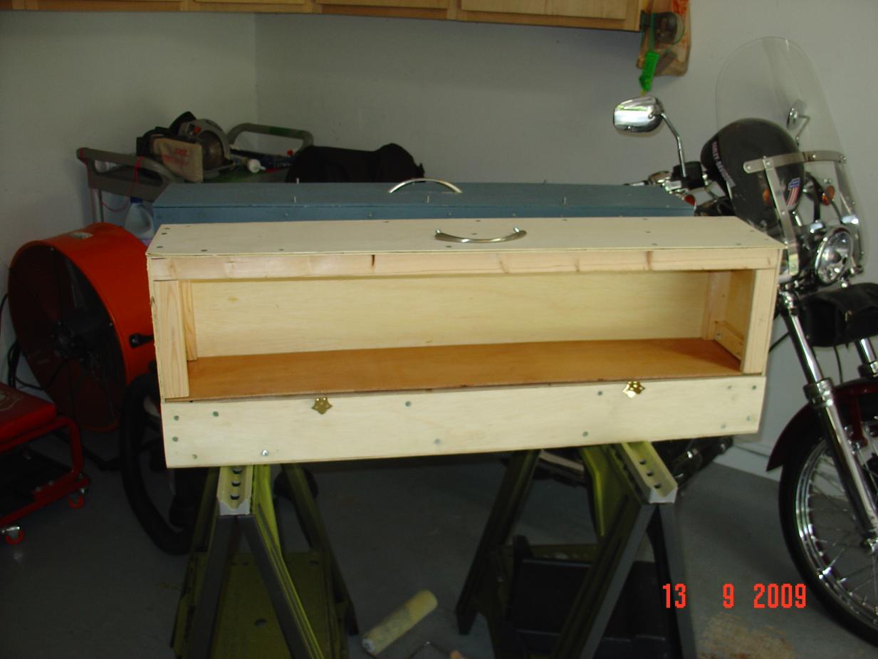

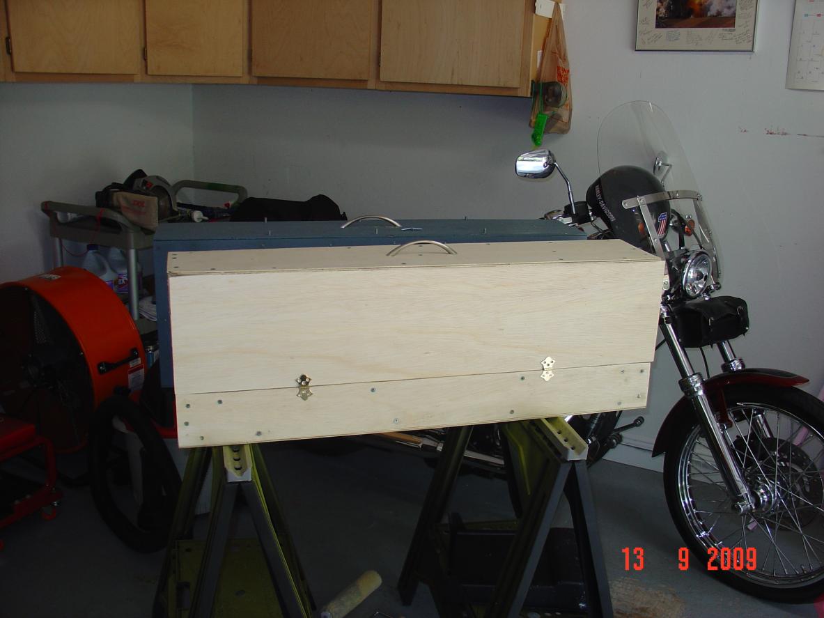

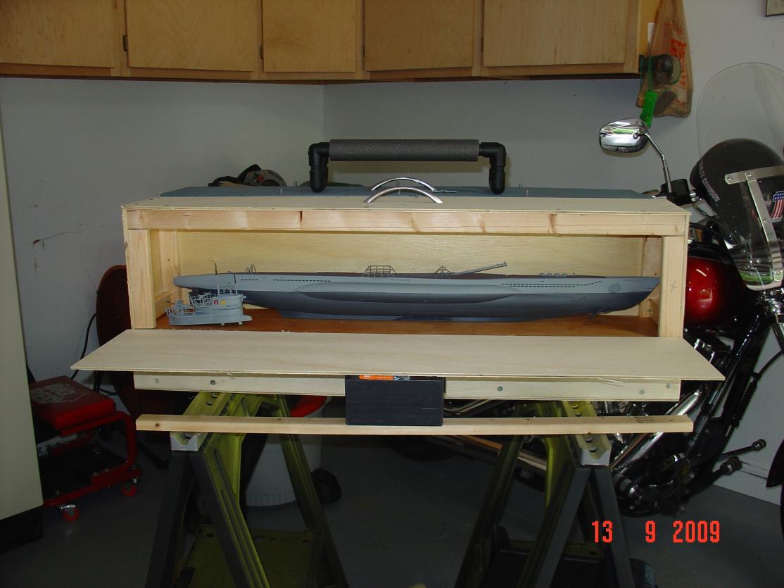

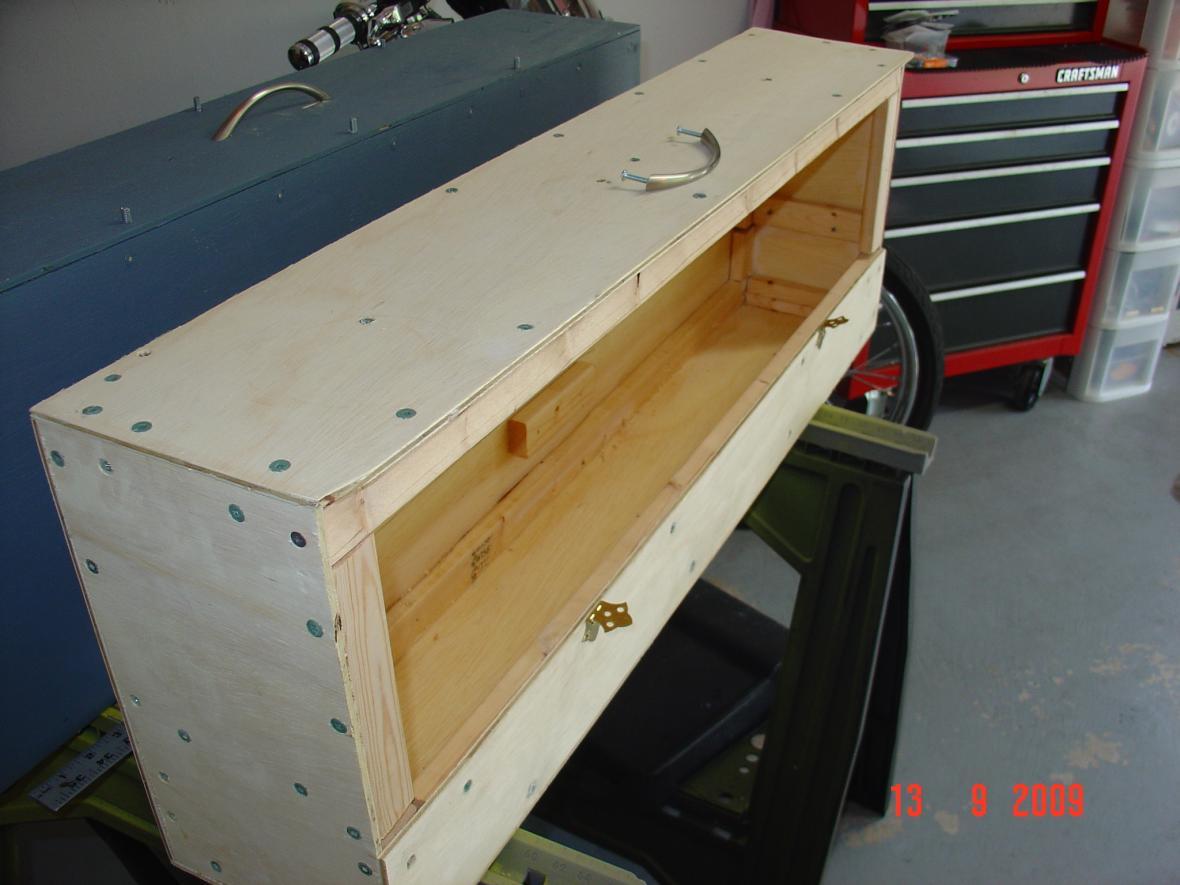

                      I started two more travel boxes for the type VII's. These have a place for tools and propel and stuff like that. One box drops the side. The boat slides out and the tools are under the slide. Then you can use the side as a place to do boat maintenance. The other has a tray that is carried above the boat. The tray lifts out and then the boat. Gave me something to do while mother nature floods us.

                          The boxes are still under construction but I did post some pictures. The box with the sliding drawer I like the best. I can get two boxes out of a 4'x8' sheet of plywood. Also two 8' 1'' 1/2 for framework. I should use smaller framing stock. The box not painted is the slider. There will be pink foam completely around the boat. All sides and it will be in a foam cradle. Two small handles for pulling the slider out. You can see the area under the sliding board that will hold tools and stuff. I have brass plated hinges and stop locks. I will post additional pictures when completed. I still have to add little feet for the side that drops down to hold it level. A latch lock at the top and paint. Maybe tomorrow.
                          I do put sealer inside the box because of water to seal it and keep it from warping. I having a senior moment, can't think of the stuff I use. Polly something. I hate being old.
                          Box will be Gray and have the 6 " U-295 in white on sides. Also the Caswell inc. and D & E Miniatures powered like the old' U-552 box in white (see U-552 (My first sub)Album).
                          Jack

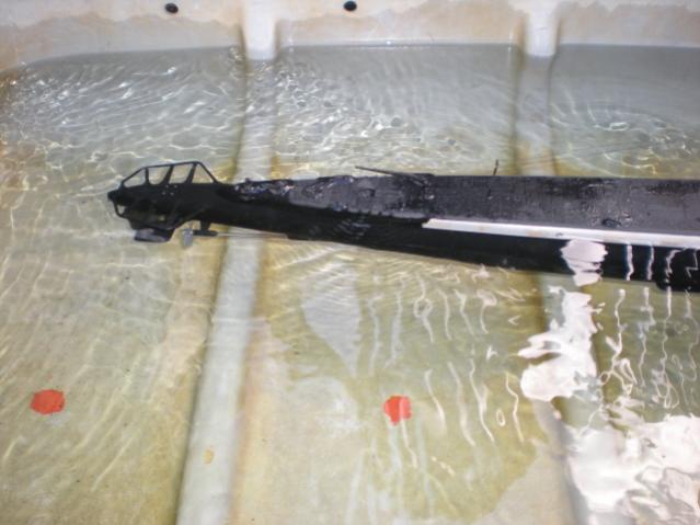

                          • shamrock
                            • Jan 2009
                            • 69

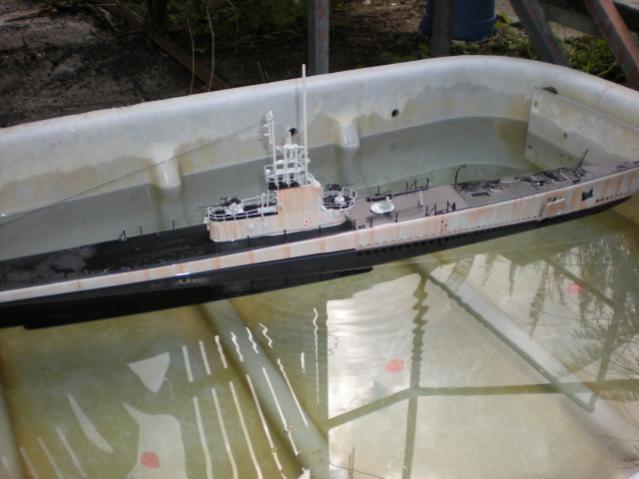

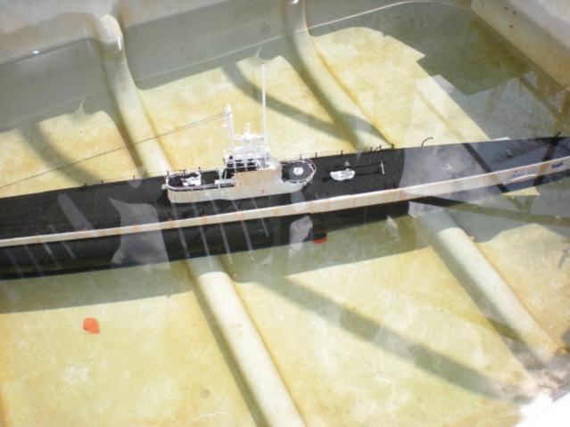

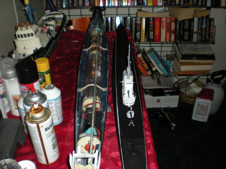

                            lean gone
                            as i promised pics of gato in test tank lean gone.still need a little more foam
