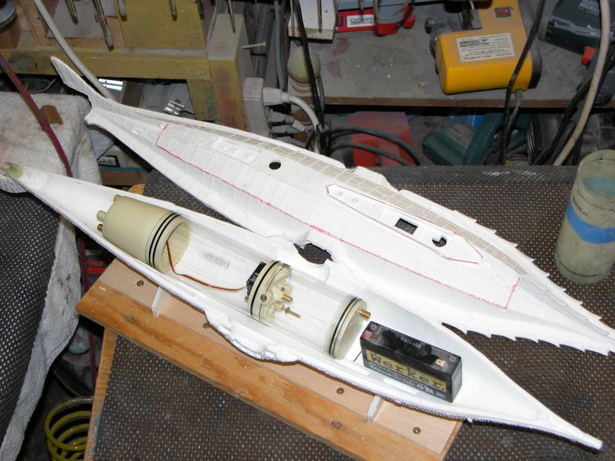

    Ahoy Merriman,
    What size snort system would you recommend to use with your WTC designated for the Revell 1/72 Gato? While I'm at the question table,, I am planning to attempt to RC one of Lee's 31" Nautilus resin kits. I plan to employ the tilt a world ball socket vectoring propulsion system you have designed and is documented in the Totalimmersion posting. In the article you mention the WTC as a modifiyed Kilo WTC. Could you shed a little more light on the WTC mod's or are there Nautilus designated WTC's available?

    The smaller LPB will work just fine in your GATO.
    As to the right SD to use in the little TI Disney NAUTILUS: Our initial design for the 1/144 Trumpeter KILO and SEAWOLF was a 2.5" unit and suitable for use in the TI NAUTILUS. We discontinued that product, but until recently they remained in stock at Caswell. The re-designed KILO and SEAWOLF SD is 2" and too long to be of service in the TI NAUTILUS.
    However, as it has come to my attention that the original SD was useful for use in the TI NAUTILUS, Caswell and I have put that assembly-line back in commission and have re-introduced that SD for specific use in the TI NAUTILUS.
    All this to tell you that, yes, the TI NAUTILUS SD will soon be available From Caswell Inc.
