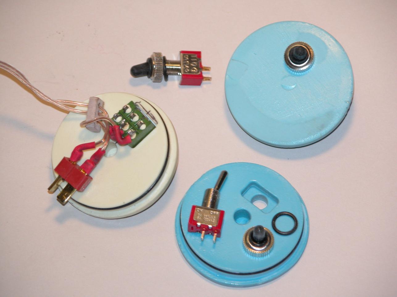

      Mission switch
      Plastic66, thanks for asking the question. I was wondering the same thing but felt that if I just let it alone it would be cool.
      Dave, what kind of mission switch are you showing here. It's lots smaller than mine. I was about to install a switch in my type VII S/D today. I was also not happy with the size of my switch. Mine is to big but I my one stop light town it's the best I could do. If I could get a brand name and # I could go internet hunting and maybe get lucky.
      Jack
        • 13988
        Jack
        Mr. Caswell and I are still trying to acquire a source for a mini-toggle switch and watertight boot to fit. The best we've come up with is a switch and a boot, but they don't fit.
        Anyway, you're looking for a mini-switch with a neck threaded for a 4-40 nut and the boot with a base to fit that thread.
        A specialty electronics supply house is the best we can do so far.
        You'll have to shop the INTERNET till we can get them in stock for you. The switch must be able to handle 10 Amperes @ 240 Volts, minimum.

          David:
          I found a electrons company that has micro toggles. I've ordered some 5 amperes switches and boots. They didn't have 10amp in micro's. Guess I'll be disappointed when I try them. That's why I order extra switches. It's a BRITISH company. I'll let you know how they work out. The company is as follows.
          Digi-Key Corporation
          701 Brooks Avenue South, Thief River Falls, MN 56701 USA
          Phone: 1-800-344-4539 or 218-681-6674 or Fax: 218-681-3380
          Digi-Key.com
          I'll keep shoping for 10 amp.
          jack

            You should be good with the 5 Ampere rating.
