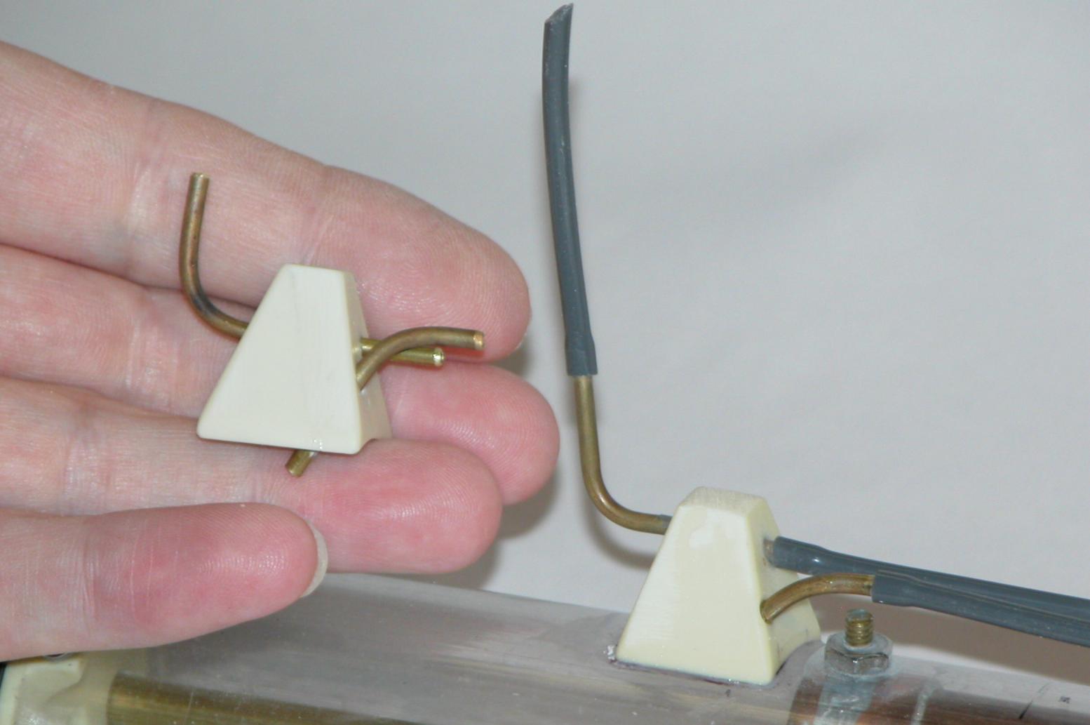

    Closely studying my type VII S/D I'm stuck. I see the two brass tubes in the motor end (business in) of the S/D. I'll assume that one is for collecting air from top side of the sub. Hopefully through a snorkel. The other tube is for sending air to the ballast tank. Where do I plug in air from the pump (back of the S/D) to fill the ballast tank with air? I don't see a fitting. I saw David Merriman hold a fitting in his cabal reports for a seaview I think. I'm thinking that maybe I need another Caswell fitting for the S/D that goes on the ballast tank part of the S/D? I could not find one offered. Or do I make my own with my limited skills in making stuff.
    A picture if possible, anybody.

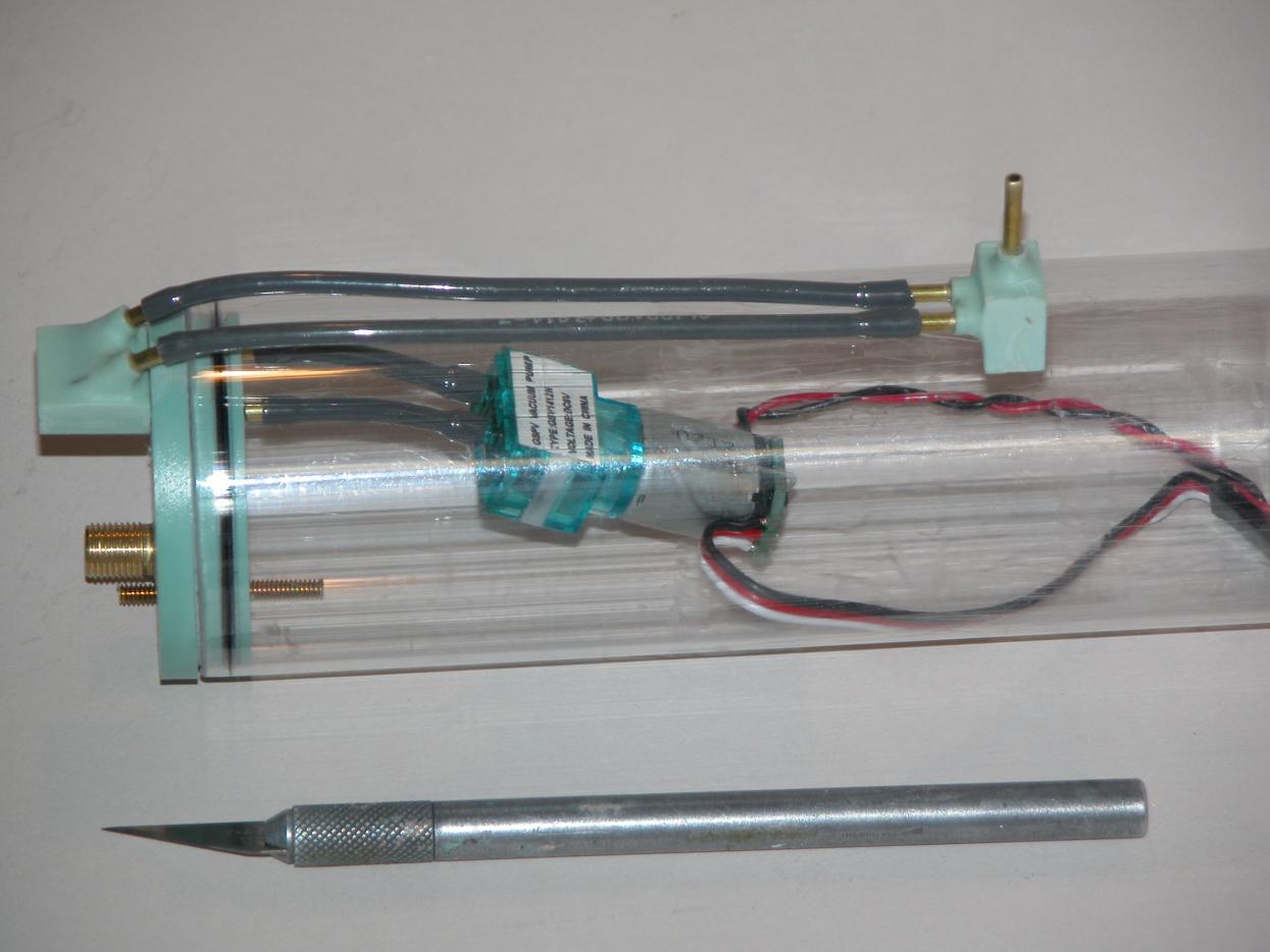

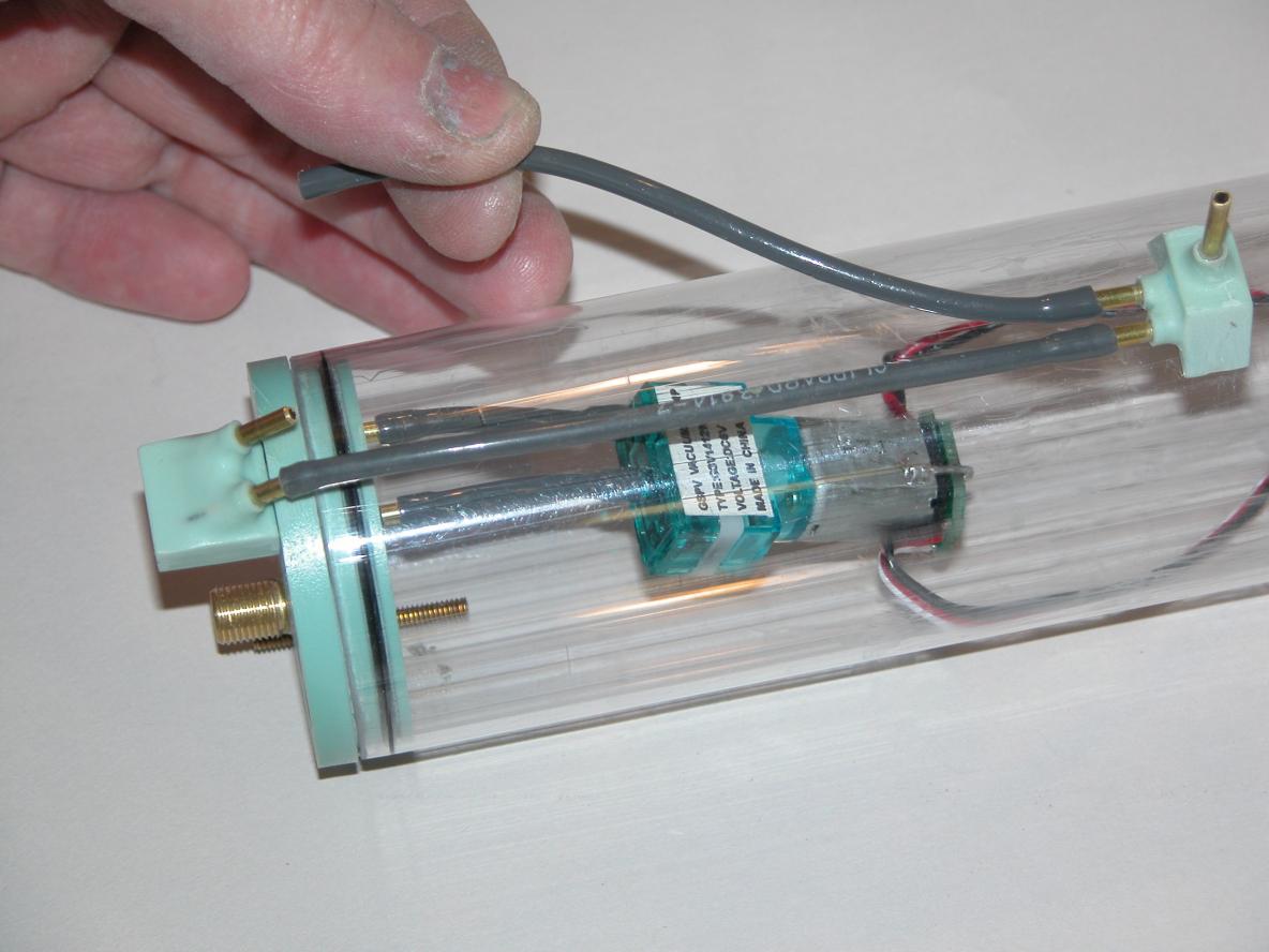

    You can make your own discharge-to-ballast-tank fitting from a hunk of plastic, just drill half-way two 3/32" holes, 90-degrees apart, one hole is glued over another hole atop the ballast tank, the other hole (parallel to the cylinder) gets a 3/32" o.d. brass tube 'nipple' which makes up to the discharge side of the LPB.
    You can make the discharge fitting a stand-alone item or you can combine it with the 'L' shaped nipple (serving as a foundation) that runs the induction hose from up into the sail, to aft to the motor bulkhead.
    Get creative.
    This ain't rocket-science you know!

      That's what I needed. Picture. I saw that once before but could not find it again.
      I don't see why Quikwood wouldn't work to make a fitting to hold the brass tubes.
      Jack
