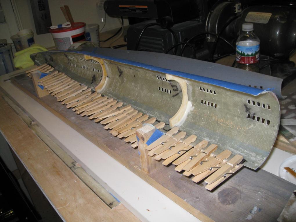

    My local TAP Plastics store sells 1" wide FG tape. I laid out on wax paper strips long enough for the tabs and epoxied the tapes. When they had cured I set them in place with clothes pins, CA'd them, then brushed on epoxy when after removing the pins. Hope this helps.
