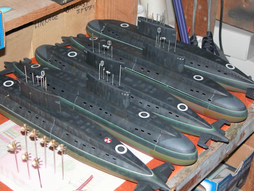

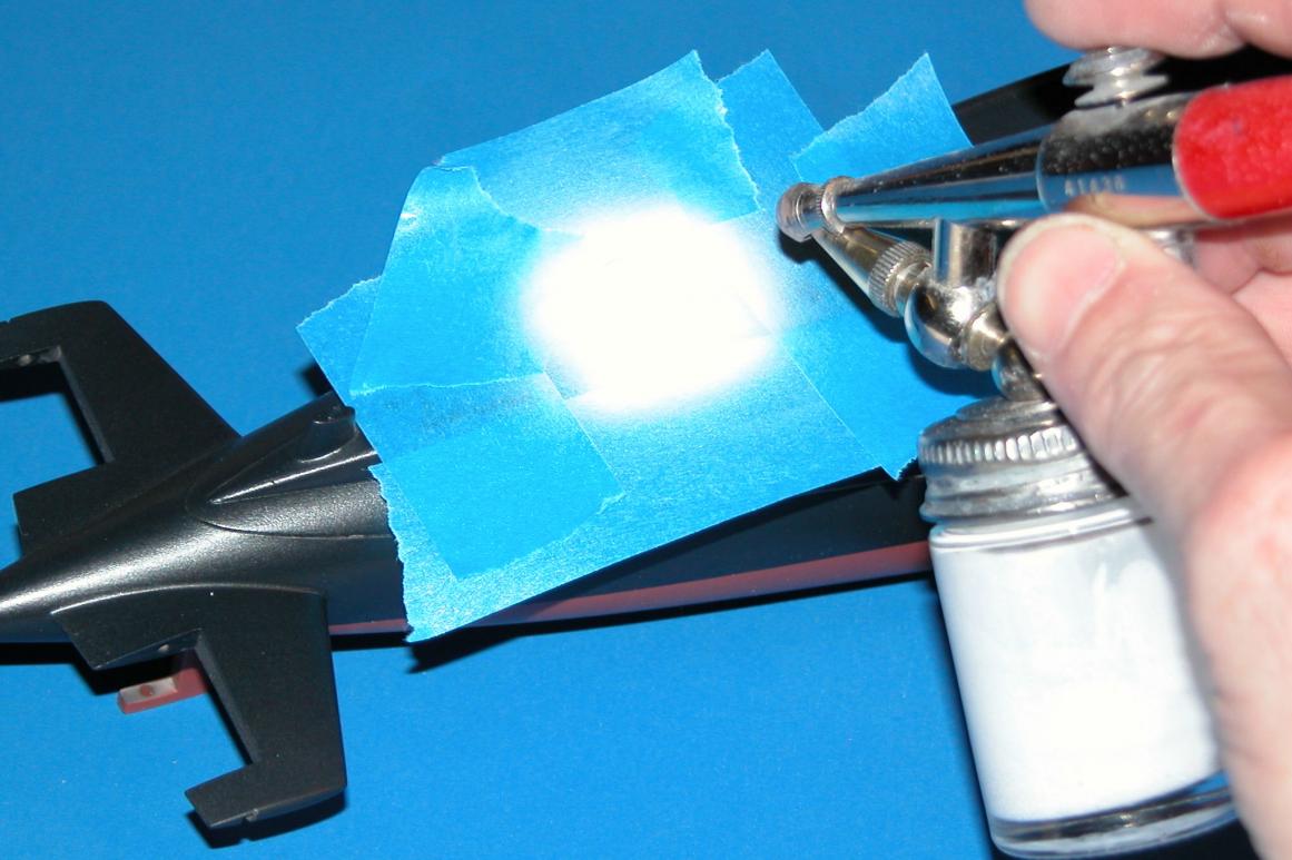

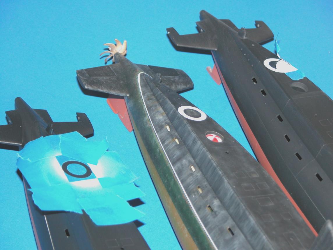

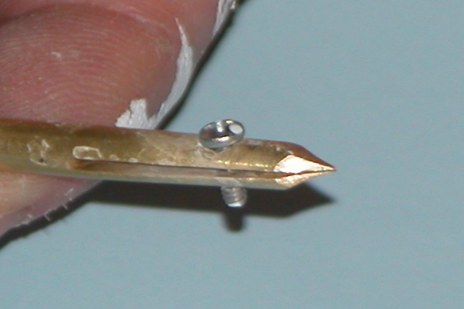

    1. A circular mask can be cut using a commercially available circle cutter -- a swival-knife at one leg of a fancy compass; using a cheap-ass kids school compass with one legs point ground to a knife blade; or using suitably sized brass tubes bevelled to serve as hole-punches.

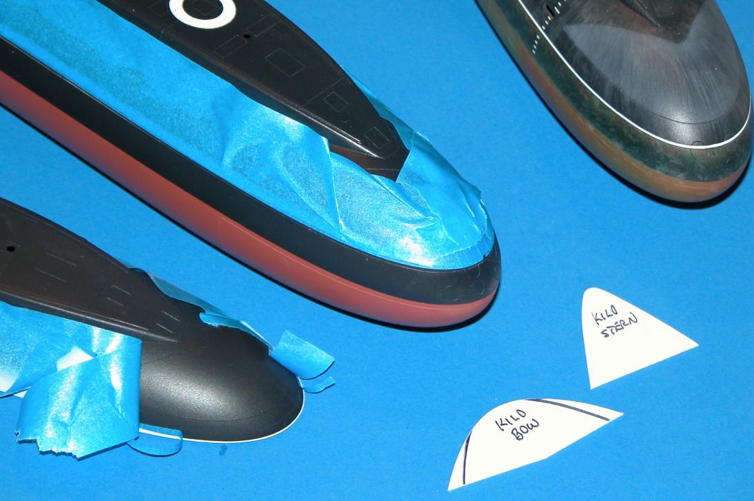

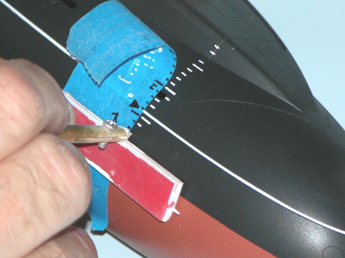

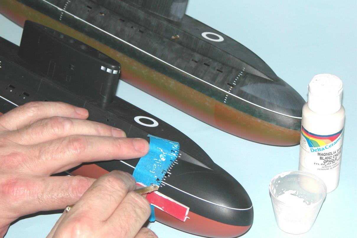

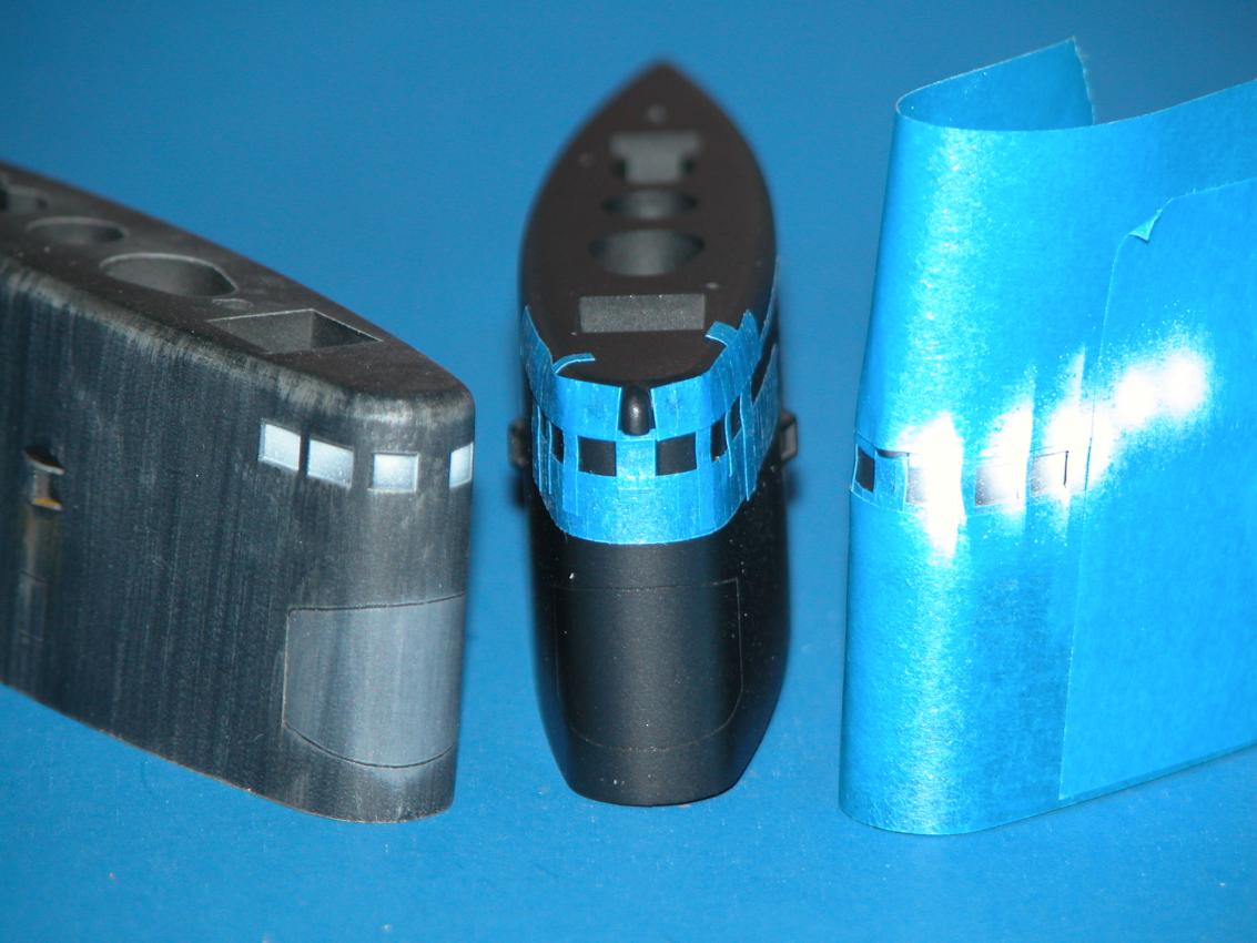

    Note the varied use of the low-tack masking tape: straight runs like the black-red demarcation lines on the hull; used as a position template for the bow-pen applied draft markings; and the circular masks on the after escape-trunk targets.
    2. Not all blue masking tape has the same tack! I use the 3M stuff. Regardless, don't employ the edge of the tape as it comes off the roll -- too ragged! First place a strip of the tape down on some plastic sheet and cut your strips, circles, whatever on the board. This produces a very clean, crisp edge that will prevent paint run-under and ratty looking paint demarcation lines.
