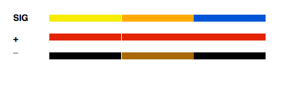

        I'll make no excuses for all the different systems out there, but this should help understand what each of them is:
        Yel/Red/Blk - sig, +, -
        Org/Red/Brn - sig, +, -
        Blu/Red/Blk - sig, +, -
        I had a nice table of this posted someplace but the search function won't help me find it!
          Will this help?
          You can see the different lines, and how they match with any of the others.

            Thanks for the information. Very helpful.
