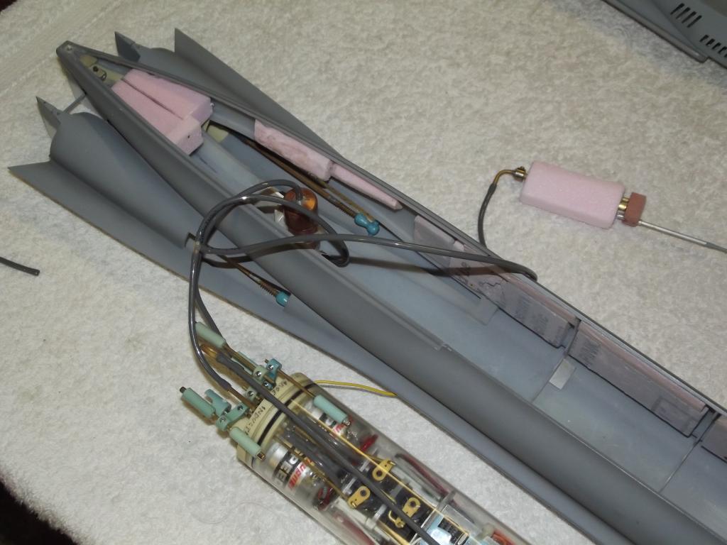

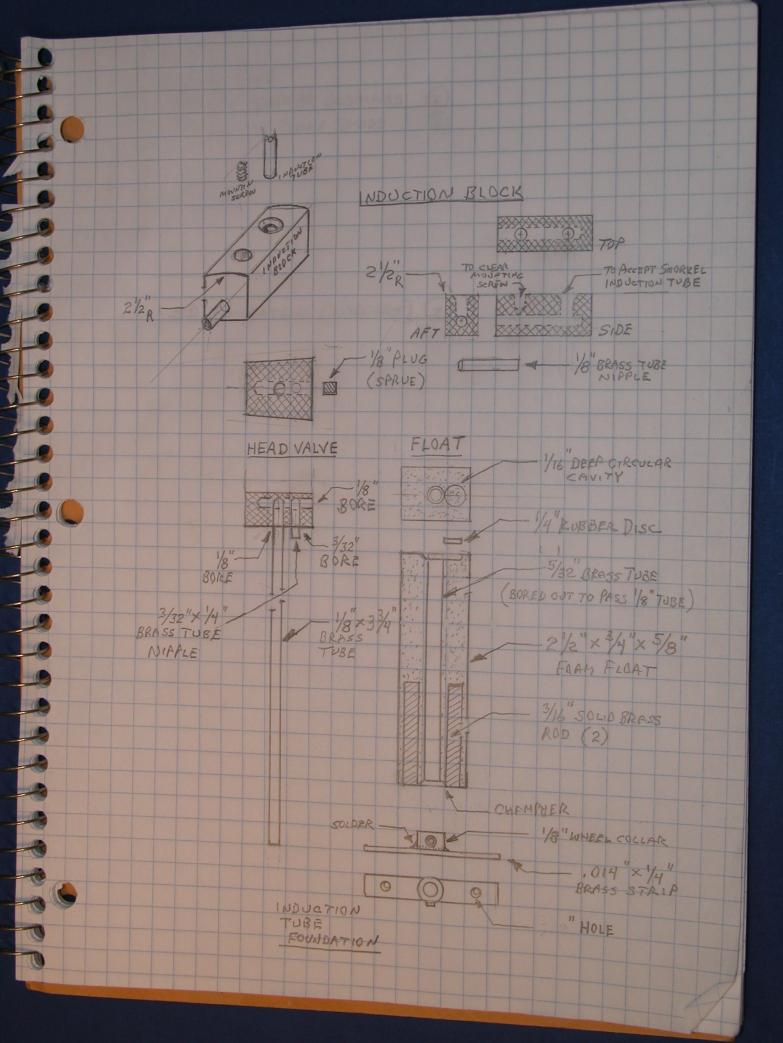

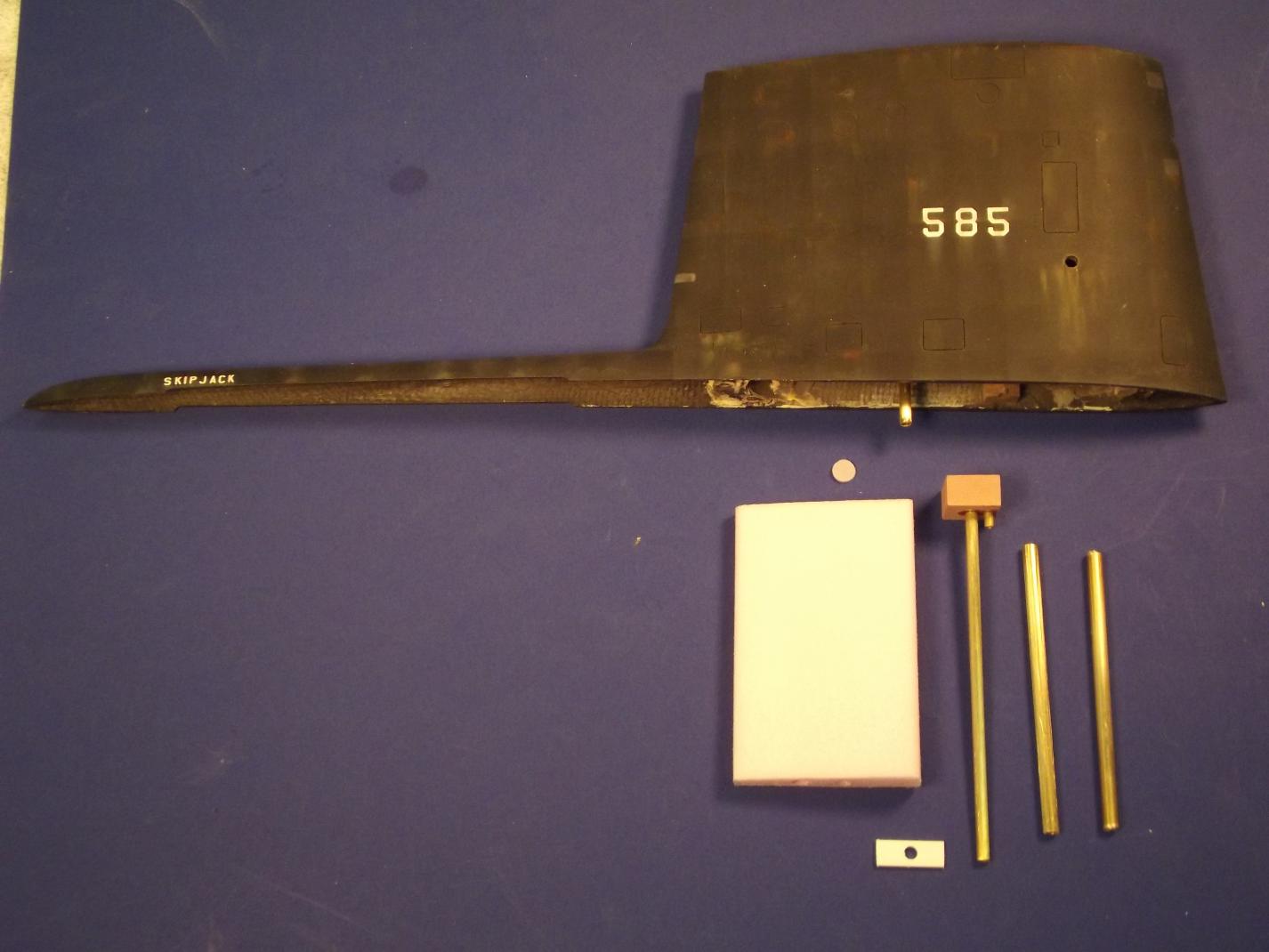

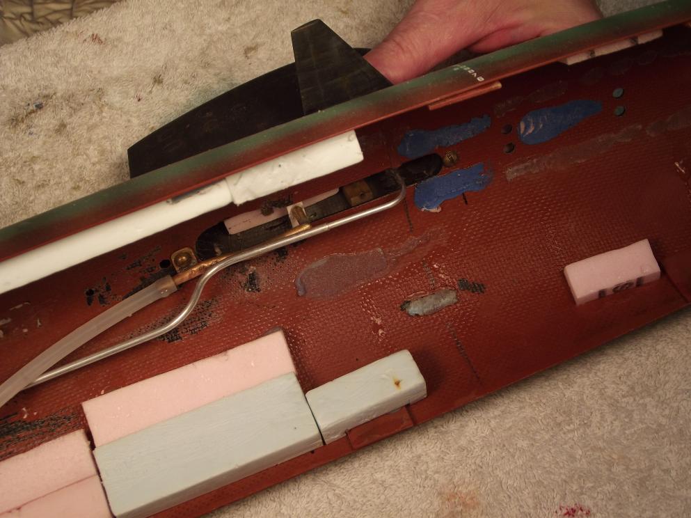

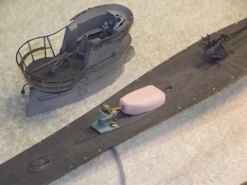

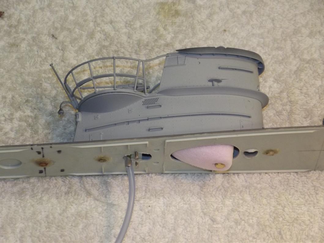

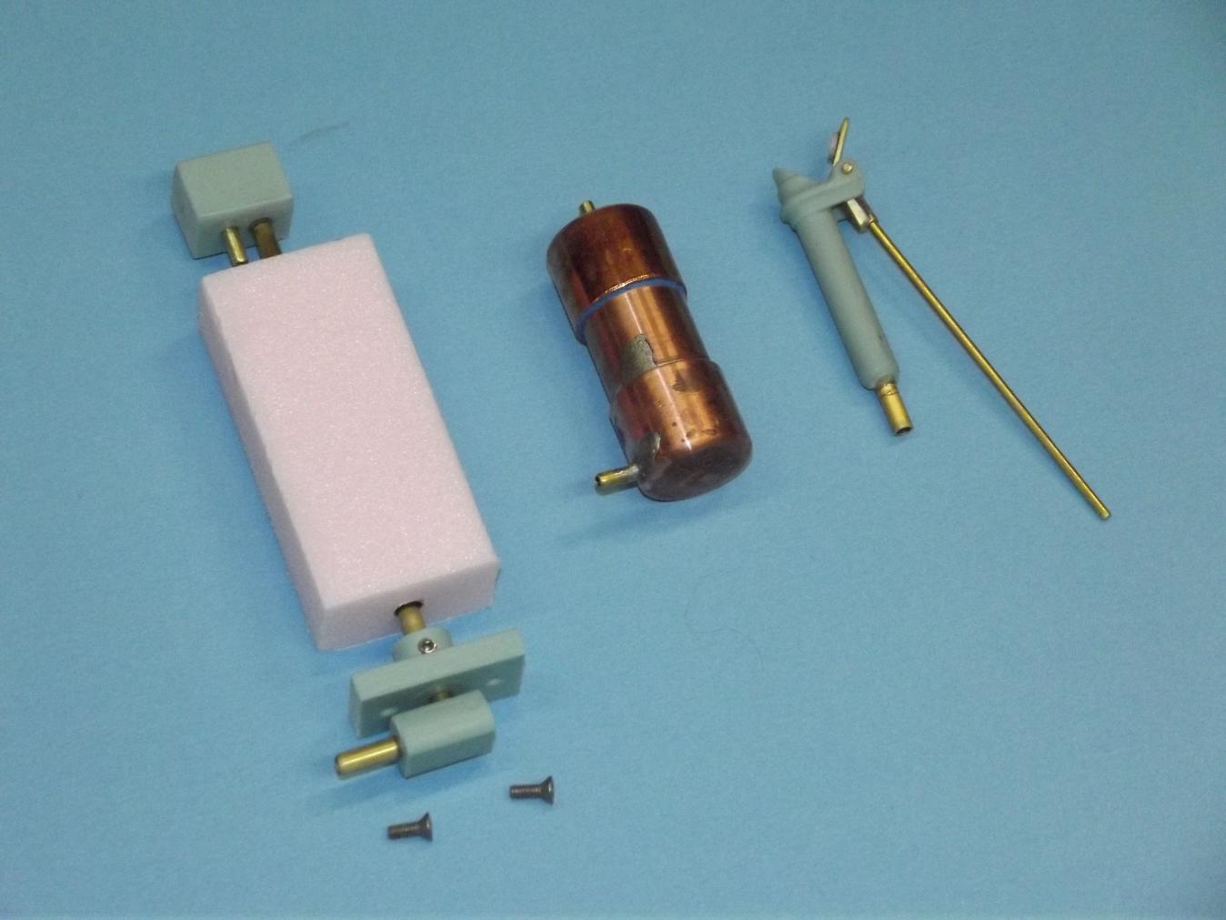

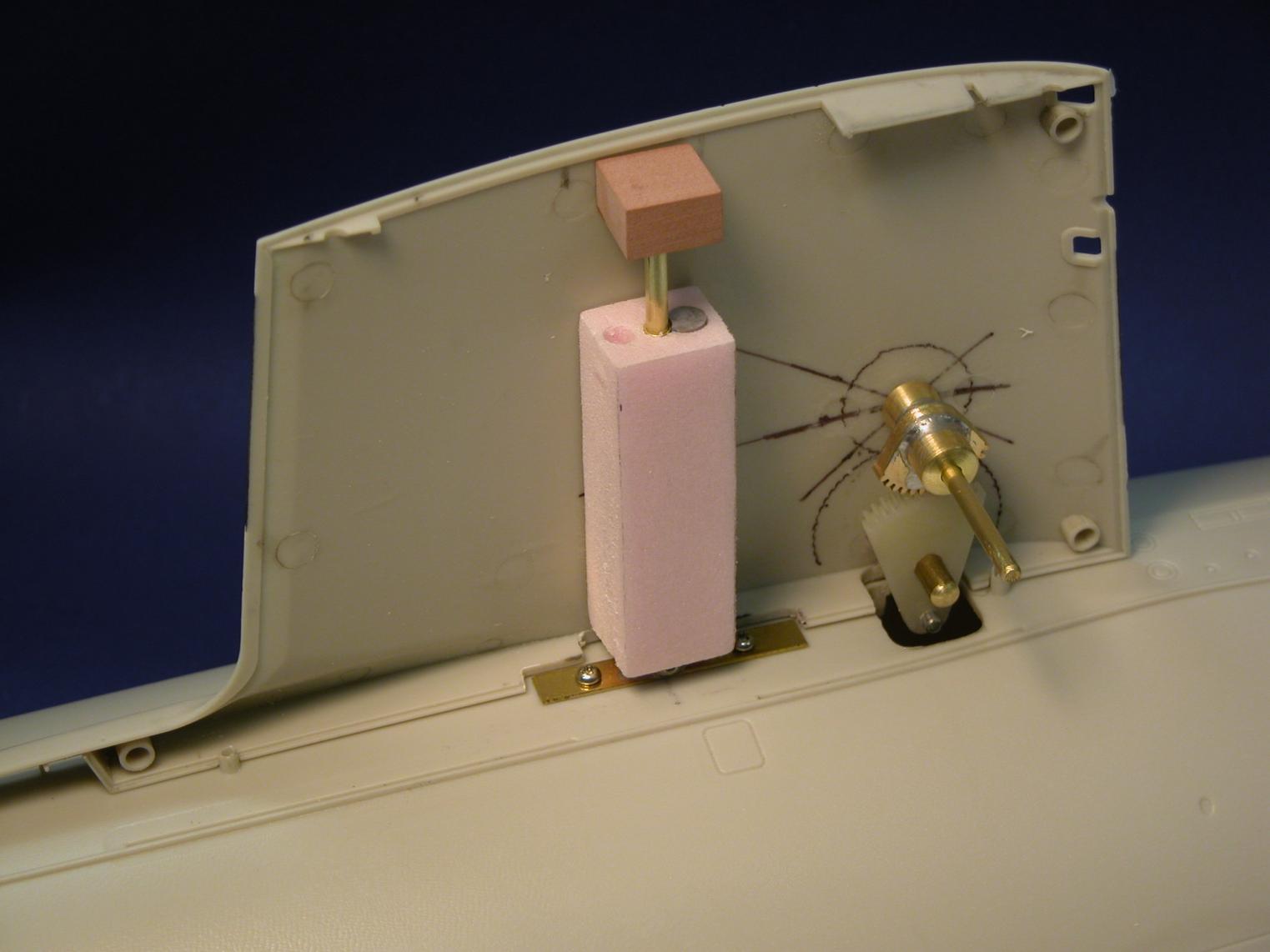

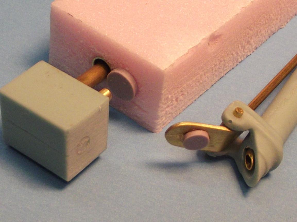

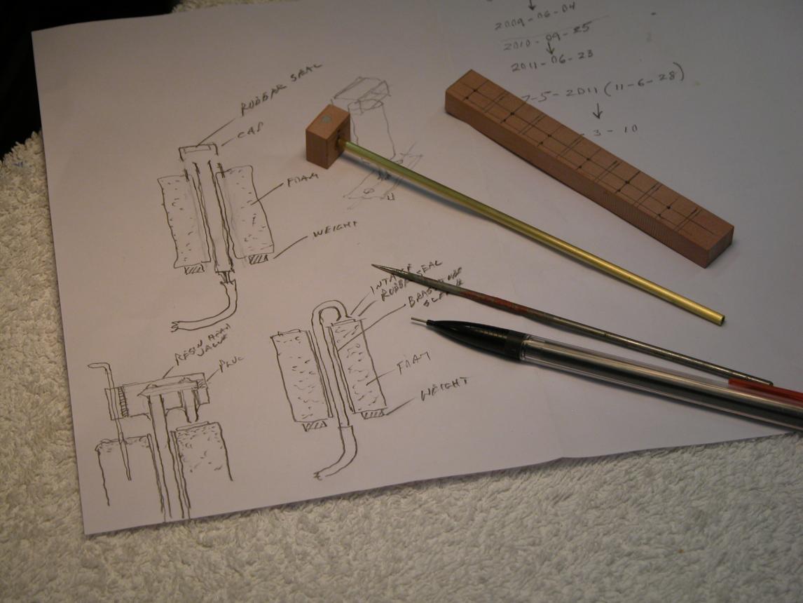

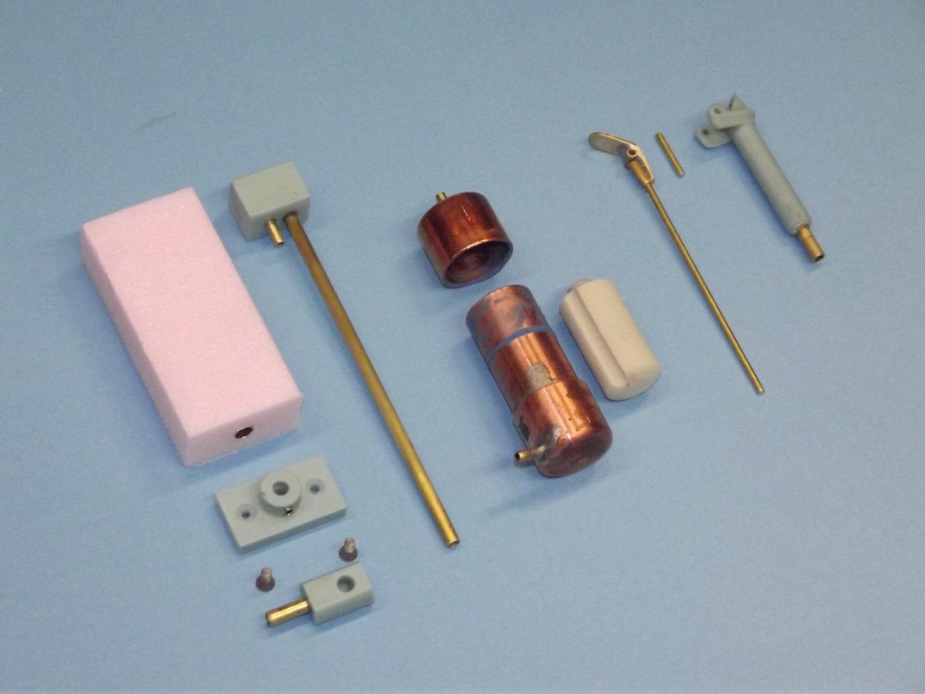

    Are we talking GATO SD here, Joel?
    For any given SD that originally used the classic snort-gas ballast sub-system, when configured for SAS (which ALL SD's are now with the exception of the 1.25" SD's) the ballast tank volume remaines about the same (loss the on-board bottle, but -- other than the 3.5's -- gained a safety float-valve, so volume change of the ballast tank on the 2.5 and 2 SD's is a wash).
    The only displacement change between the SAS and non-SAS ballast sub-system is the float of the snorkel of the SAS -- usually removal of existing foam from the above waterline portions of the hull, to an equal volume of the float, will compensate. Yes, the ballast tank volume between the two sub-systems is the same.
    Addition of the gas ballast sub-system to the SAS (or to the snort) is an easy matter, as the mounting hardware foundation, and linkage arrangement is shared with the SAS -- just plug in the on-board gas bottle, with connected hose, restrictor, and blow, valve and the conversion is complete. All you have to do is adjust the fail-safe to overdrive the vent/blow servo to 'blow' in the fail-safe condition.
    Snort does not employ a snorkel head-valve assembly, The SAS does. Is that what you meant, conversion of a snort to SAS?
    We'll get this sorted out, Joel.
