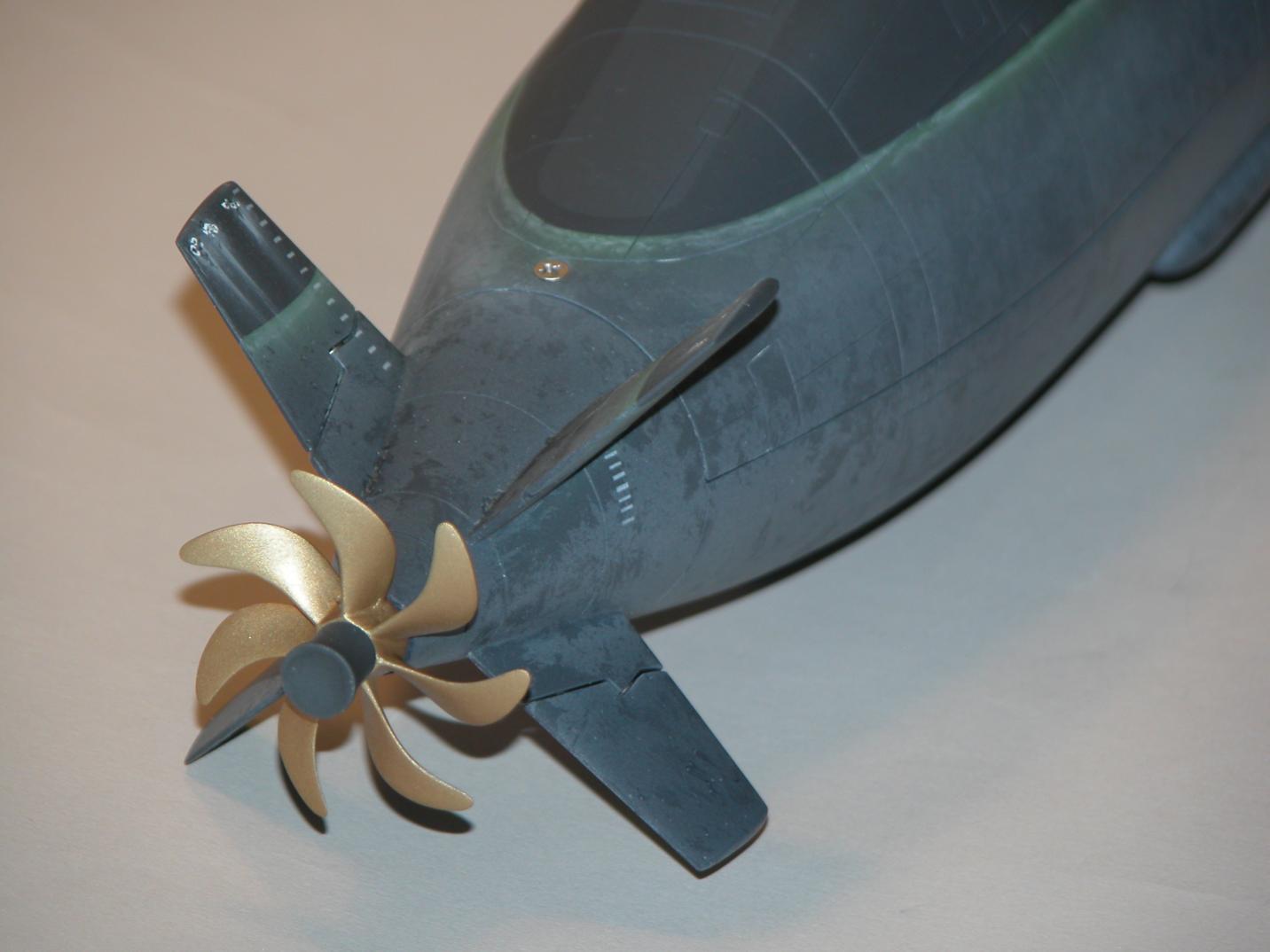

    Below waterline, it represents 'rubbed off' portions of the hull where layers of marine growth peel off throgh flow or pier/cammel action

      I saw the results a few days ago when you painted a Type 212. I just now thought to save those pictures for further study but I can't find them in the forum today. They came up the other day when I checked for new activity. Do you have a link that you could share?

              This them?
