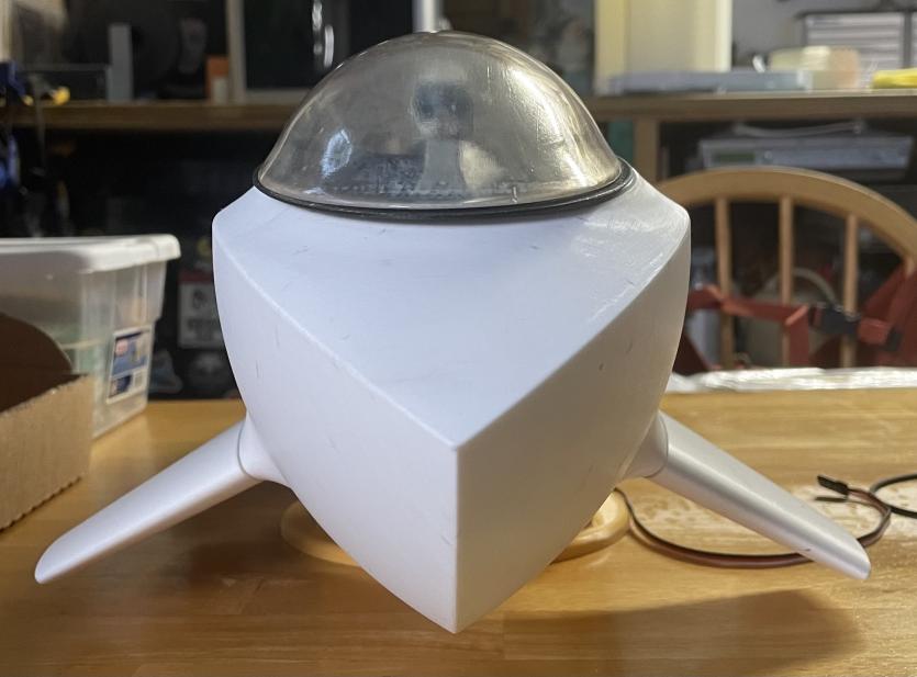

    Basically trying to make something that looks like a jet fighter canopy. have tried 3D resin printing in clear resin, sand, clear paint with mixed results on clarity. I also used a headlight restoration kit to get a clearer results but afterwards have had issue with the print warping and yellowing . So now i'm thinking of either vacuum forming one and wondering how well it will bond to a base and hold up or the alternative would be to make a silicone mold and cast one in clear resin. Anyone have useful shortcuts or Do NOT do that to save me some tine and aggravation? Please and thank you...
ID:	195692 Click image for larger version
ID:	195693 Click image for larger version
    before and after sanding, clear painting resin printed canopy eventually warped and de-bonded headlight kit yellowed a bit over time

      Thanks ! Now i have more questions... Using a polycarbonate what thickness do you recommend as there seem to be options? In some of the photos the vaccum formed pieces look frosted (before pic?)??? is that what you use the Meguires for or is that for polishing the plug - in my case will most likely use a 3D printed piece as the plug? What are you using to bond the vaccum formed pieces to the model, How robust is it? the examples shown seem to be static models - how well will this hold up in and under the water?

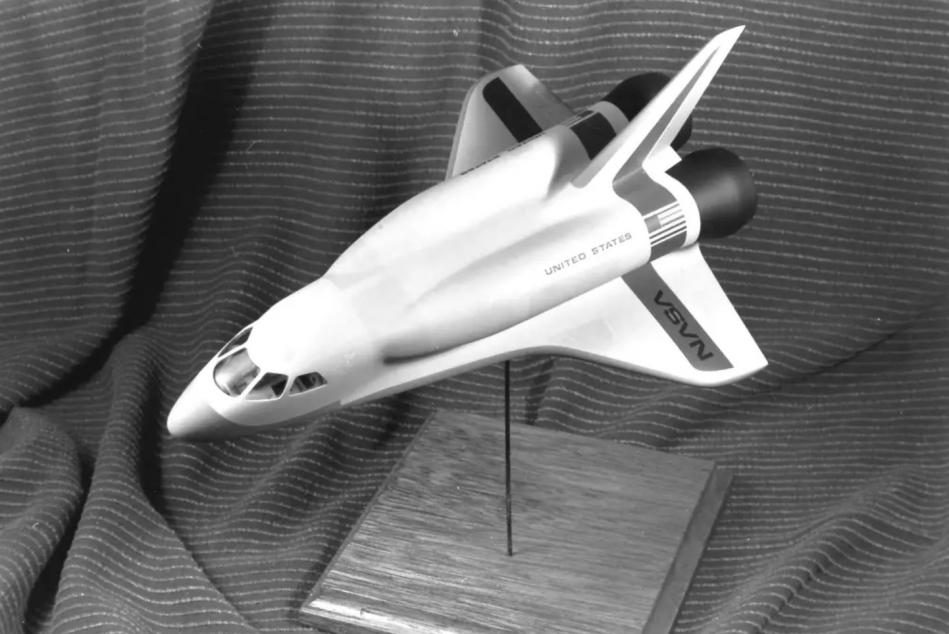

        [QUOTE=He Who Shall Not Be Named;n195695]
        Intrigued by your Space Shuttle like model. Is this a model for film / tv or one of the late 1960's / early 1970's Space Shuttle concept studies?

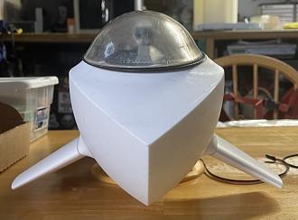

          I used clear Vivak plate 1 mm for the spirou, heated it up inside a standard home oven at 200 degrees, when you see the Vivak droop inside it's frame for a good amount got it on the vacuummachine and drew the air out around the cockpit mold.
          For now it's staying clear, you can glue that stuff with 2K epoxy.

            Looks like the shuttle from Buck Rogers TV show
              • 14010
              Yup. A heavily re-worked plastic model kit of the American Shuttle. I goofed: failed to represent the faceted surfaces that housed the clear parts -- I made it as a compound curved 'cockpit canopy'. Wrong! At the time I only had some sketchy photos out of Starlog magazine to go on.

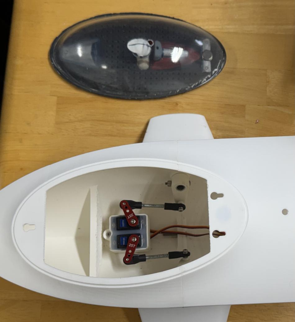

                  Thanks for the full response, couple more questions / comments. Butyrate or Polystyrene aren't something i see readily of Amazon, more of plastic supply houses. Any particular reason for using it over Polycarbonate?
                  Was thinking of trying Polyurethane Gorilla glue to secure, have had good luck with it in the past (pulled rubber off glue roller ??? so yeah it sticks well )
                  i was thinking of making mor of a edge vs shelf it sits on to bond to for a better bond line.
                  My cockpit is an access panel, have it vented with lots of holes and the canopy will have a bleed hole at the apex allowing it to flood and vent
                  FYI the cockpit attaches via 3 screws in keyways and is latched in place with a magnet on the canopy and in the body.
                      Yes, now I recognise it as the Buck Rogers "Ranger 3" Shuttle. Interestingly a couple of the early design concepts for the Space Shuttle done by industry in the 1970/71 timeframe are similar to this model with large conformal fuel tanks (either internal or external) connecting to the engines

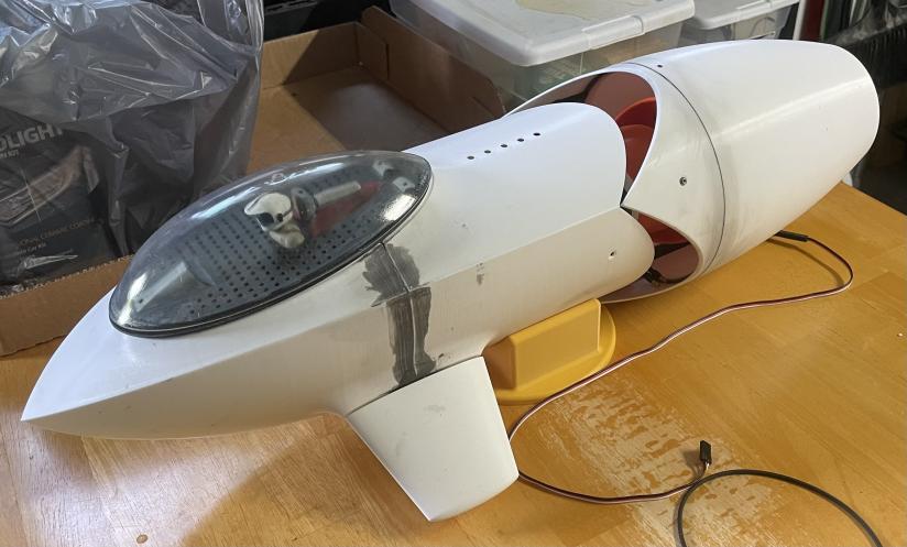

                        I fell into a rabbit hole looking at materials - google turned to AI and eventually gave me setting for printing a plug:
                        • The Canopy Material: 0.030-inch PETG, heated to a 1-inch sag in your foil-lined insulation box and pulled over your ABS-GF plug.
                        • The Slicer Profile: Printed right-side up at 0.12mm layer height with 5 wall loops, 50% Gyroid infill, and 1mm vacuum transition holes modeled into the baseline.
                        • The Post-Processing: Sand the plug up to 1000-grit and clear-coat it glass-smooth before thermoforming to ensure perfect canopy optical clarity.
                        • The Assembly & Bond: Skip the dichtol on the cockpit. Sand both the ABS-GF track and the PETG flange with 120-grit sandpaper, and permanently bond them together using Loctite Marine Epoxy or JB Weld MarineWeld.
                        So far i've printed the plug, sanded it and have several coats of a clear to get a very nice hard smooth shell to use. Will finish a few other areas before starting build of the hot box and vacuum box.

                          Will the clear-coat survive the heat of the process without bubbling?
                          • Occupant
                            • Jan 2025
                            • 76
                            the clear coat will not.... Thanks for saving me another failure
                            Googles magic 8 ball says:
                            No, coating clear epoxy over the clear paint will not work and will likely ruin your plug.
                            The heat from the PETG plastic will easily pass through the top layer of epoxy and soften the weak clear paint underneath. Under the vacuum's immense pressure, the entire surface will blister, delaminate, or crack.
                            Why This Combination Fails
                            • Weakest Link Rule: Your surface finish is only as strong as its bottom layer. If the underlying clear paint cannot handle 125°C to 150°C, it will liquify or gas out under the epoxy, causing massive bubbling.
                            • Epoxy Shrinkage and Curing Issues: Applying epoxy over an uncured or incompatible standard paint can cause the paint to wrinkle or prevent the epoxy from bonding correctly. [1, 2]
                            so use alchohol or easy off or a degreaser to remove the clear coat and then resand to get the best surface

                              Sand and polish the substrate. No coating on the plug what's so ever!
