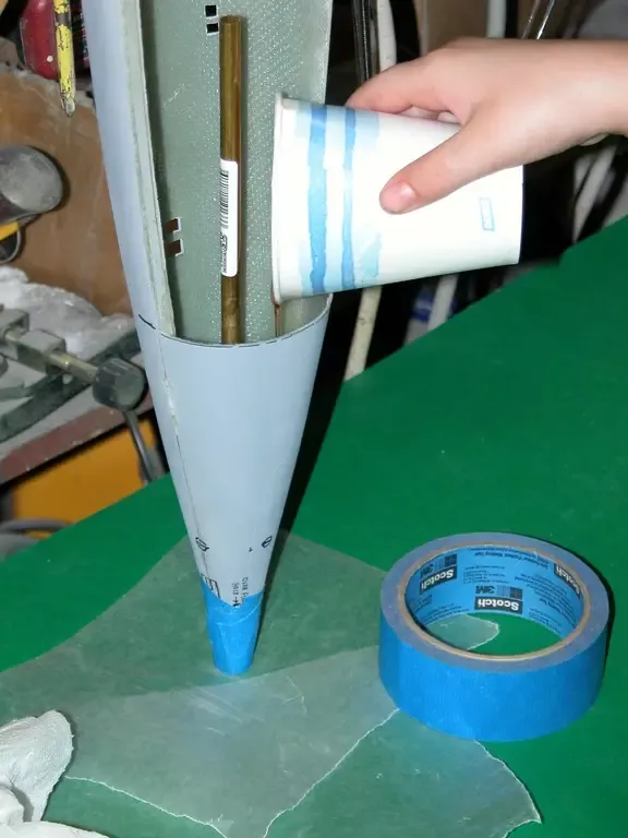

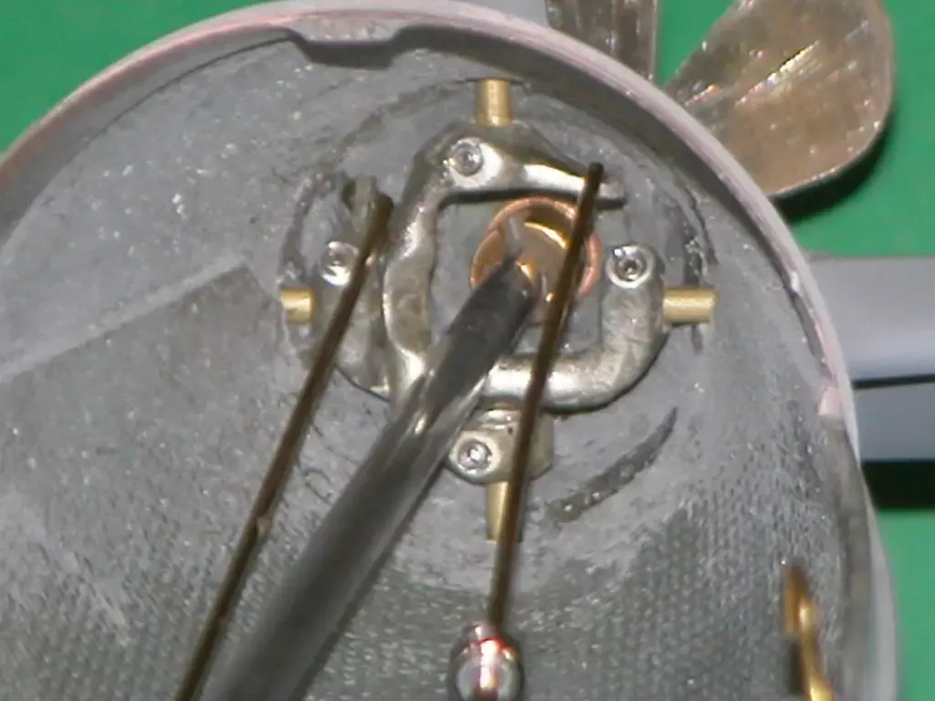

    No, pal. Smooth-Sil is tool making rubber. What you need is a rock-solid, stiff conforming resin. Epoxy laminating resin is perfect for this. What you're trying to accomplish is the 'in-place' encapsulation of the stern propeller shaft bearing. Look at the pretty pictures:

      Gott it. In these two photos - am I looking at a stuffing box? Possibly the second photo shows the tube being used temporarily as a placeholder?
      Thank you Daviid

        Yes, the tube is temporary. It is greased up and shimmed to run along the hulls longitudinal axis. The two bearings slide into place then the resin poured. Once the foundation is cured -- encapsulating the two bearing and forming the bore between then -- the tube is yanked out.
