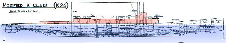

    Hi, I am new to the forum and have plans to build a 1/72 scale model of a submarine that has fascinated me for 50 years - the WW1 K Class. I am thinking of doing K26, the last of the line. Now, from reading various threads I think a ballast/gas/snort system is what I will need. The boat will be about 58" long so will need lots of ballast??
    In case you don't know what a K Class looks like I will try and attach a diagram.
    What I want to know is, is all the ballast best placed in the WTC or can an external tank be used as well? With K26 there is a substantial superstructure projecting above the waterline (red in the diagram). I can envisage the WTC ballast tank being flooded yet the boat COULD still float on the air in the superstructure if it was designed as an open-topped box.
    So, flooding the WTC would get the sub down to "decks under water" but "superstructure only half submerged", then a further valve could allow water to enter the bottom of the open-top-box which would dive the sub, or at least get it down to just having the periscopes above water.
    Does that make sense, or am I better off having the superstructure totally free-flooding and relying on the WTC to flood down?
    Either way, I think I will need Mr Merriman to build me a WTC with a BIG ballast tank!!
    Any ideas, anyone?

      Hi Kim and welcome aboard.
      The ballast is as you said best kept in the WTC and as close to the centre as possible. Makes it easy to trim that way and when filling or emptying the ballast tank the boat still stays level in the water.
      Looks like there will be a lot of boat above the waterline, I would suggest keeping what is above the waterline as light as possible. Makes for a better handling boat

              Hi Kim,
              welcome to the site.
              Guys Kim is from Australia, and is keen to learn about sub construction for his one off K class sub, and ballast systems.
              Kim
              in practice its easier to have the one ballast tank, centrally located at the COG.
              Don't worry about space above the WTC this is free flooding and providing sufficient air holes are available in the subs top and conning tower, this area won't represent a buoyancy problem for you. So you won't need anything else apart from a fairly stock standard subdriver with the one tank and a standard snort arrangement.
              Mike I previously suggested that to Kim off line that I thought the GATO 2.5 SD would be a good fit, but I reiterated to Kim, he needs to get the sub built first.

                  Hi all,
                  many thanks for the encouragement and feedback. Yes, as John said I am from Victoria, Australia. It may be a while until I can start K26 as I am completing a 1/72 destroyer model - HMS Glamorgan - just now and expect that to take several months more.
                  Looks like the GATO subdriver will be the best choice. ATTENTION Mr Merriman - should the standard GATO one do the trick or may I possibly need a special one with bigger tank? I will wait until the hull is completed before actually getting one built, though!!
                  And, yes, I would like to see how the chimneys could retract. I was thinking of the same sort of mechanism some of you blokes use for retractable diving planes, does that sound reasonable? I need to check back, do you drive the gears from within the WTC or is there a separate waterproof servo?
                  One thing for sure, I cannot use fold down front dive planes as the K Boats did not have them - the bow planes slid in and out of a slotted recess.
                  One last silly question, if the boat is "driven" by the rear planes only, that means that to dive they will tilt UP, yes, and tilt DOWN to surface? ie opposite to what bow planes do??

                    Kim
                    all good questions and there are no silly questions from guys starting out.
                    My overall advice is get the basics sorted first. From a practical perspective you might find having the planes deployed always out might provide you with some surface stability - that is don't worry about too many functions first up and working bow planes will be sufficient as opposed to working and retracting.
                    Bow planes allow you to have good depth control, stern planes control the pitch angle of the boat and this is where a sub leveller IMO is a must. A boat driven off rear planes alone tend to have more rapid depth changes than the fine control you get from bow or sail planes.
                    I won't pre empt David's answer re the ballast tank size mate, but as I discussed with you previously, I think you need the boat first.

                      Is this your first submarine? If so, don't start with the K; it's going to be too much of a hand-full for the uninitiated.
                      Yeah ... what John said. Keep it simple.
                      Before you order that GATO SD, build your model first and get all the mechanicals (linkages, control surfaces, running gear) installed and working.
                      Don't sweat the retractable bow planes and storable smoke-stacks yet!
                      The K's were very long, narrow beam boats with terribly long moment arms. Set up the stern planes and bow planes as John recommended -- this boat will be all too easy to broach or dig into the mud without positive control of the bow planes and stern planes, on separate channels.
                      Build that boat. Then we'll talk again.
