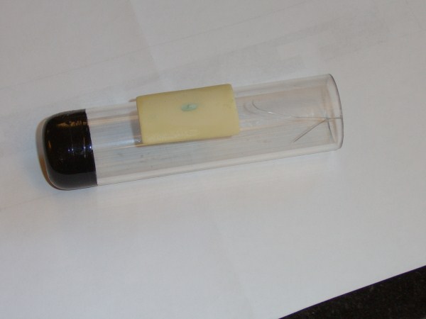

    I have managed to crack the WTC of my Up Periscope. I would like to take the lens off of the cracked on and install in on a new tube. Is there a way that I can do this in order to salvage the lens? In particular, I don't know what the black sealant is. It looks like some sort of heat shrink tubing, but I've never seen any that would shrink down in that manner. I haven't taken the WTC apart yet so I don't know what it will take to remove the lens without damage. Can I do this or will I just have to buy a new WTC with lens?

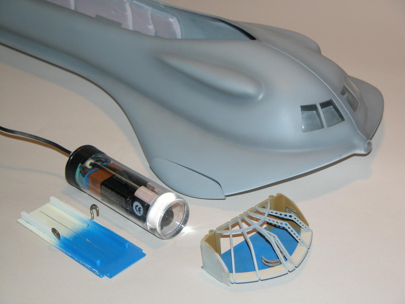

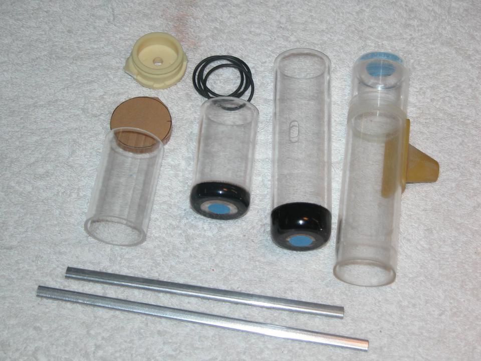

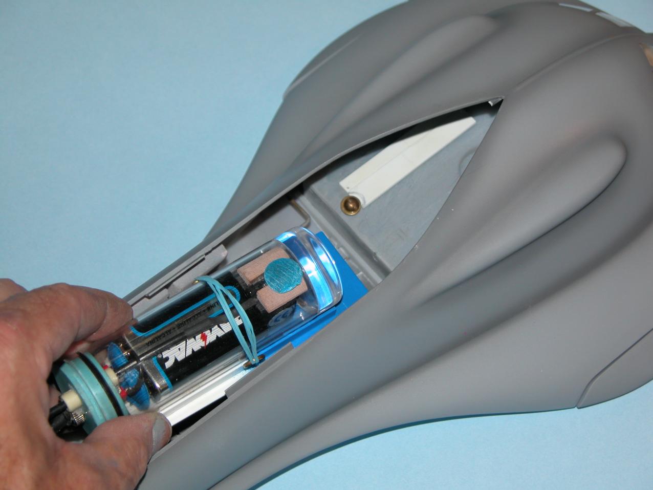

ID:	63597I sent you not only a replacement cylinder and lense for your broken Up-Periscope unit, but also some other odds and ends relating to the system that you might find useful. Package went out yesterday via USPS so be on the lookout for it later this week
ID:	63600Click image for larger version

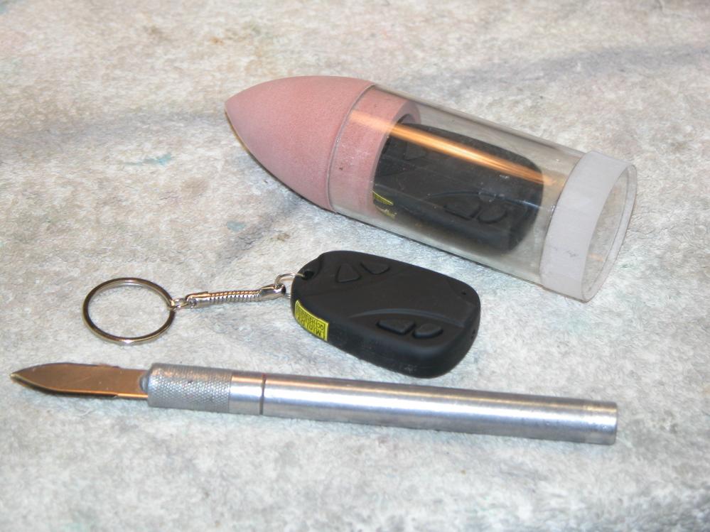

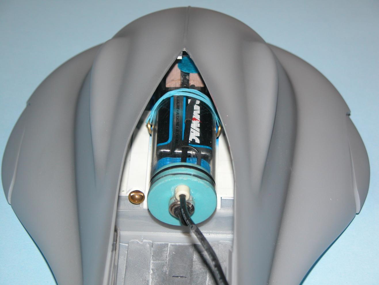

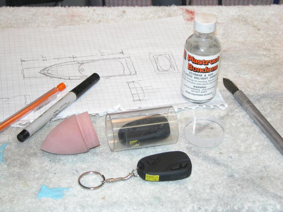

ID:	63599 These two shots show off a new product under development. This little watertight enclosure will house those very popular 808 key chain video recorders. Unlike the Up Periscope system, this is a video-recorder; it does not transmit the image, it records the image to an installed SD card which is eventually down-loaded as a file to your computers hard-drive. So, with the 808 type camera, there is no requirement to hold the submarine to periscope depth in order to insure the transmitted video image makes it to a separate receiver and recording device.
              With the 808 camera you just turn it on, slip it into its enclosure, secure the enclosure to the deck of your submarine and forget about it while it cranks away for an hour or so.

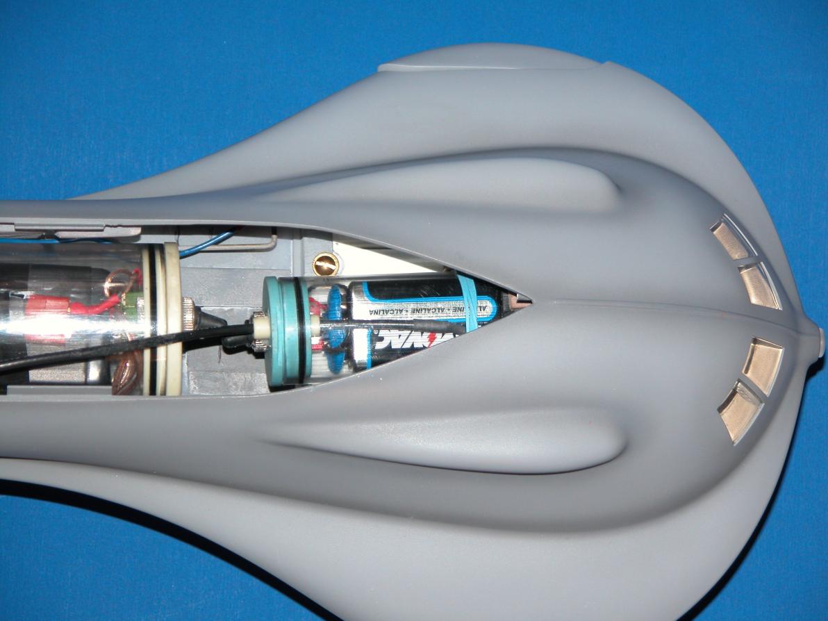

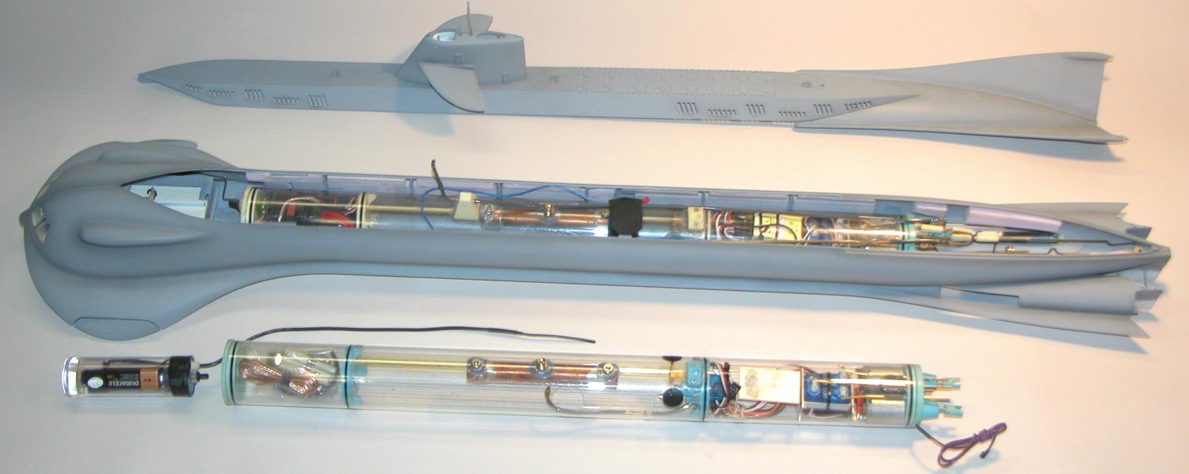

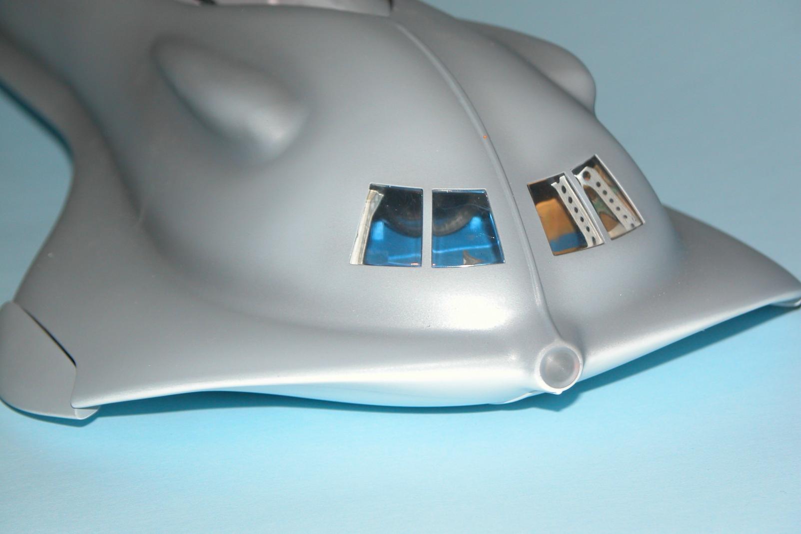

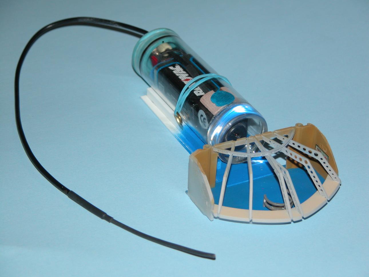

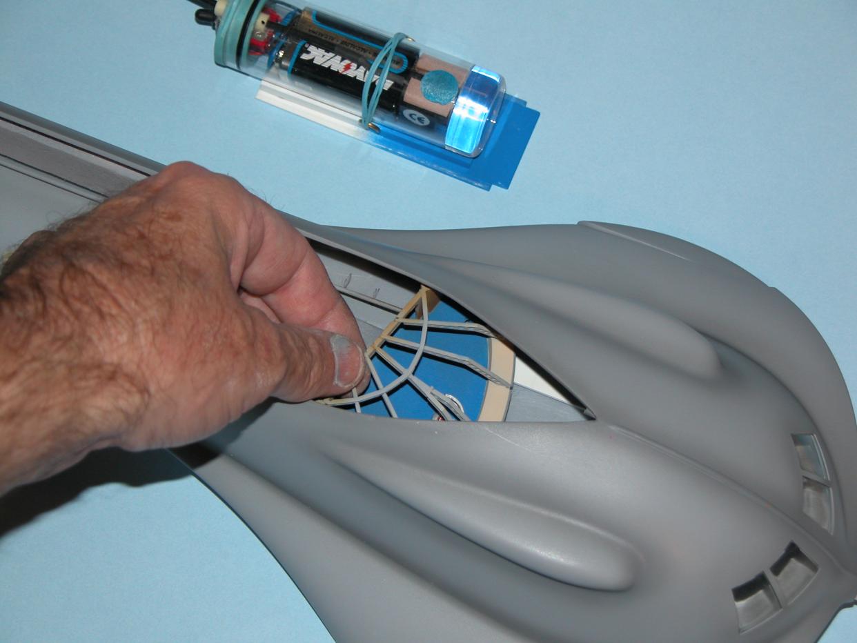

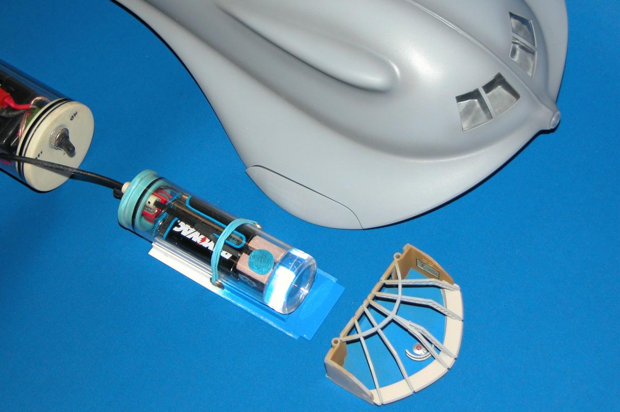

ID:	63610 As you can see, the Up-Periscope unit takes up some of the real-estate in the bow of the Moebius SEAVIEW. The 'control room' is cut away from the forward observation area and discarded. The camera lens, behind the observation area looks out through the four bow windows. The unit itself is mounted on a sliding tray that fits to rails glued atop the flying-submarine bay upper lid. Coaxial cable routes the camera-transmitters antenna to the top of the sail -- the short antenna projecting through one of the periscope holes.
