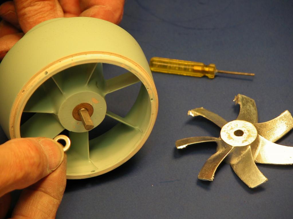

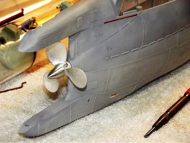

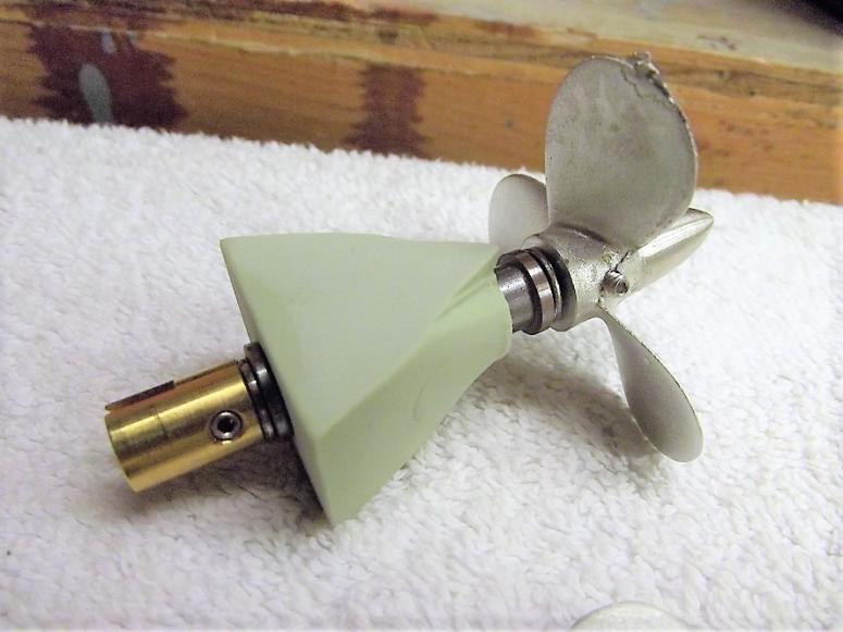

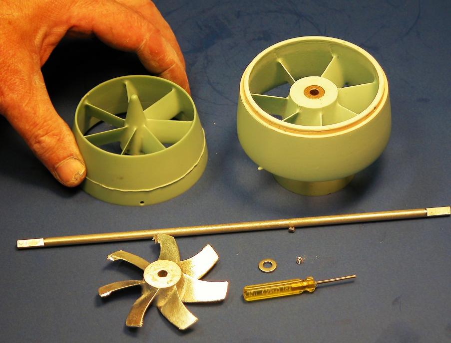

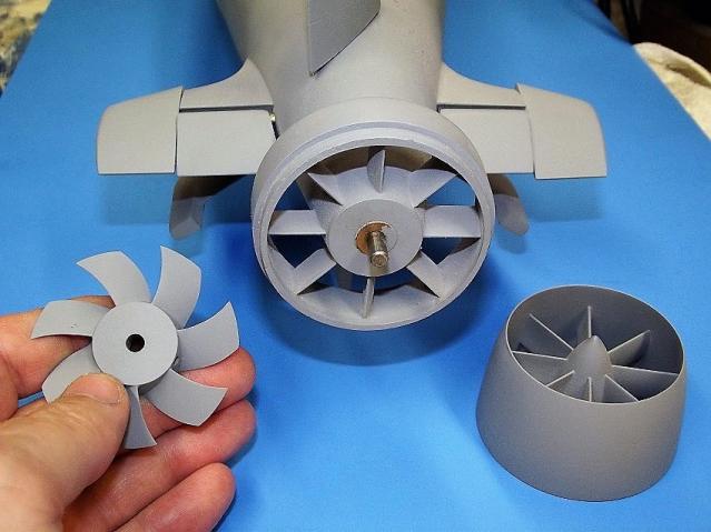

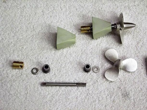

    Drill and tap a 4-40 hole in the side of the hub. Grind a flat to the end of the propeller shaft. Done.

      Thanks David. I had thought that a screw and flat wouldn't be enough to resist torque taking the prop off, but good to see I was wrong.
        • 13987
        Works every time.
