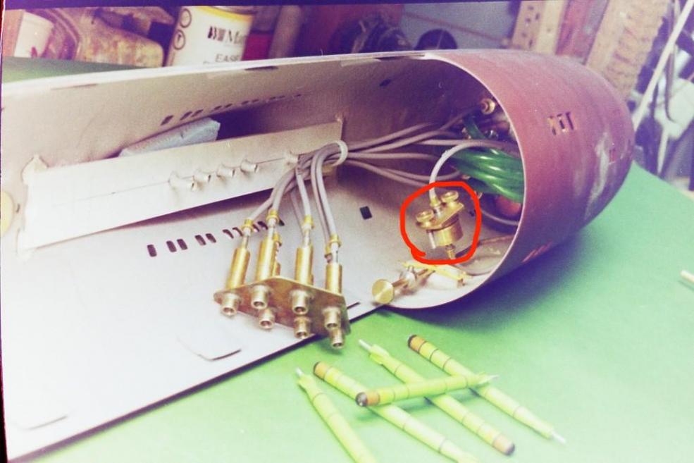

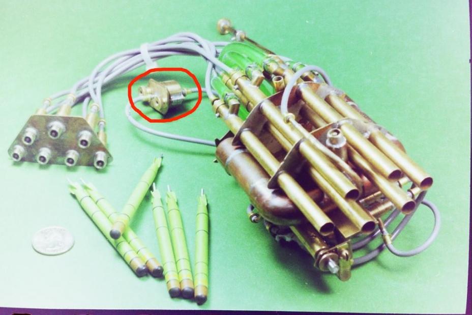

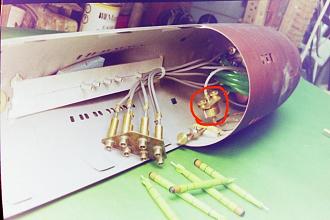

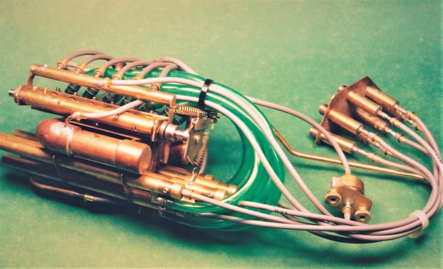

    Can anyone tell me what this little thing drawn in the red circle in the picture is? Maybe Mr. Merriman can give a reasonable explanation. I'm guessing it's a pressure reducing valve, but I'd like to know exactly what the internal structure looks like. Thank you all for giving me answers!
    Click image for larger version  Name:	KlgOPs.jpg Views:	0 Size:	66.2 KB ID:	159864Click image for larger version  Name:	YNHfbv.jpg Views:	0 Size:	66.2 KB ID:	159865
    • 13990
    Particulate filter. A wad of nylon stocking in a brass housing.

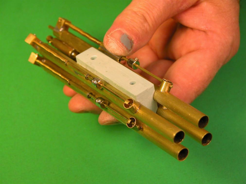

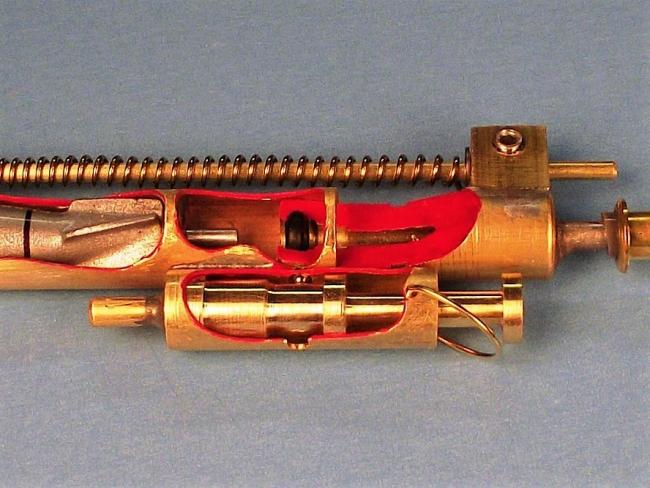

      Thank you very much sir, can I ask why is it necessary to filter the compressed gas? Is it the impurities in the gas? I have not seen such a filter in your current torpedo launcher.
        • 13990

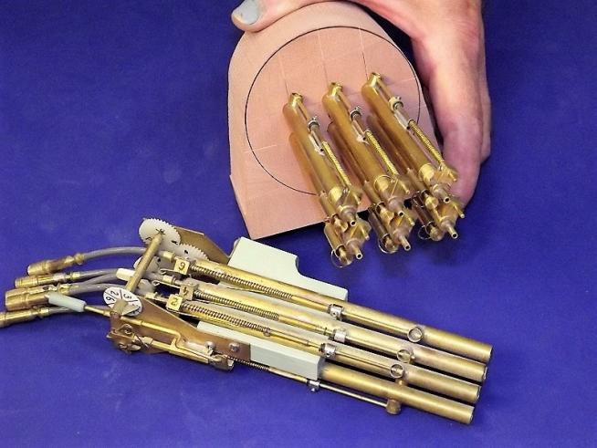

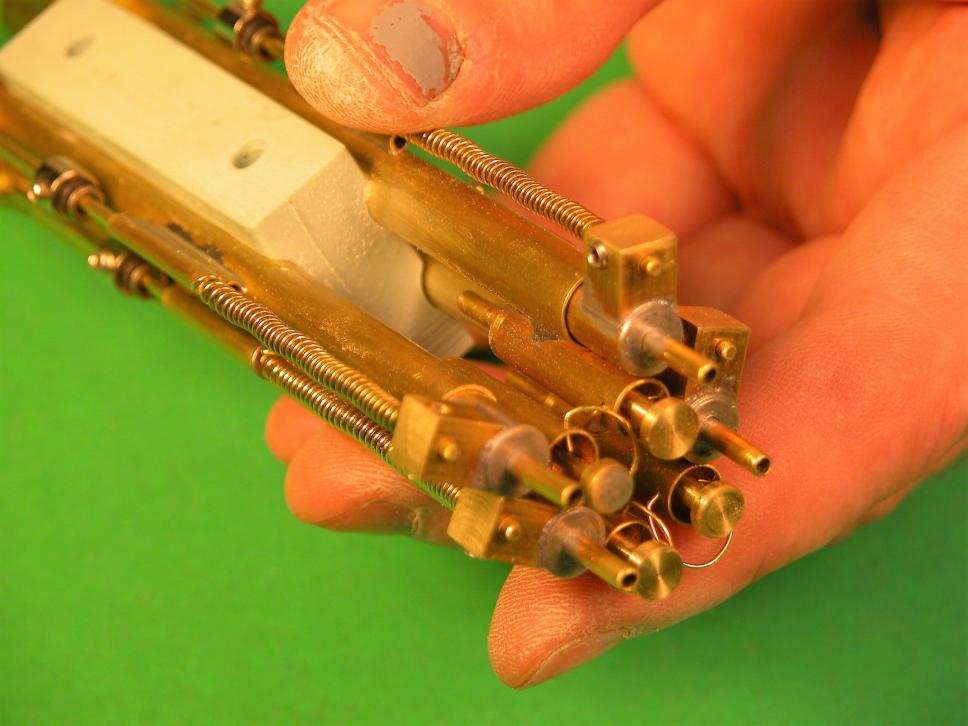

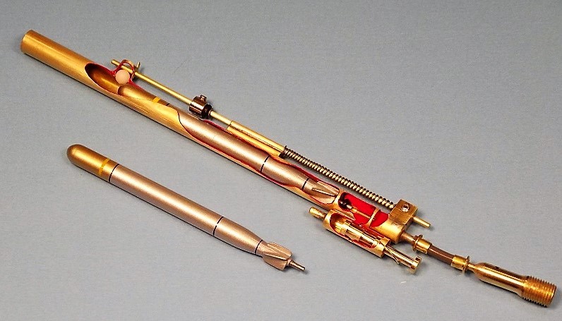

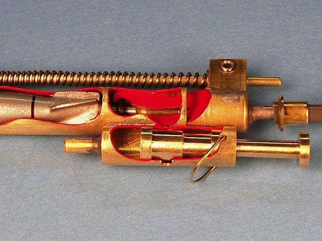

        In the early days -- when I was launching the weapons pneumatically through the use of tight tolerance selector and firing valves -- I was worried about slag, shards, and flux crystals, all a consequence of machining, soldering and other manufacturing processes, fouling the system.
        However, once I matured the launcher to a strictly mechanical system the need for a filter disappeared.
