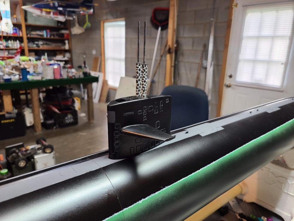

        Fixed or removable. These were fixed on mine.
