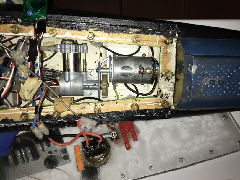

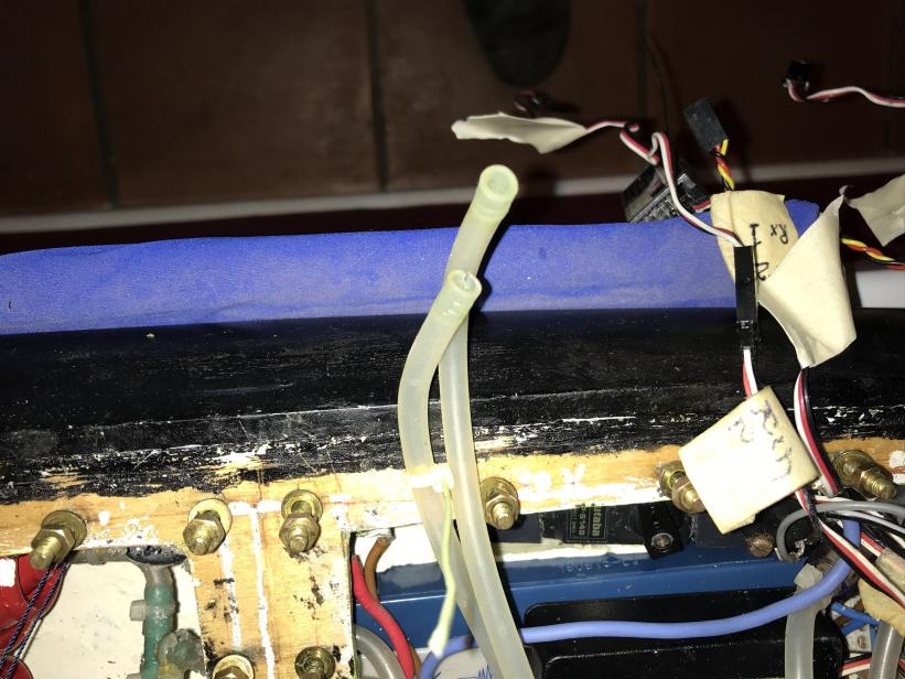

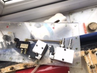

    Hi. I just purchased a sub in which the dive valve was broken, there are two replacement valves. However I have never seen this type before. Am I correct in thinking that the valve lever is connected too a solenoid. If so what is the best way to do this, there is not much room inside the hull, or is there a better method of getting water in and out of the dive tanks. Thanks, Click image for larger version

    Not enough to go on in those pics. However i spot what looks like an adapted tyre inflator compressor. As you've stated you're UK based in a separate post, I would wager this is an old Darnell submarine with a compressed air system. Need better higher resolution pics and photos of the whole boat.

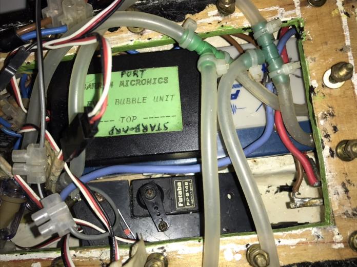

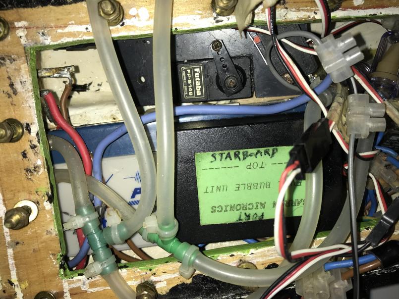

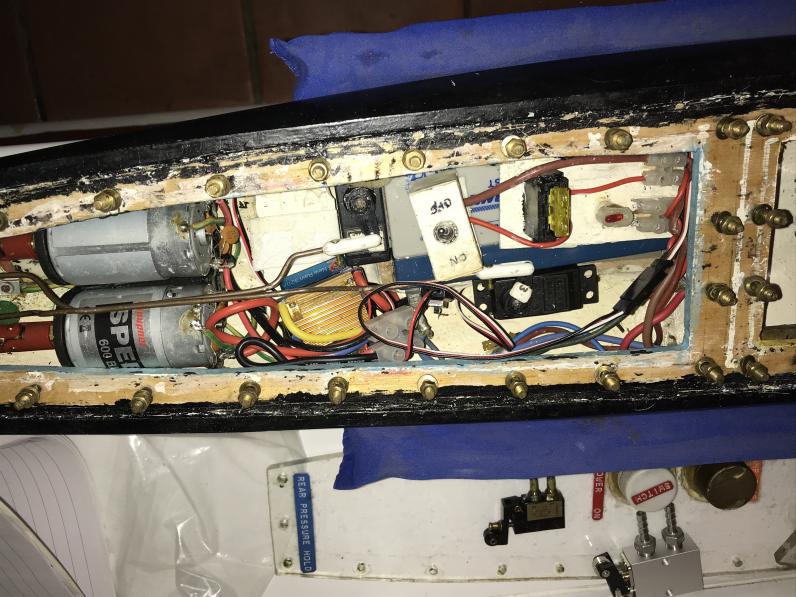

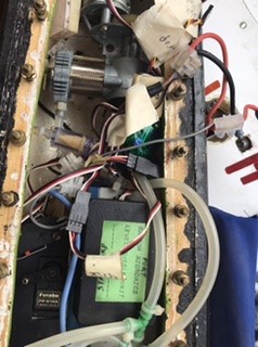

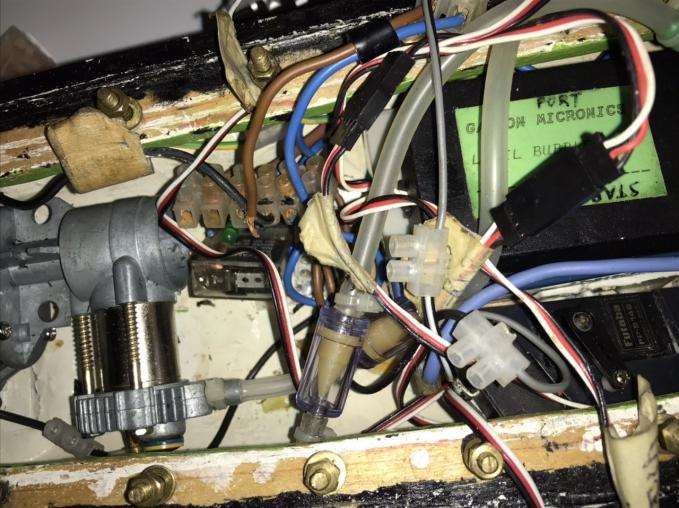

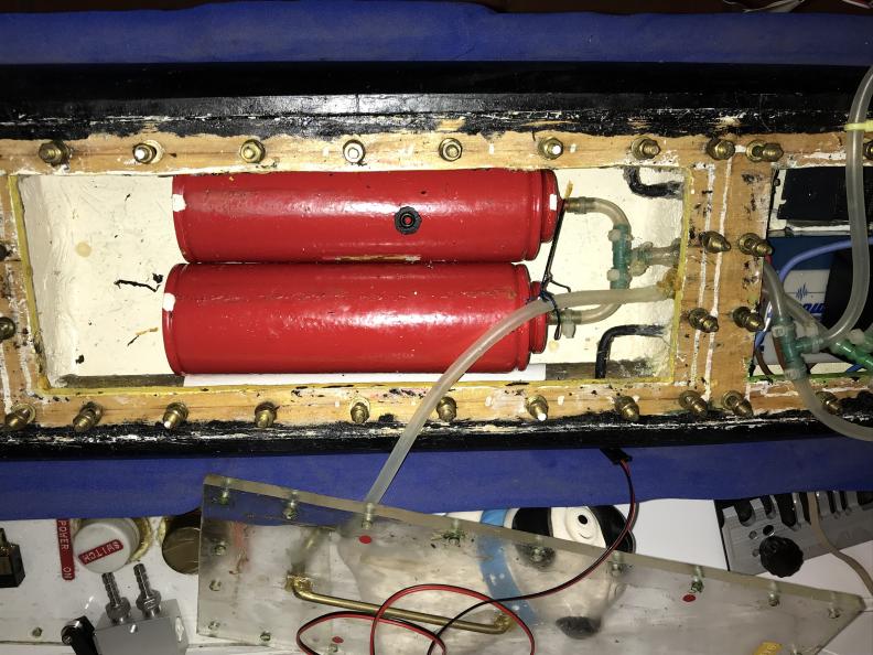

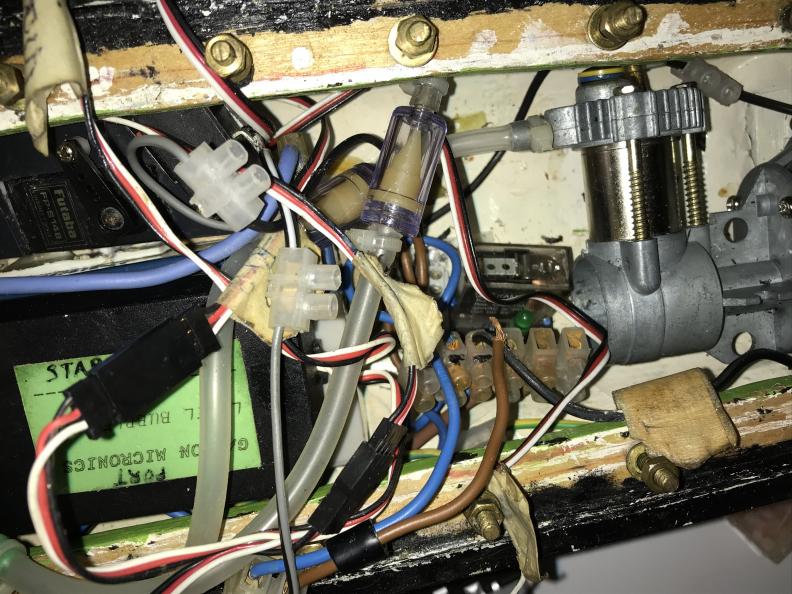

                    Modified Darnell system. Air is sucked out of the central tank by the compressor and stored in the two red painted cans also mounted inside the ballast tank. To surface a servo controlled valve or solenoid operated valve would be operated releasing the compressed air back into the tank, and up you come- hopefully.
                    Some modified this system further by replacing the air pump with a water pump, this is a bit more controllable.
                    Looks like everything in the boat is pretty old school, but should be serviceable with a good check over, Futaba servos seem to last forever if not abused. Wiring needs some tidying, and the rtv hatch seals may need renewal.
                    An alternative is to convert it all to a removable cylindrical based dive unit. Ron Perrott recently placed a module on the market that is purposely designed for the bigger Darnell subs.
