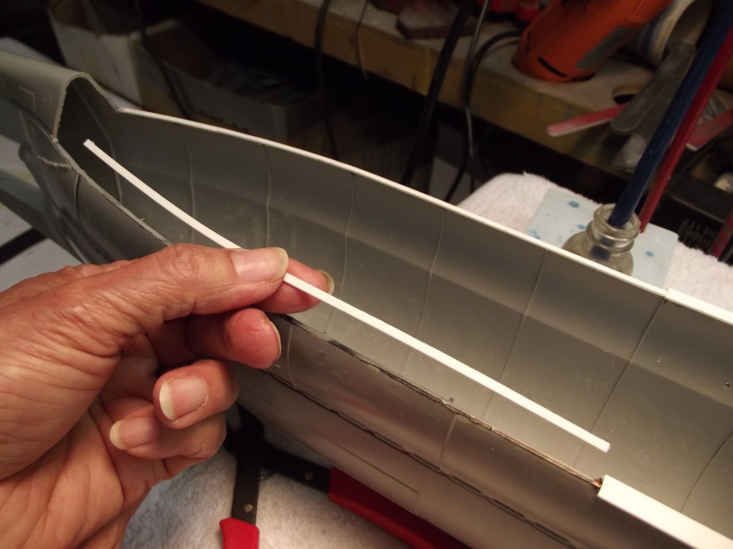

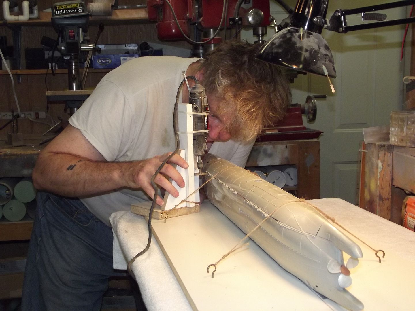

    Make two parallel lines where you want to part the structure. Space between them 1/16". Use a carbide cut-off disc or diamond wheel to make the cut -- it's kurff will be a bit less than 1/16". Block sand each piece down to the line. Build up the edge of one piece with plastic strip stock or a CA-baking soda slurry. Done.

      Once again, you have justified your existence. I hadn't considered cutting out a bigger kerf and then building it back up with strip stock. Good idea.

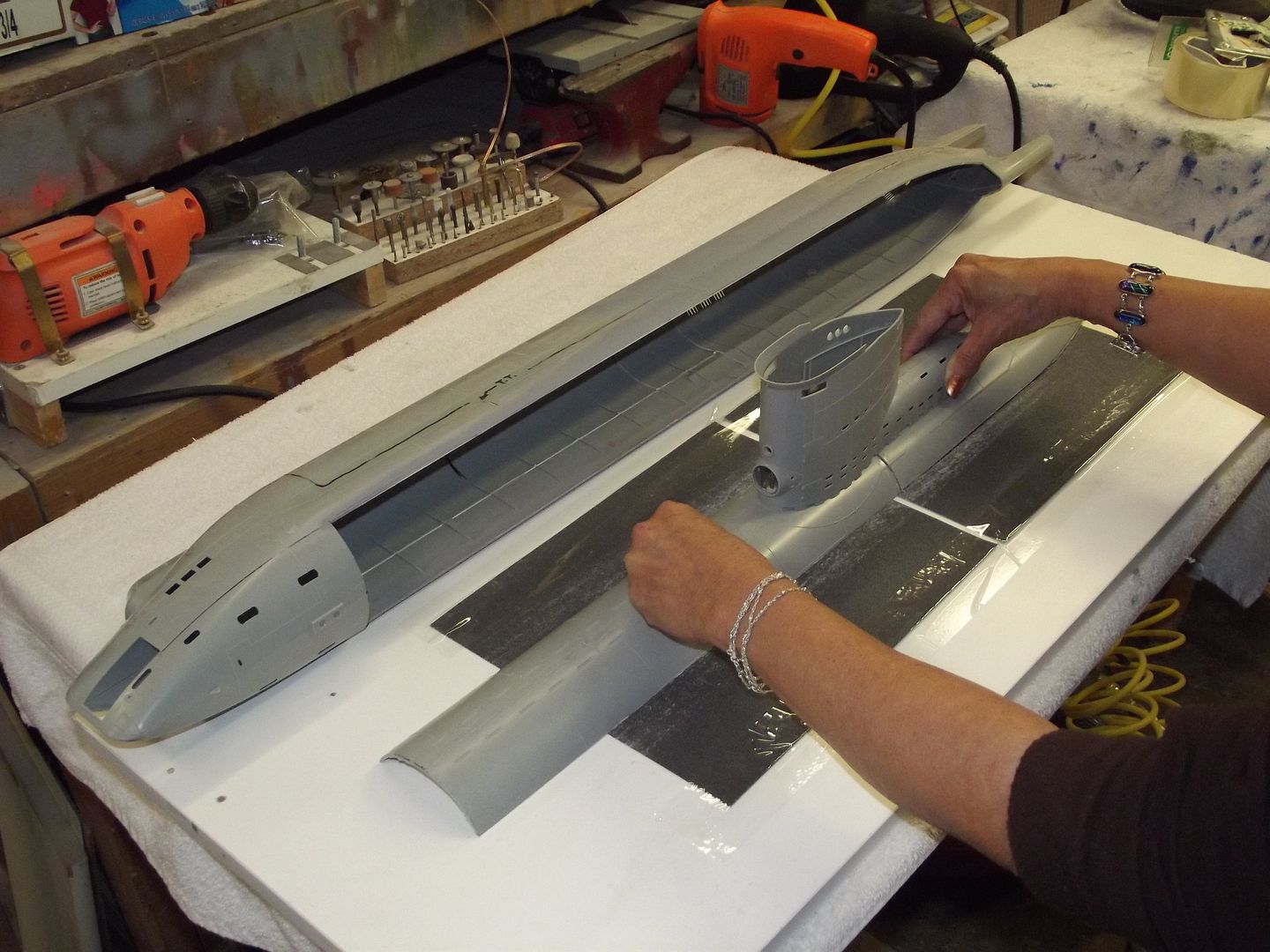

                Anyone notice that in one photo we can see Daves nice manicure and bracelets.
                  • 13925
                  You're looking at the E half of D&E Miniatures, pal!
