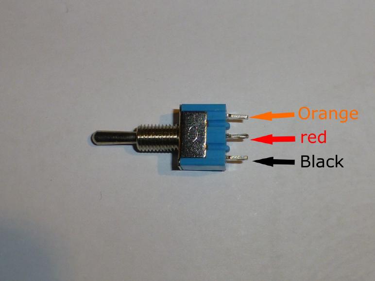

    I want to install a 3 position toggle switch to my Futaba TX.

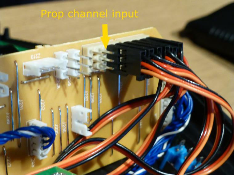

    The switch will be connected to a proportional channel input
    As far as I can see the red goes in the middle the black on one side and the orange on the other side.
    When the switch is activated the red and black are connected or the red and orange are connected.
    I think I don’t need a 82k resistor
    Am I missing something?

    No resistors required. Wire as you said.
