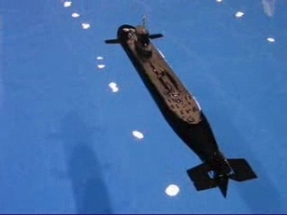

My first attempt at an RC Sub was the Robbe SeaWolf V2. I have only made tub tests on it and its good to go.
It was four pounds on the first test. This 2nd test was just perfect and straight as an arrow. Its weight is 5pds.

The Robbe Seawolf was my first RC sub....some decade plus back.
Its a fine submarine model and the latest evolution has made it easier to get to the innards etc. I loved mine - its a fun boat that I passed around to new guys in my RC boat club to experience some basic RC submarining.
