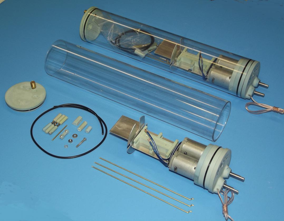

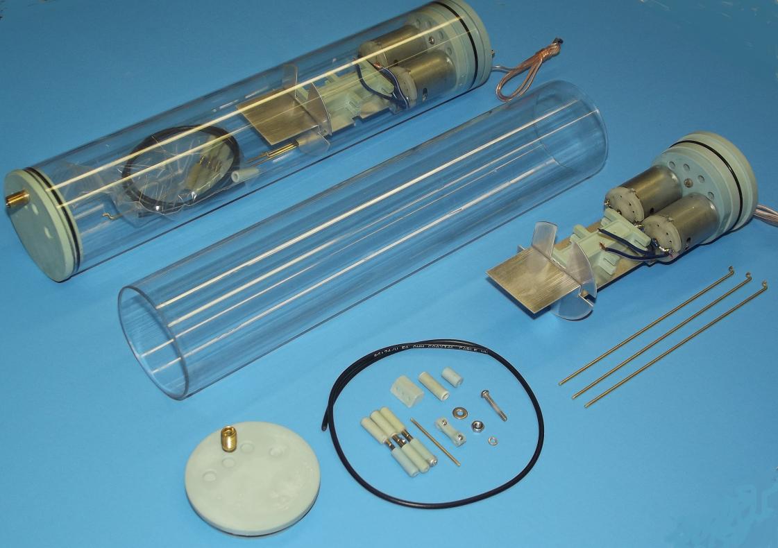

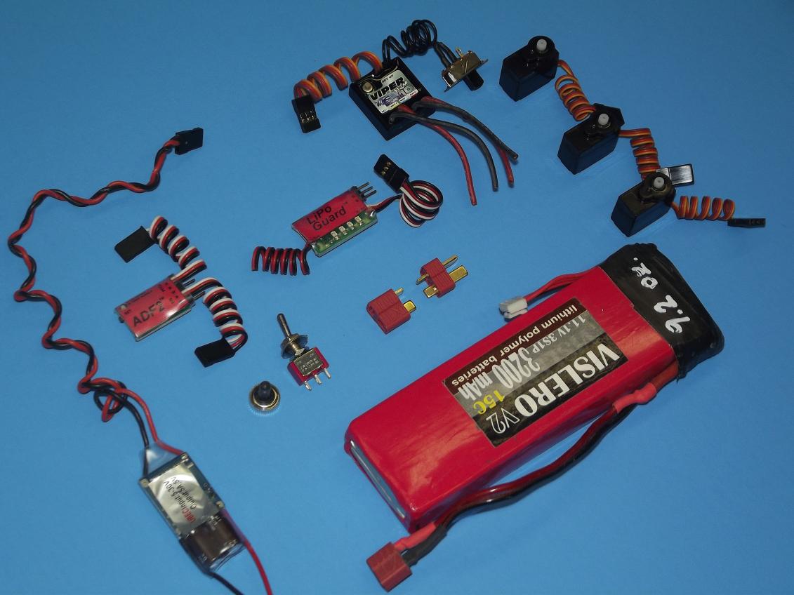

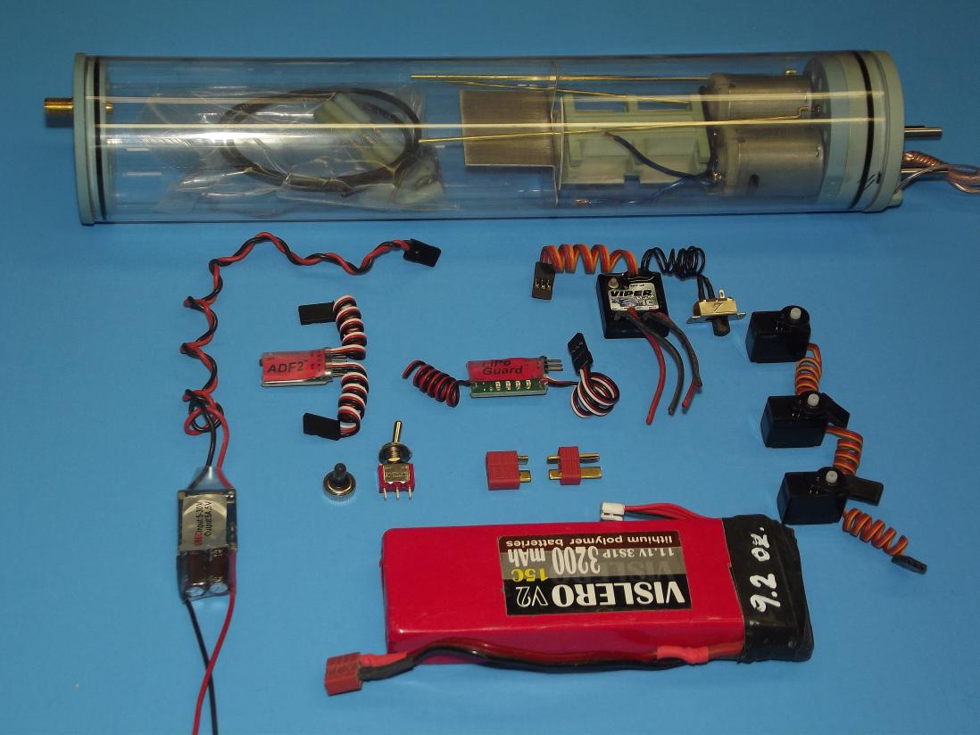

    What you're looking to do is something like this, Dave:
ID:	92444Click image for larger version
ID:	92445Click image for larger version
ID:	92446Click image for larger version
      [ATTACH=CONFIG]28788[/ATTACH][ATTACH=CONFIG]28789[/ATTACH][ATTACH=CONFIG]28790[/ATTACH][ATTACH=CONFIG]28791[/ATTACH]
      Aye to the electronics but Mikes tube has the motors mounted and bulkheads but I will need push rods and connectors. Prop shafts, bearings.... dont really have a list of what I need, more like a short list of what I have when I get the delivery. Perhaps this afternoons mail.

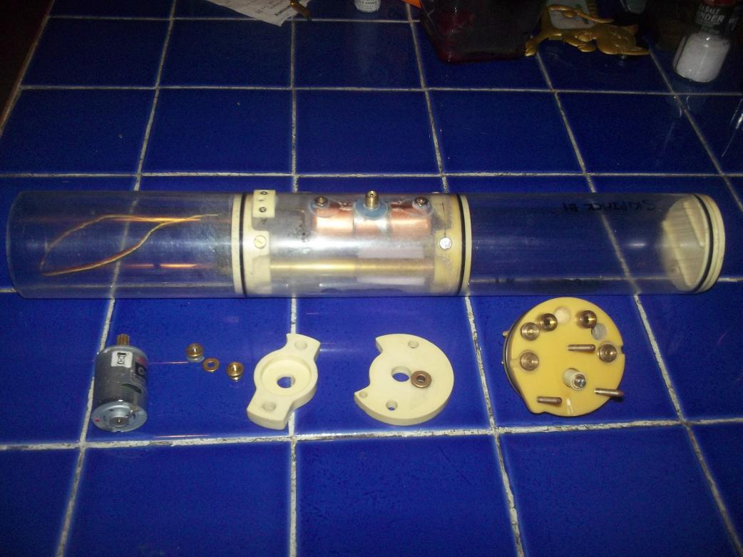

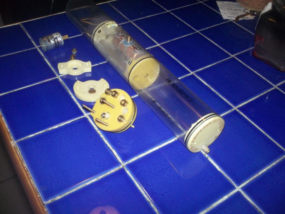

          Got the box from Caswell yesterday with the two WTCs. The 2.5" wtc is an old Skipjack with a single motor single shaft and an asperation system in the balast compartment. I am going to attempt to utilise most of the parts to build a simple driver with dual shaft output with 2 pushrods aft and one forward. I havent a clue as to how Im going to accomplish this so, Im open to all suggestions and ideas.Click image for larger version
ID:	92500Click image for larger version
ID:	92501 I suppose a complete dissassembly if the tube would be the first. I dont want to gorilla it apart since its a delicate antique and I dont want to depreciate the asthetic value by scratch and dents. I would think the "O"rings have been dry some time and the caps may not be easy to remove, however, a litle lubricaton works wonders, in some cases. Once I have it stripped down, Identification and inspection of the inventory, {I&I} to see what stays and what goes. I have no idea what some of the things are or do, so bear with me. Your floor Gentelmen:
