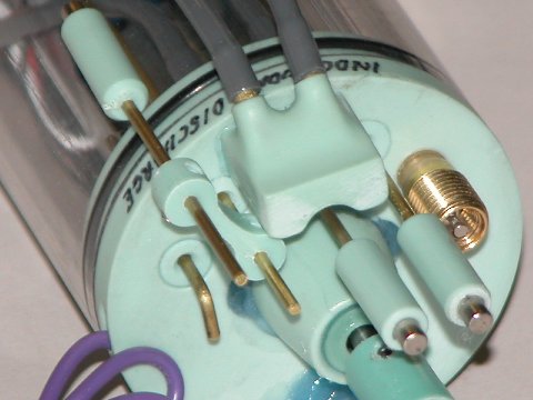

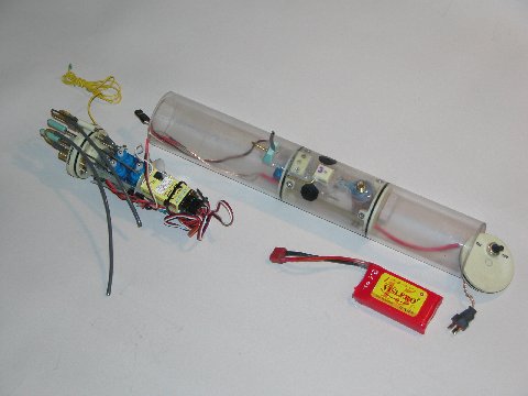

      John,
      The addition of the LPB (I hate the term, 'Snort' ... I wear PINK underwear!I wear PINK underwear!I wear PINK underwear!I wear PINK underwear! British!) sub-system to our line of SubDriver's, as you know, is recent and has followed an 'evolutionary' track.
      After some initial fumbeling around I've finally frozen the design and placement of the various fittings and adapters needed to route the induction and discharge plumbing between LPB, induction intake point (within the sail), and discharge point (atop the ballast tank).
      As you can see I have developed and now provide with the SubDriver's (those that employ a ballast tank) these fittings. Their job is to insure a more rational routing of external hoses and to make the sub-system a more robust installation; less prone to handling or maintenance damage.

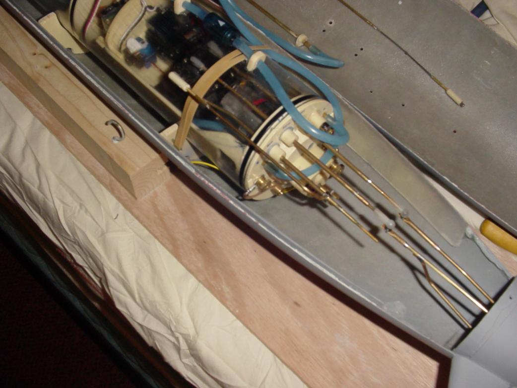

              Yes, the Snort Fittings give it a neat clean appearance and good way to connect them, a great design, but I can see that it could cause a clearance problem in some models since it's up high above the SD.
              It would not easily fit in my Gato, I had run the inlet tube flush against SD, on top, and the outlet tube on bottom side, for the best fit.

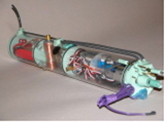

                  I was able to capture the snort pictures, from one of the two banners that show them, but they are small and low-resolution, so difficult to see. :(

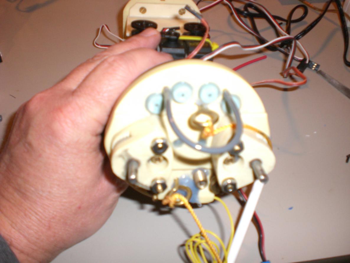

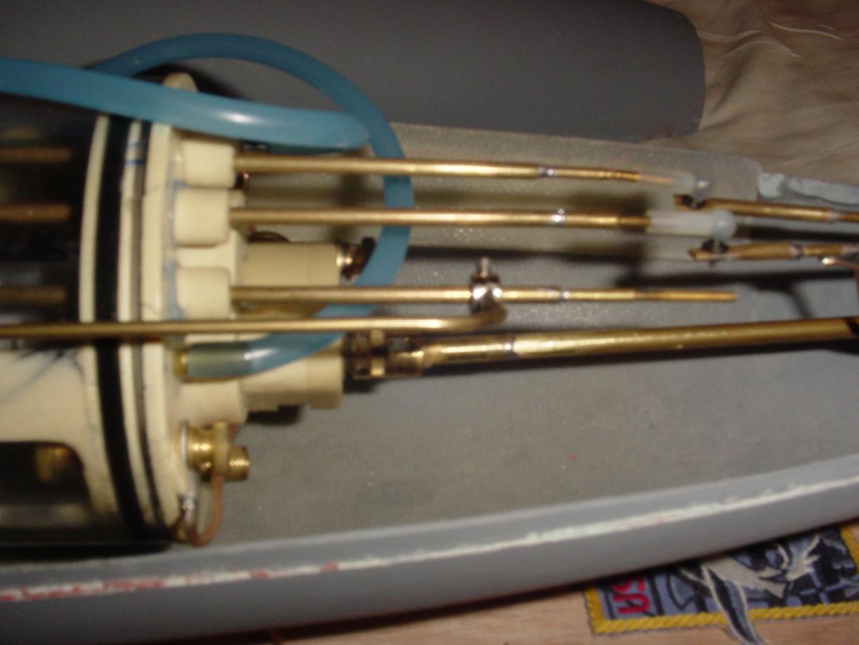

                    I took a pic of mine. The tubes are near the top where the servo arm pass thru. Only had enough juice in the camera for one shot :( I can get more after it recharges.
                    There are two tubes through the bulckhead. A hose is conneted between them. (Dave sent it that way and I haven't removed it yet...)
                      Yes, that's the Old style (Tried and True style)
                      The New design takes all the Hassle and Bother out of connecting it up, external of SD, but also takes out the Creative-Element, which I so Enjoy. :)

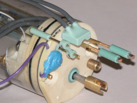

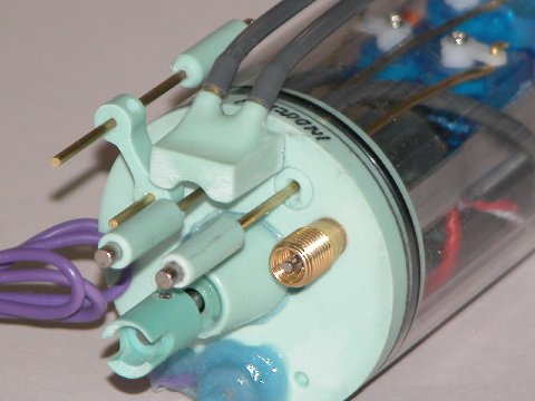

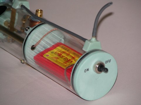

                          Here are a few pics folks!
                          (From the beach in St Thomas!) Now, where's my Martini?I'll drink to THAT!

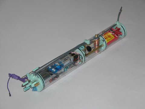

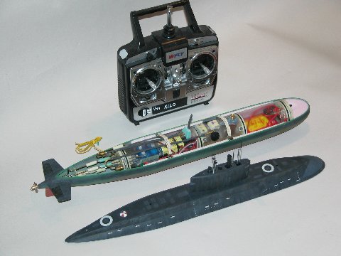

                            And a few more!
                            (Hey! Shouldn't David be loading these? I can't concentrate on the beach girls and this photo job!):)
