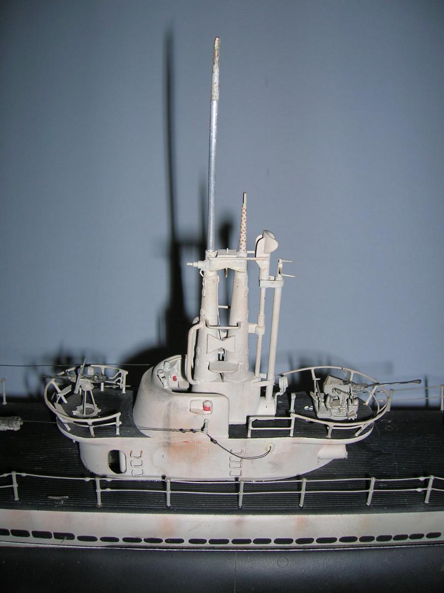

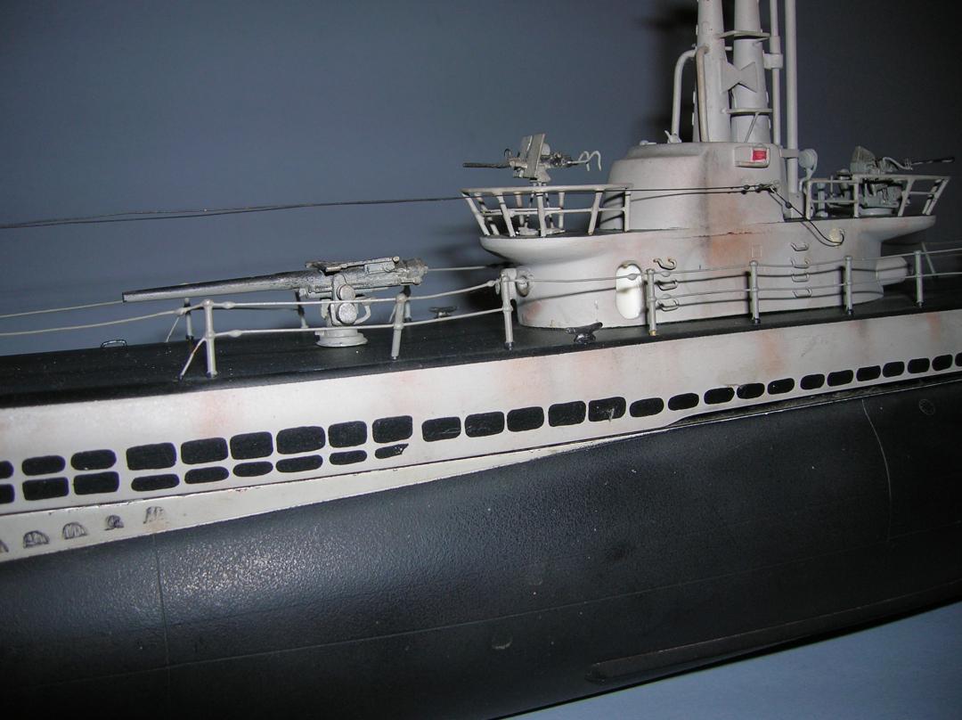

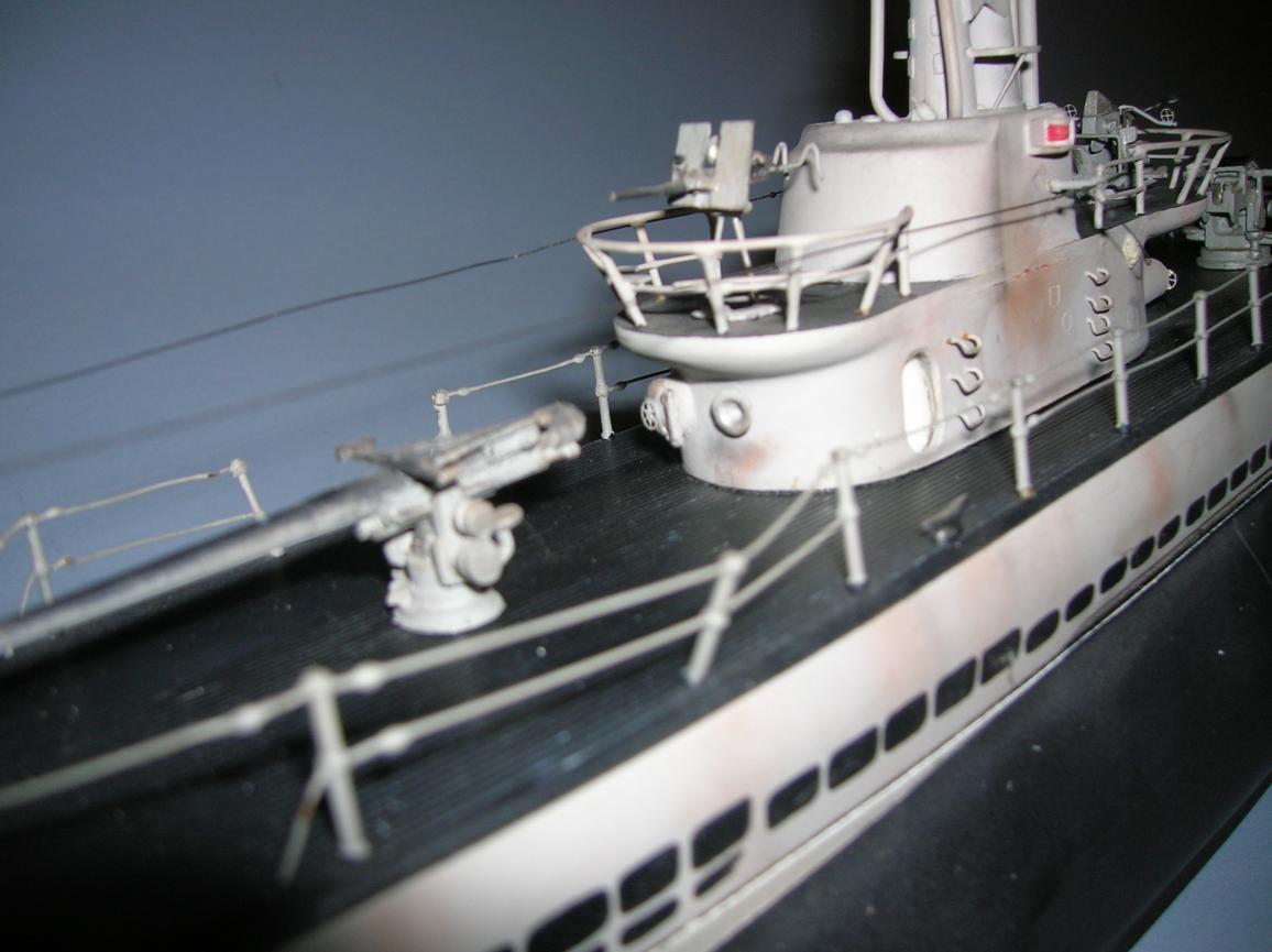

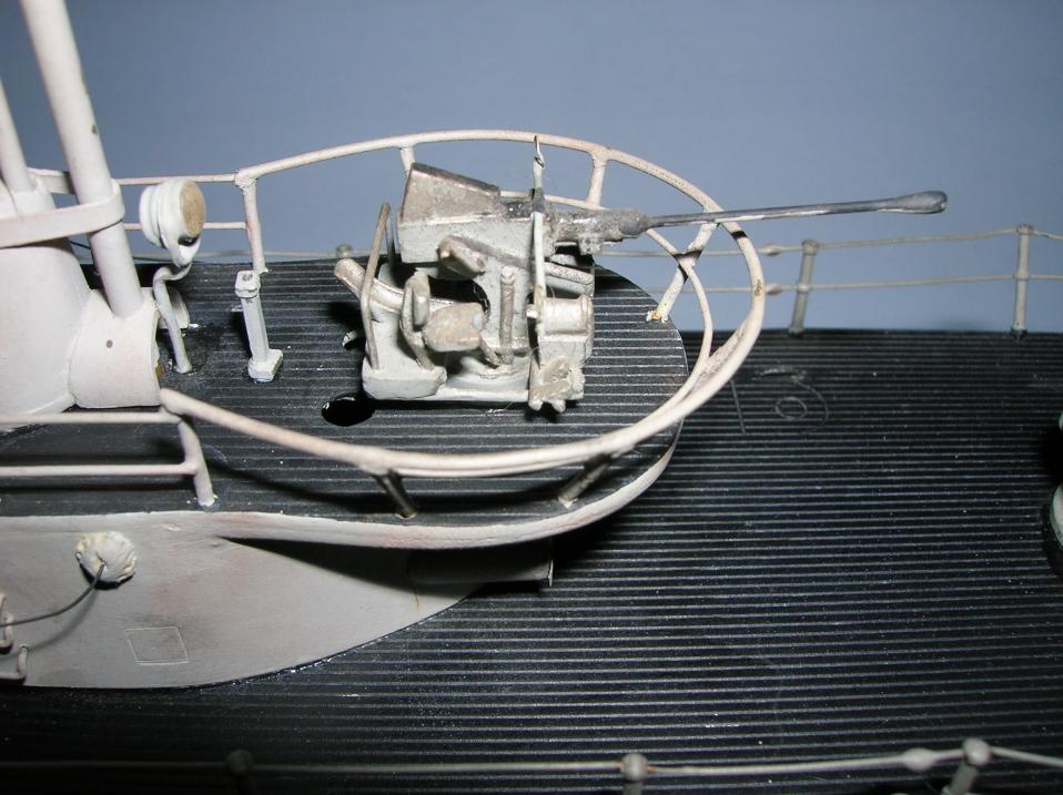

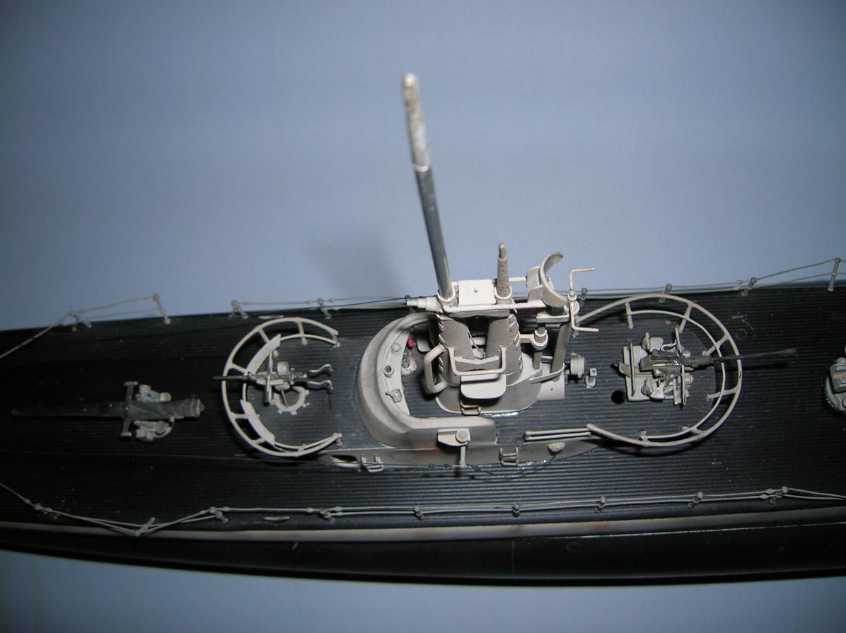

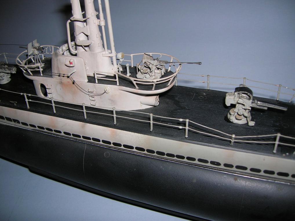

    I bought this FG hull, conning tower, cast white metal guns and deck fittings from Lee Upshaw at Scale Shipyard about 20 years ago. The project took about two years and was basedClick image for larger version
ID:	100528 on the series of articles that Skip Asay wrote for Flying Models detailing the requirements for RC submarining.
ID:	100526I wanted to build something that wasn't a 'kit' or styrene plastic at the time. This was a good size at about 40 inches in length. It has been through a Click image for larger version
ID:	100525couple of internal redesigns over time and needs a WTC. But first, a snort install would be good practice and some final dives of the old system is in order. I took Click image for larger version
ID:	100524out the gas system long ago and she now vents the ballast tank once with no way to blow, planing to the surface. Perfect to try out a snort system.Click image for larger version
