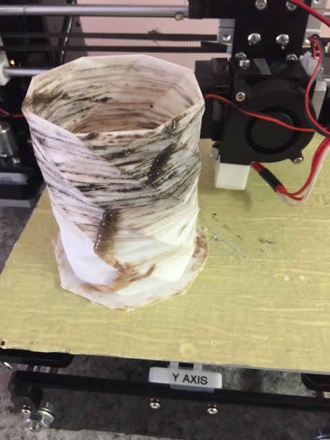

    Here's my first test piece. Scorched, and 'worms'. It looks like the extruder head had a leak, hence the 'worms'. and the scorched look was because the thermister had popped out of the heater block. I'm amazed at the poor design of this, but someone recommended fire cement to hold it in. I need about 1/100th of a thimble full of that stuff.
    Onward! One day! I'll print something useful! Click image for larger version  Name:	IMG_0855.JPG Views:	2 Size:	157.3 KB ID:	117121

      I found out why every thing got scorched! The tiny thermister had popped out of the hole in the heater block. It's only resting in there and is easily dislodged. There is a screw hole next to the thermister hole and I guess there should be a small screw to secure the leads, but I can't find one.

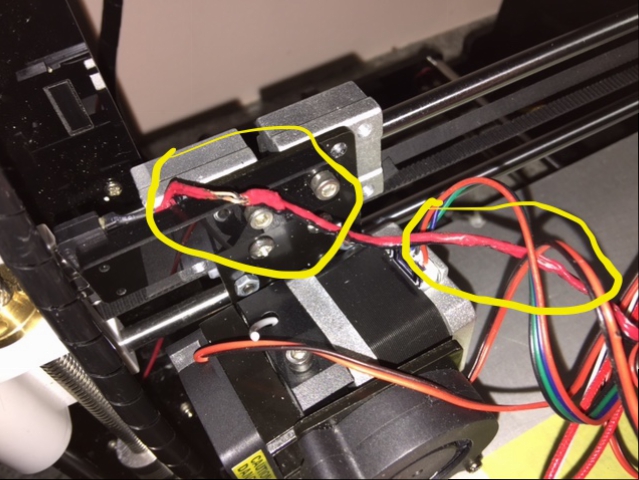

        I'd just made a major discovery on how to stop the constant filament jams blocking up my hot-end (yes folks that's what it's called - minds out of the gutter please) It seems that you must let the head heat up first, then press down the ratchet arm on the stepper motor, then push the filament through until it spews out of the nozzle.
        On finishing up, press the rachet arm down, push in the filament until the nozzle extrudes some 2 inches or more, the pull out the filament. Then pull out the extrusion from the nozzle. This will prevent the nozzle being clogged. Just as I figured this out, the fuzzing thing caught fire.
        Unfortunately, the wire was embedded in a loom serving all the switches and stepper motors, so every piece of electronics is compromised
