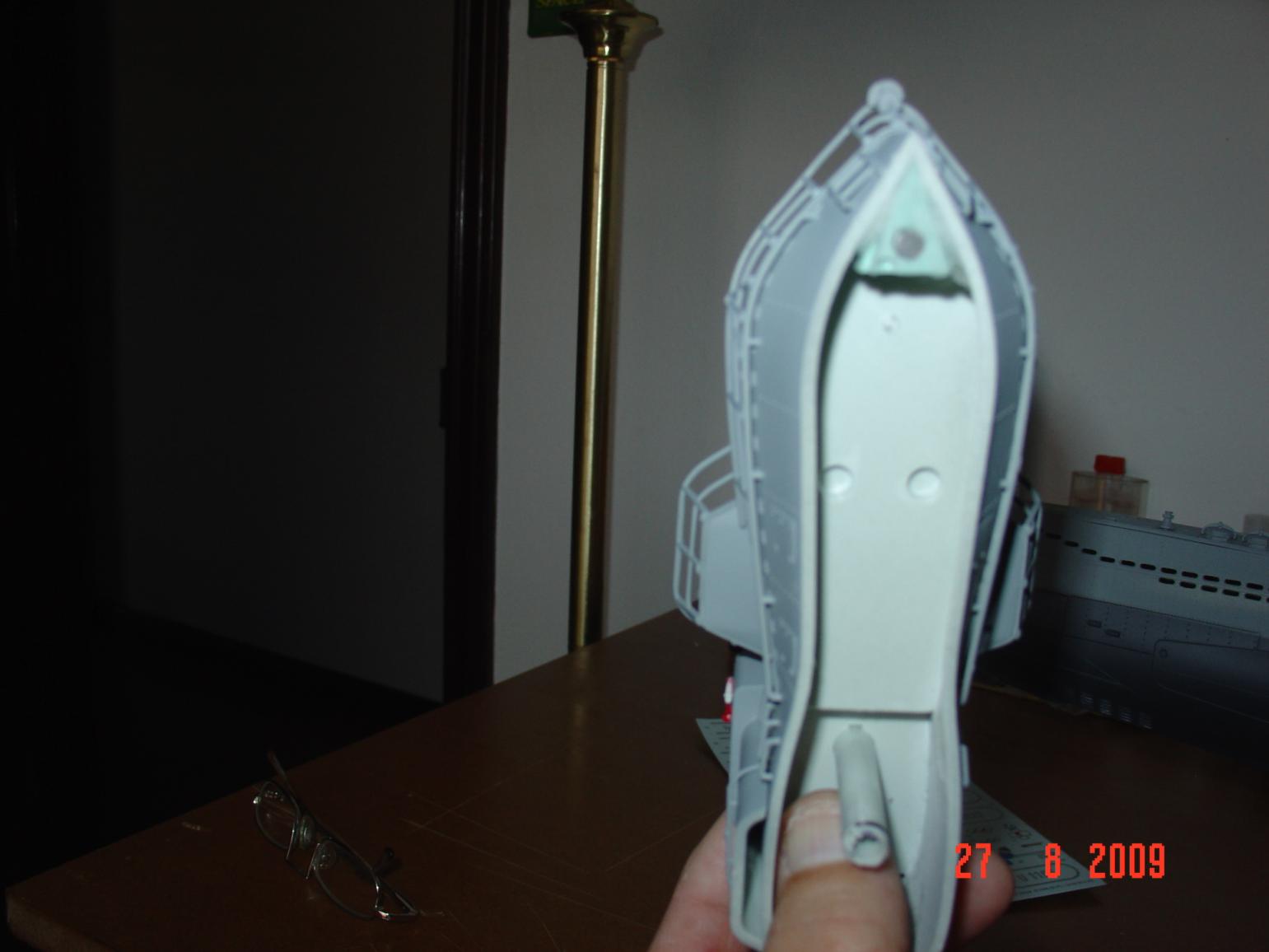

    This is my second type VIIC/41. This sub got the Caswell fittings kit.

      David:
      I wish I could say something that would improve the kit but I can’t. The kit is perfect for the Revell type VII C.
      My new type VII C/41 is the Atlantic version which has a different conning tower than the ‘Wolf pack’ model. The fitting for the conning tower aft magnet didn’t fit. Of course there’s always CA and baking soda, which as you can see in the attached picture I used. This being my second type VII RC sub I didn’t really have any problems like the first sub. This sub did have a warped right hull side. That hosed up the matting of the stern. There is also still a warp at the stern. I’m going to have bow dive planes in this sub which the kit serviced well.
      The kit made the installation of the rc stuff very easy. Rudders super easy compared to the last effort I made. Stern planes maybe off setting the hole in the adjustable white metal to get more through in the dive position?
