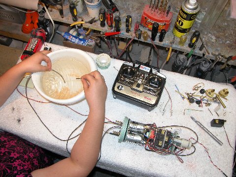

    Here's The Wizard's Chief Technician checking out the Snort pump in some soapy water.

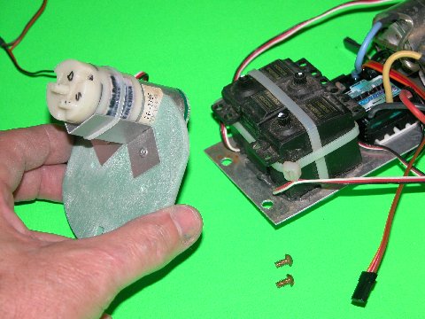

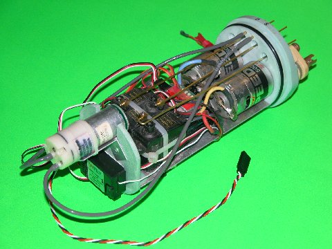

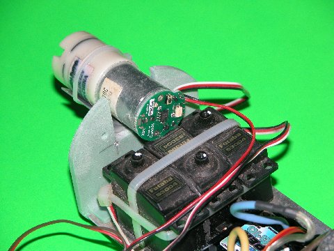

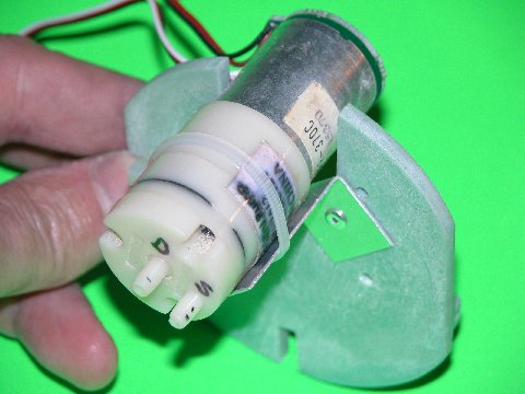

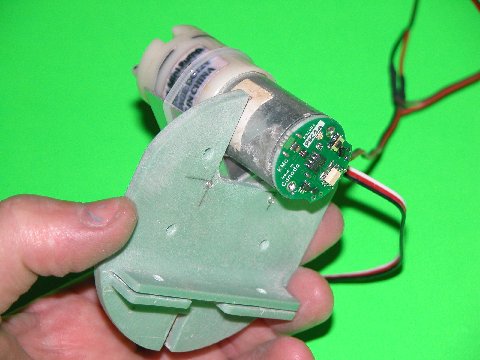

    Here you can see how His Eminence rigged the Snort pump into the Sub-driver bulkhead. The Controller is soldered onto the back of the pump.
    Note the simple bracket made of aluminum sheet and riveted to the bulkhead. The pump is held in place with Zip-ties.

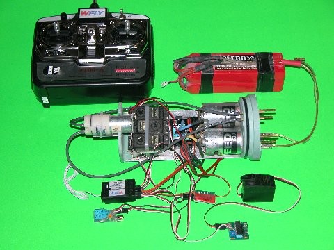

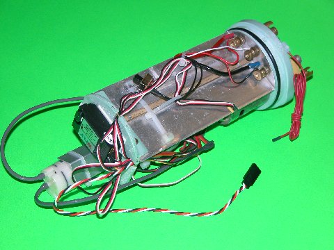

    Here's all the 'stuff' duly installed and waiting to go. The Wiz has installed two 3200mah Lipo batteries, so I should get a really good run from this.
