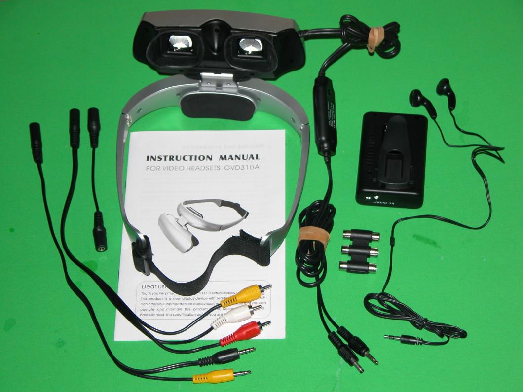

    Well, Damit, you're talking to someone who uses those things. Don't sweat it, the goggle video optics are focused for your eyeballs -- the effect is to put you right there in the driver's seat. Sit down when you use them or you'll fall on your ass.

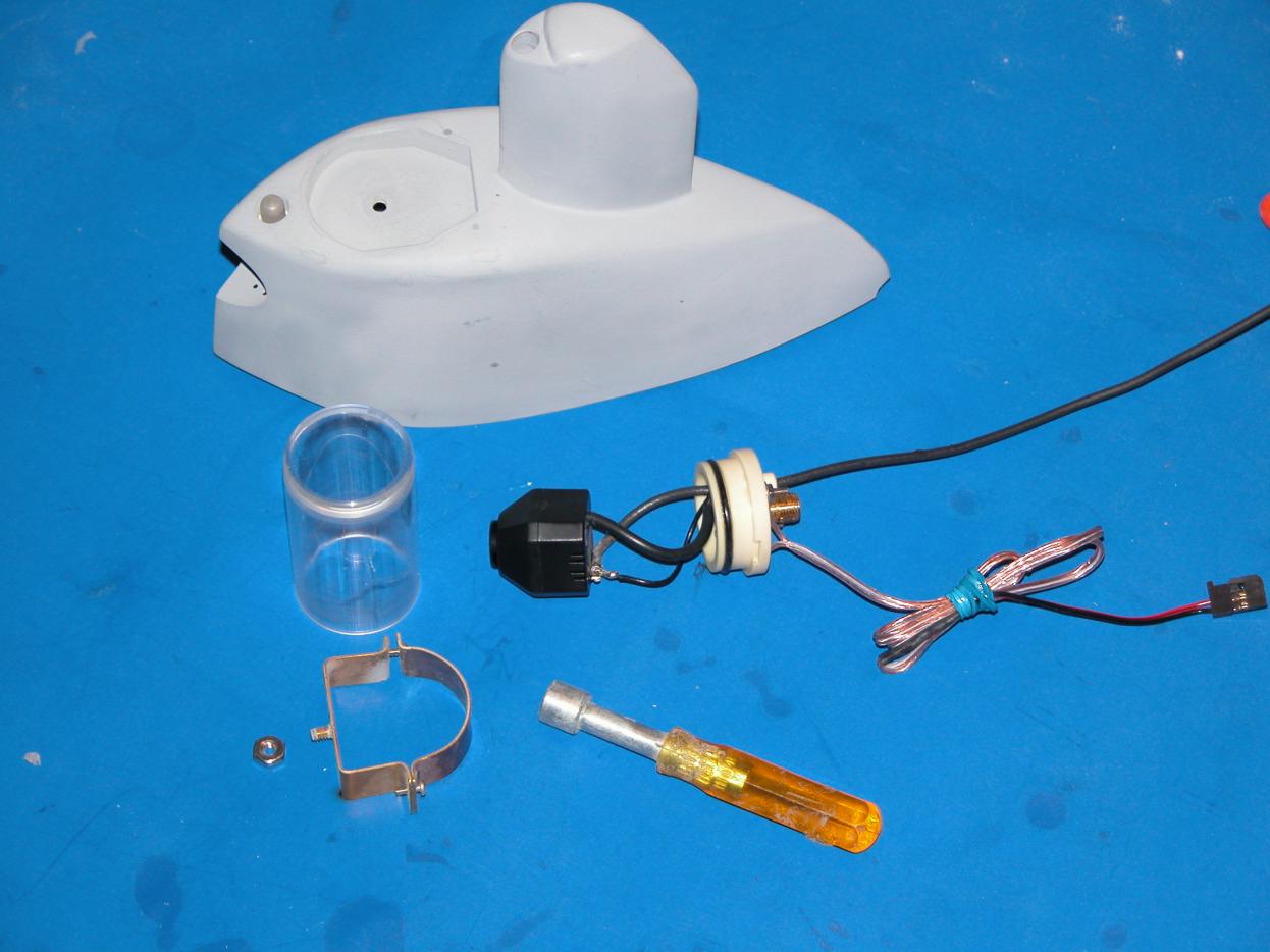

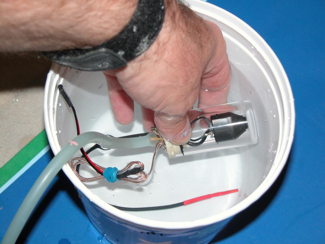

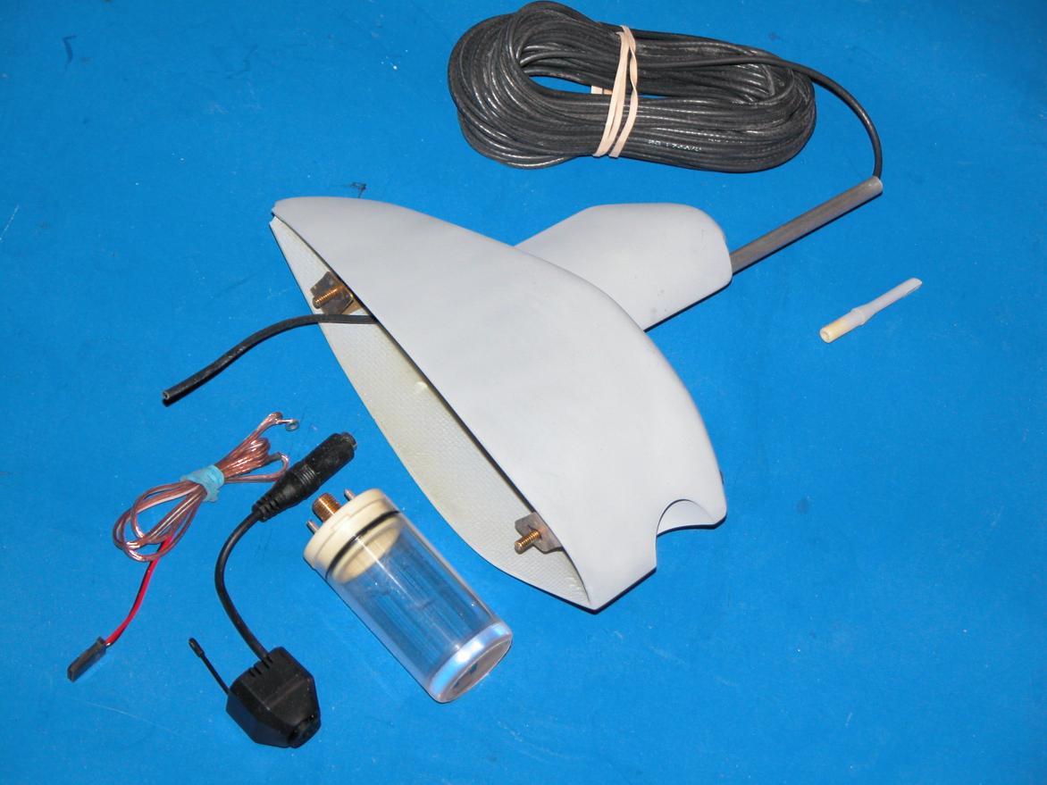

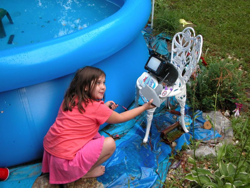

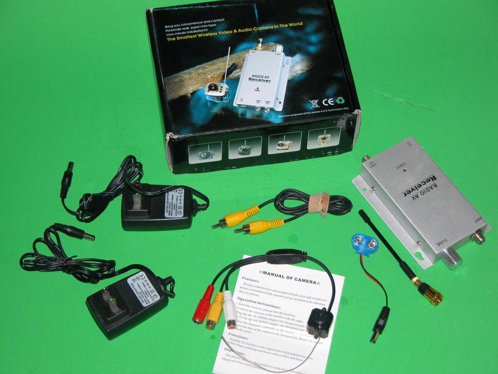

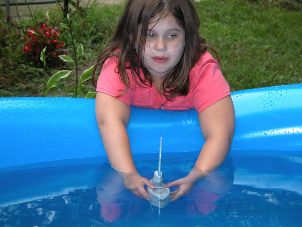

    Here is my installation of the camera within the 1/16 Wallace Kits KAIRYU Suicide submarine. The little Swann camera-transmitter is enclosed in a little 1.25" Lexan cylinder, its antenna running up within the single periscope. The camera lens peeks out through the forward observation dead light at the leading edge of the sail.

    Not that Rose is checking the video feed from the remote camera with a small TV monitor -- you would substitute the virtual goggles, Mark.

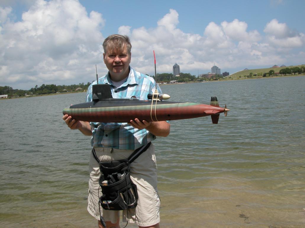

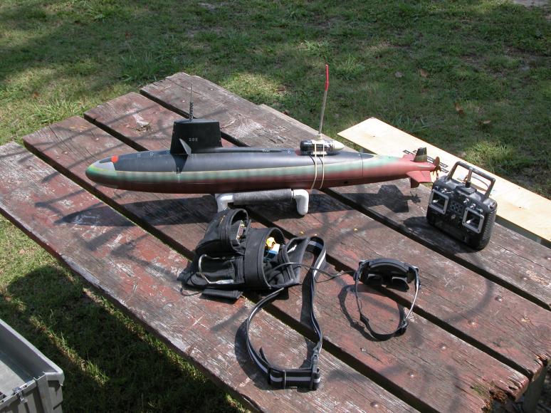

    Below are some shots of the system married to a 1/72 SKIPJACK r/c submarine. As you can see, the camera-transmitter is simply strapped atop the model -- as long as its antenna is above water (which it is as long as the model remains at or above periscope depth -- you can see all the action through the virtual goggles, no sweat.
