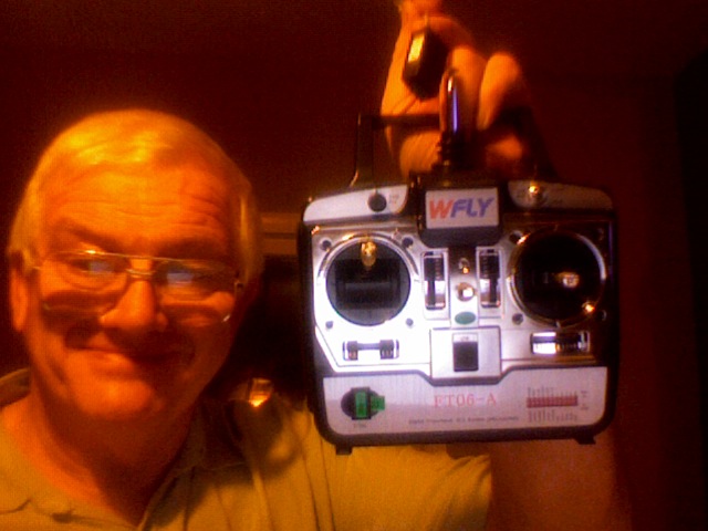

                              I have 'em! 40mhz 6 channel! WFLY!
                              Who wants one?
                              Methinks I should throw one in Slats next order. I need a good revue and bribery works every time!
