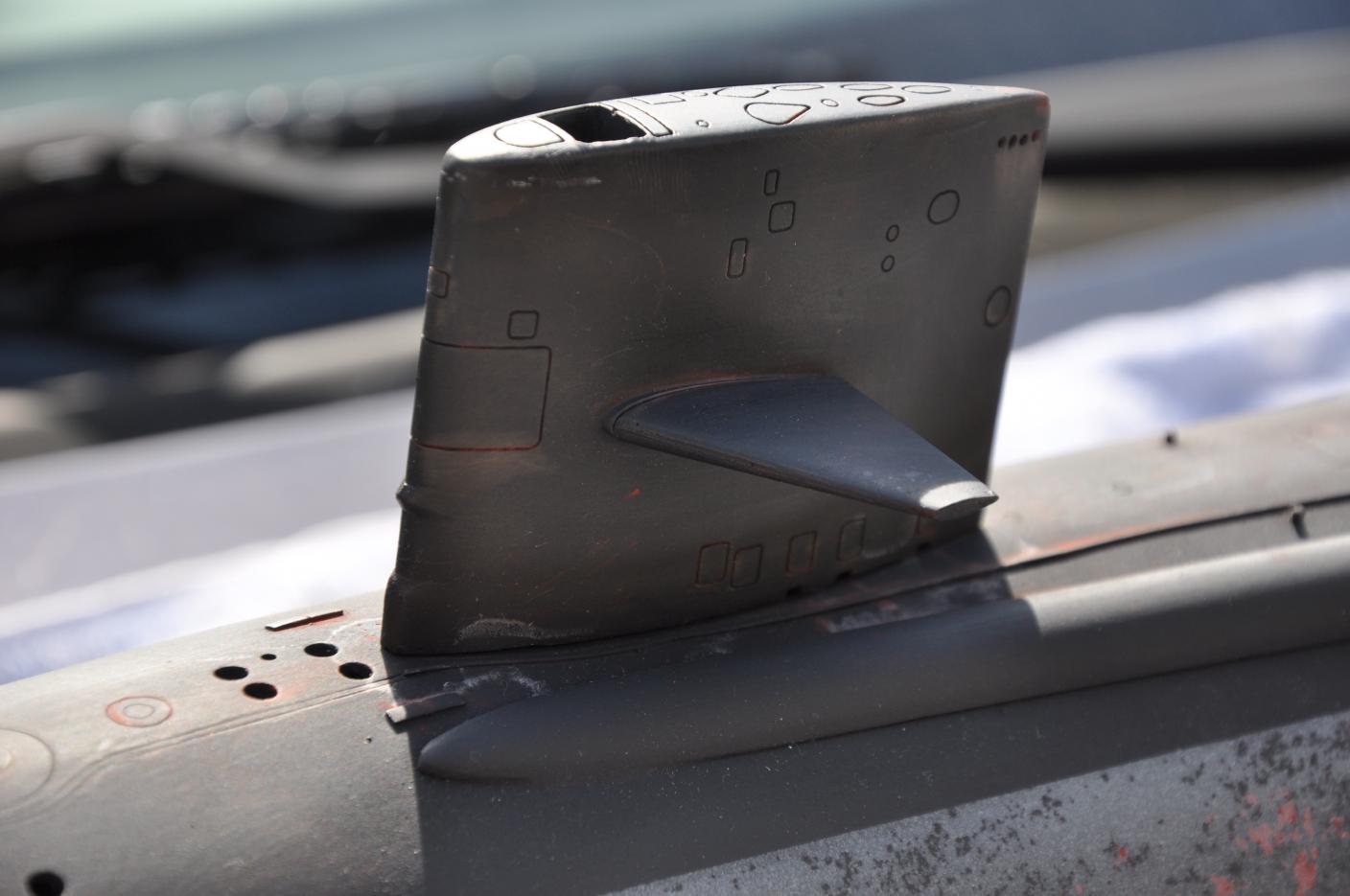

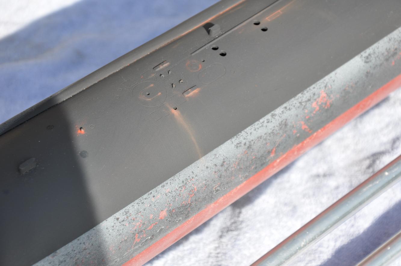

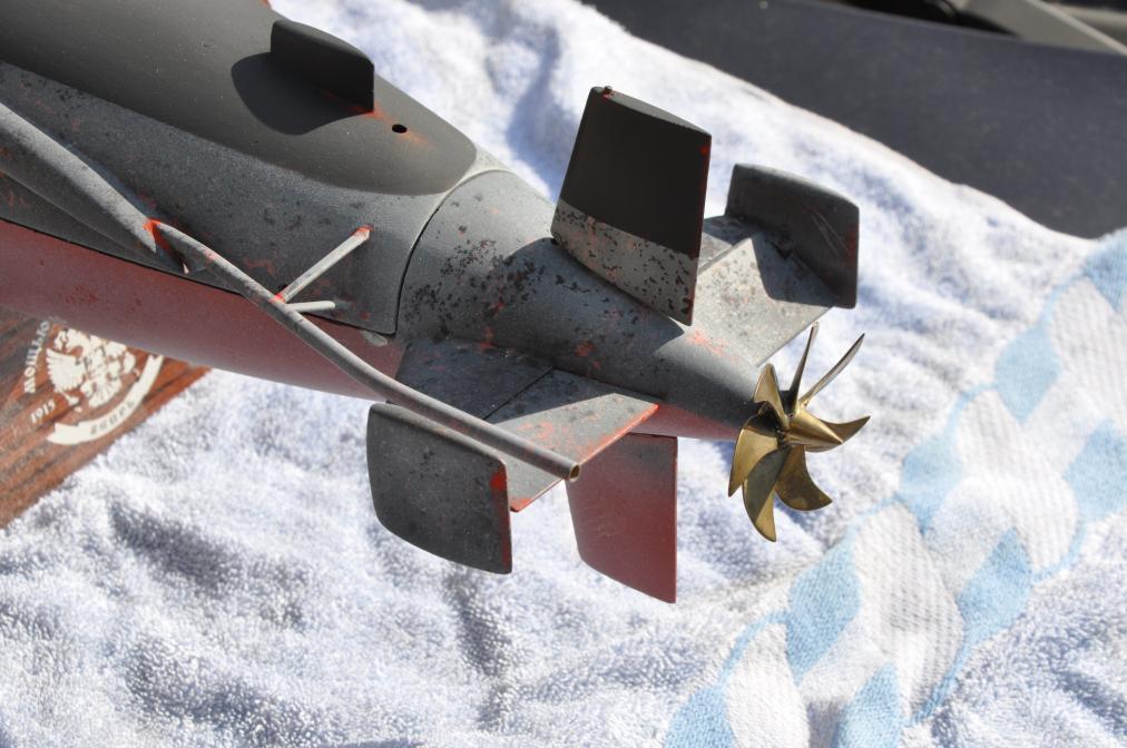

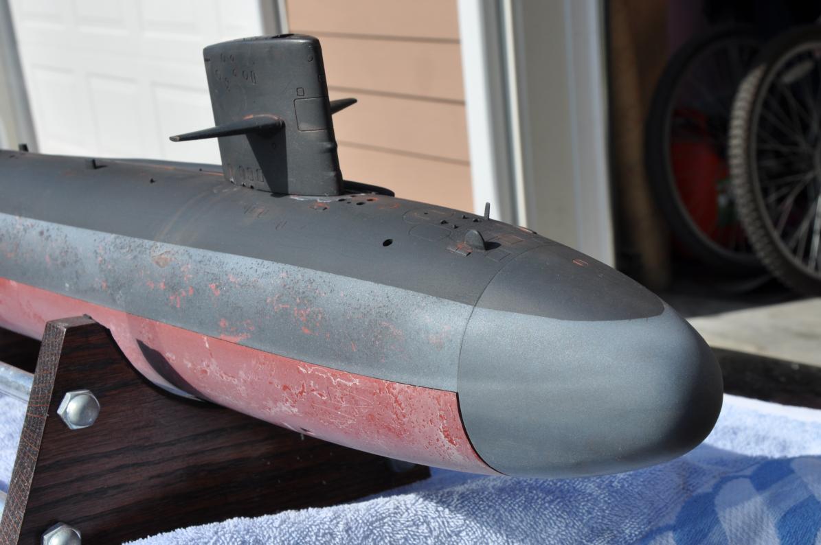

    Did some painting on my 1/96 USS Pogy today. I also tried out a new weathering technique I learned from one of my magazines that uses salt to create wear spot. I think it worked pretty well.
    All you do is paint your base color. Was water over the hull. Use a brush to put table salt over the hull. Let is dry. Paint your top coat. Wipe away the salt.
    I think it is a little over stated and might add a clear coat to the bottom to help soften it up a bit. I havent decided what I am going to do. It does look like Neptune took a dump on it though :)
    I also need to finish wiping off some of the salt residue. Next I will add the draft markings and slim ring.
    I think your salt was a little to coarse. Put it into a coffee grinder, and mush it up smaller, then, instead of brushing it off, simply immerse it in water and dissolve it. I think that would soften it up quite a lot.
    • Nuke Power
      Banned
      • 277
      It would be hard to get it mush smaller without it just dissolving onto the boat when the water is on it. I do not think disolving would make a difference but you are welcome to try. I am going to wash it now and then hit it with flat primer. Ill then buff the paint with a cotton shirt and see what I get. It wont be as pronounced once the veggitation gets put on aswell. News at 11
