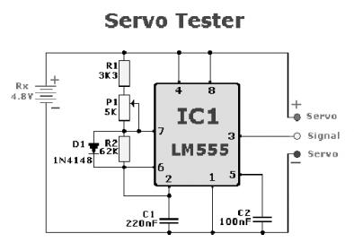

    If anyone is interested in building one, this is the schematic of the servo-tester:
    It uses a 555 timer IC, pot. P-1 has a knob on it that adjust thru the full servo travel.
    Current meter on power-supply is used to monitor the amount of current required by servo, or a multimeter in series could be used. Using a battery is not recomended, since it's not constant enough. The 555 circuit itself only draws about 5.milli-amps, which would be subtracted from total current.
    Click Pic:
