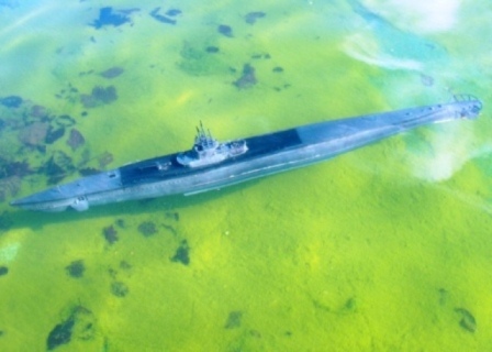

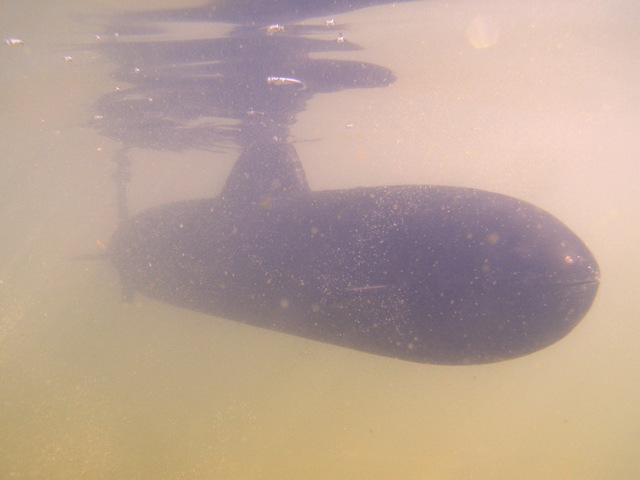

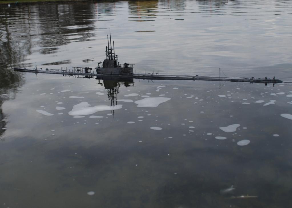

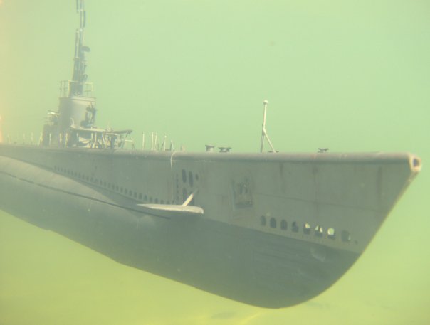

    Took this today at the local pond, water clarity was actually gin clear but you'd never believe it!
    Oh, it's an Akula.

    I certainly hope you're not drinking Gin that look's like that! :D
    A camera shows All, doesn't it.
    Except for your great sub, that is. :o

          It was clear - honest!

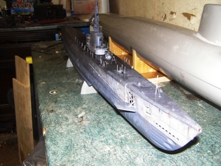

            Tell us more about your GATO there, VANGUARDUK.
            • VanguardUK
              • 58

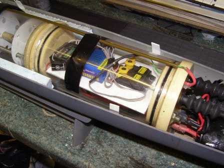

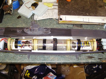

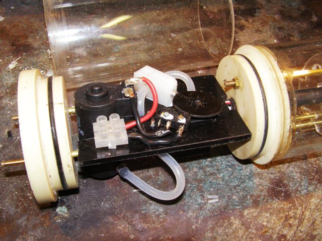

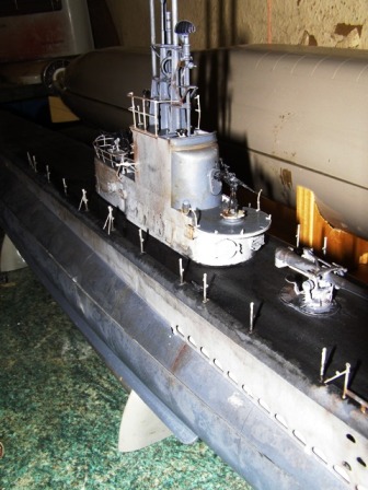

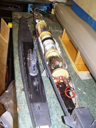

              This is my Take on a Revell Conversion, After looking through your original Cabals on the old SP site, I followed some of your ideas – drilling out the Prop frames, Losing the top weight & rigging the after control surfaces etc, I even stuck with the original Kit prop’s & threaded them.

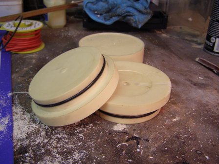

              The WTC is 80mm Lexan Tube with turned Resin End Caps & O rings.Decided to stick with what I know & went for a water tank system & screen washer pump, one thing I did was to put a small resvoir tank in the bow to increase the water capacity.
              She’s powered by 2 200 motors which is way to powerful & a down grade will be on the refit list – linked up to an 8.4v Nicad pack , this powers the drive & the pump.
              Both motors & Batteries are stored in the wet.
              All very simple really.
              The waterline is a little low, but I can live with it for now, it is after all a Submarine – if I wanted a target I’d build one!
              Biggest issue from initial runs, seems to Trapped air under the casing - more holes needed I think, possibly aft of the Deck Gun & behind the screen on the conning tower.

                A couple more
                  • 13987
                  Nice work. You didn't overdo the weathering, I like that -- good ballance. How many seasons do you think you'll get out of the wet motors?
                  • VanguardUK
                    • 58
                    Thanks, I dont like "new" boats but it's easy to overdo the weathering, especially on later boats.
                    Ref: Motors, Depends really, I tend to run in fresh water & based on that I reckon 2 or 3 seasons as long as they get regular maintainence, they're stowed in 35mm film cannisters packed with grease & so far so good, I should think that running her in a chlorinated pool would shorten the life though. Not sure if it helps, but as a matter of course I run them up on the bench for a couple of minutes after a run - I reckon this helps expel any water & gives everything a good lube up.

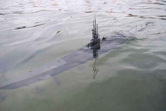

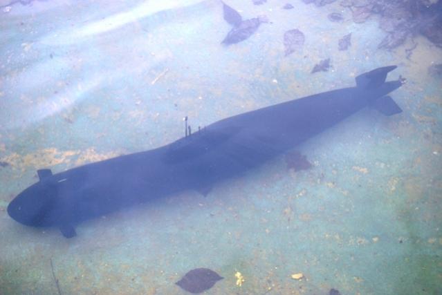

                            My Favourite Shot so far
                            • Capt. Don
                              • Jan 2009
                              • 5
                              I actually like this shot. It looks realistic.
