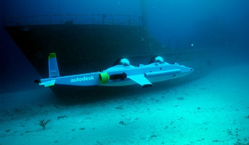

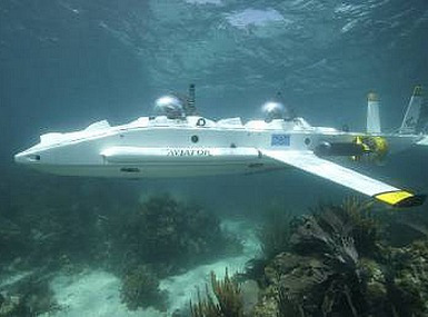

    I really want one of these, neutral bouyant, no balast, dynamic divers. Fly underwater, yank and bank turns, just like an airplane. No balast means no roll in the turns due to centrafugal force balast shift. Full size would be great, but a 1/4scale model is feasable. Click image for larger version

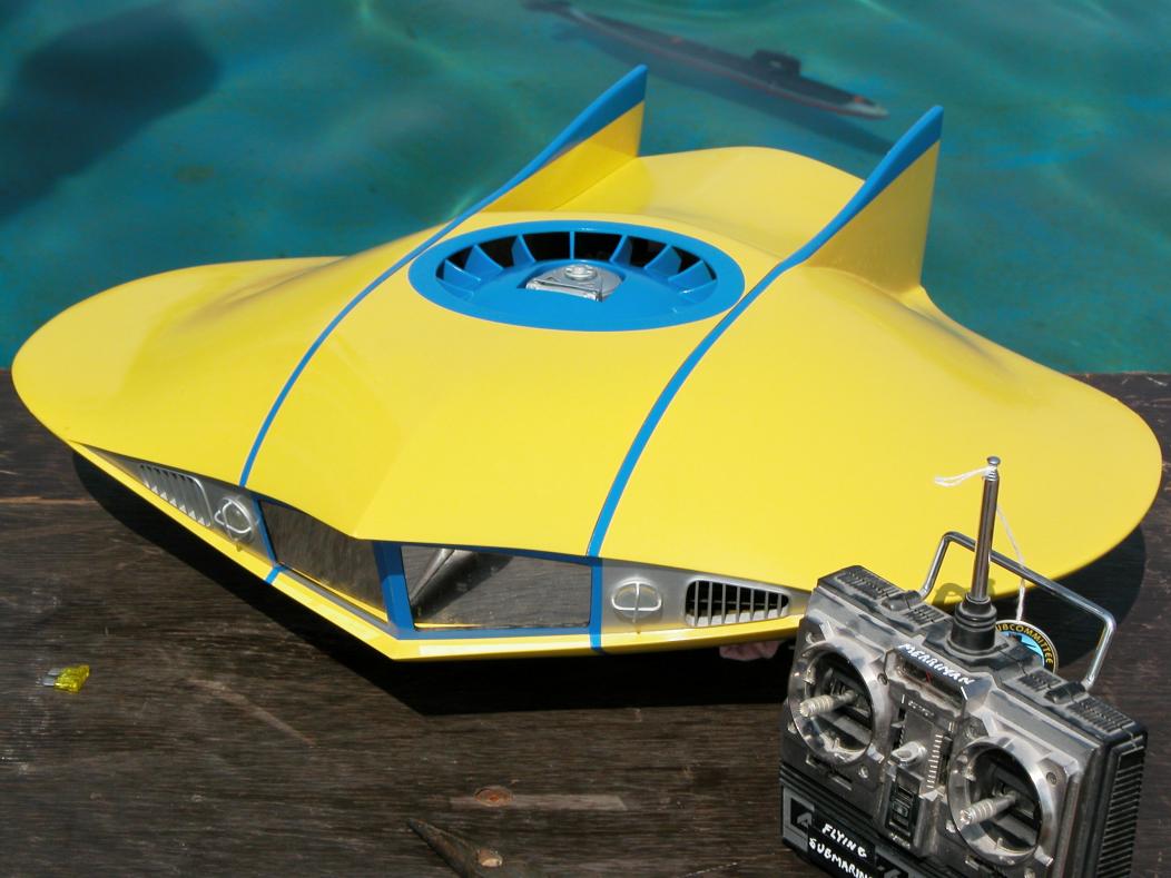

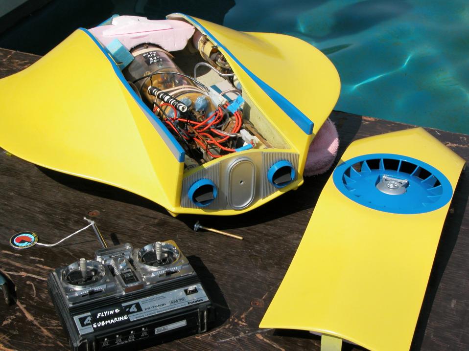

ID:	103570then theres the real flying sub(model)Click image for larger version

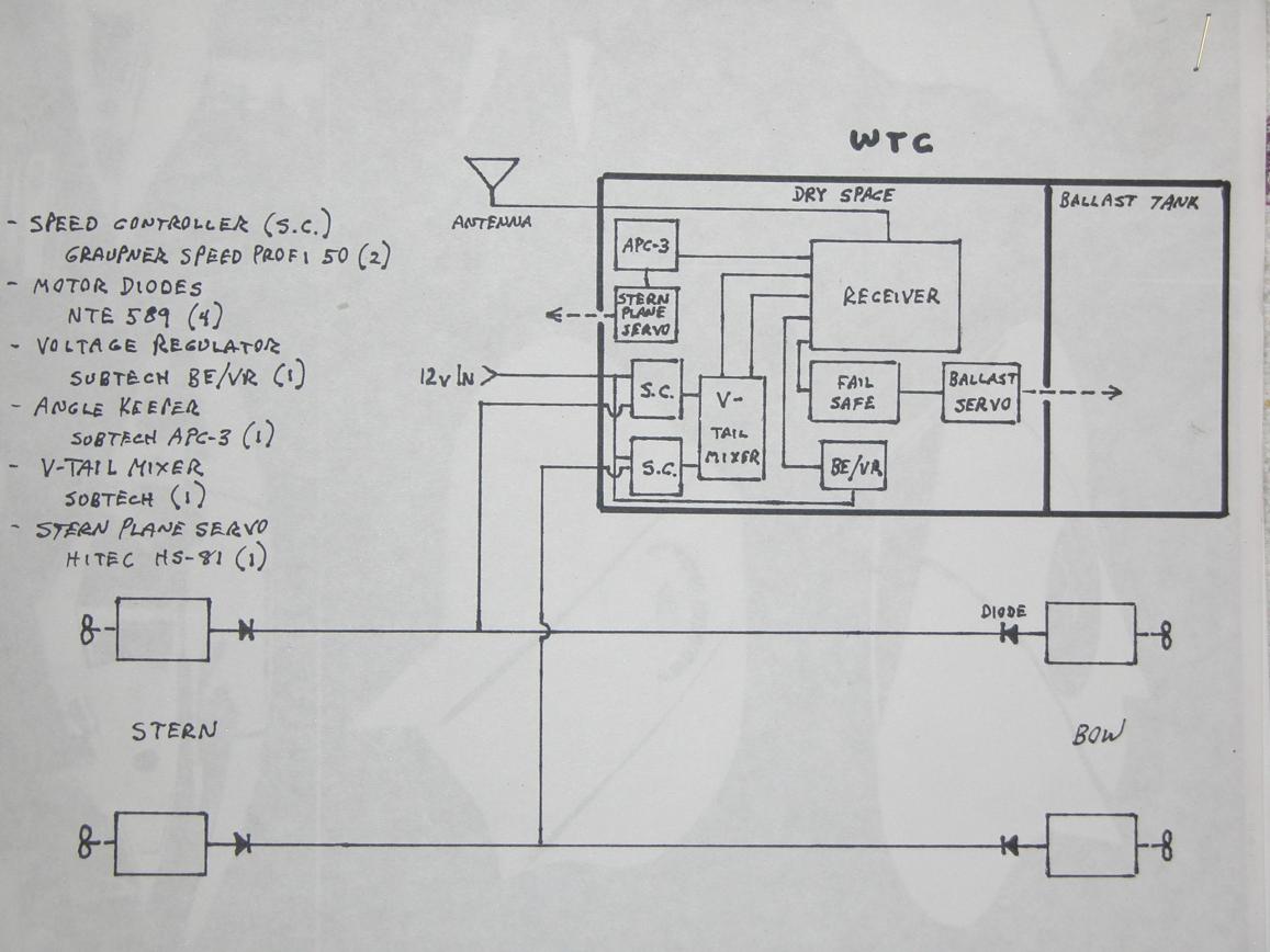

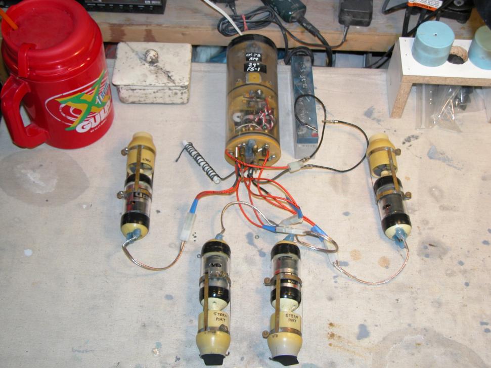

ID:	103571the Manta looking protrusions forward are the canard elevons. Flying and diveing pitch control. No idea about the power source, but definately integrated turbine thruster.

      DEEPFLIGHT SUBMARINE SUPER FALCON MARK II
      For Your Eyes Only may not rank as one of the better Bond films, but it did feature a pretty cool submarine that attacked Agent 007 in the film. Now, the man who created that sub has come up with a new personal luxury submarine, and you don’t even have to be a supervillain to enjoy it (but it helps).
      The Deepflight Submarine Super Falcon Mark II by Graham Hawkes is 17 feet long and seats two, with each person getting their own bubble-glass cockpit. Oh, and it goes for $1.7 million. The craft can dive up to 400 feet, and its wings on the side and stabilizers in the rear will keep you (or your very rich uncle) steady as you look for mini-Titanics.

        saw Hunter Ellis fly one of the operating Deep Flight Falcons painted like a blue angles Fa 18. He said operating it is just like the F18 but slower response. Falcon II's are pricey for sure, but there are other one off designs for the solo diver. sone are not powered but towed by a surface vessel, that atr real cheap and easy to build.

          Norbert Bruggen does a great kit of the aviator in 1/8th scale.
          Roll is generally a function of hull shape, and appendages like the fin/sail. Some systems which maintain an exposed water surface can contribute to instability, especially if inadequately baffled.

            True Andy, and the same guy (Graham Hawkes) who designed the real Aviator has designed the above one see http://www.deepflight.com/ (me: drooling like homer simpson and making Gurgle noises).

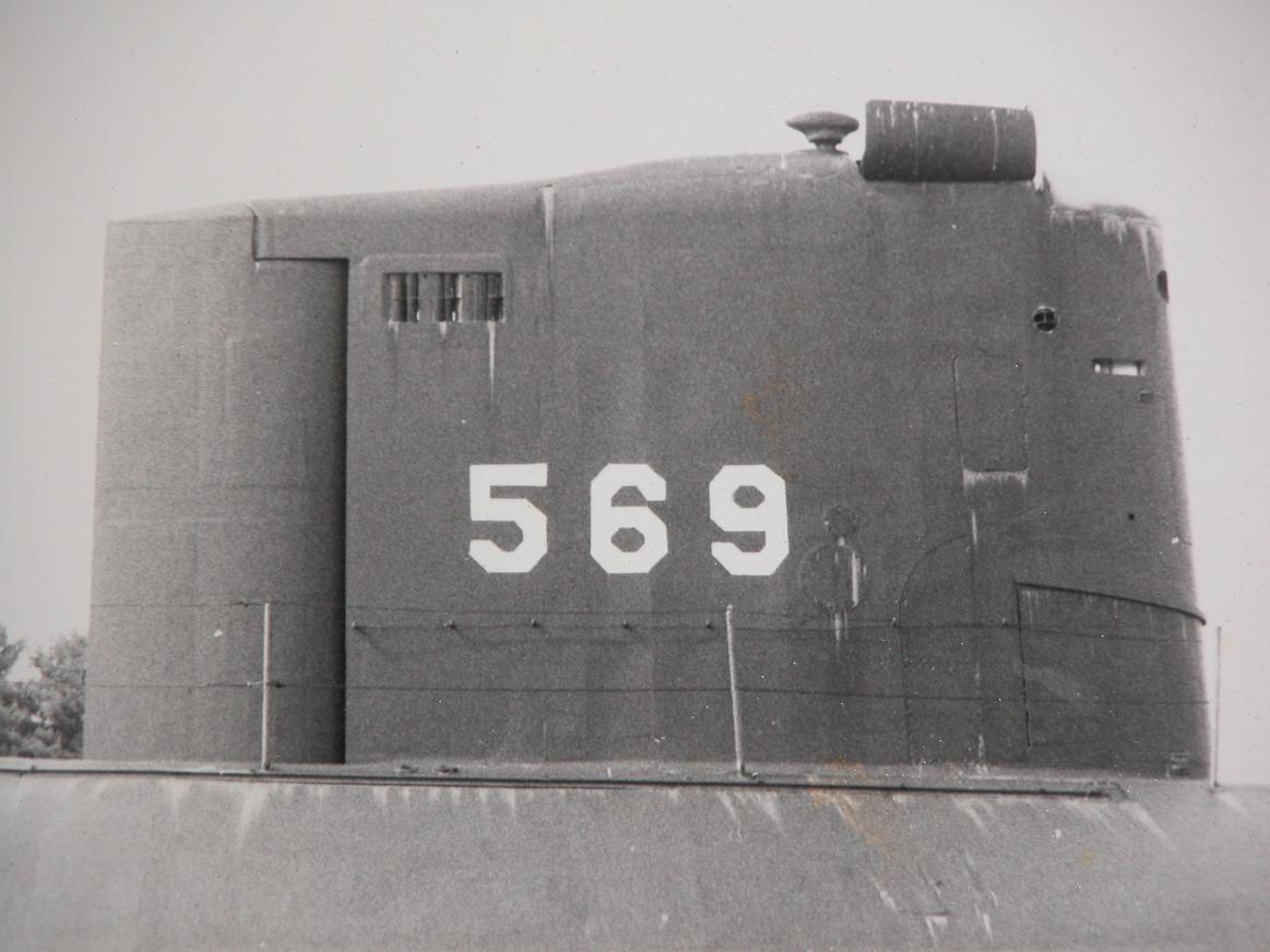

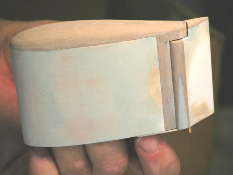

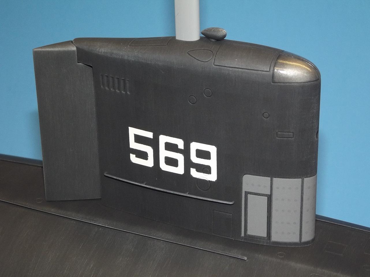

              An active (reactive to roll) control surface to fight the inboard roll is presented here.
              By the way, the inboard roll of a conventionally configured modern submarine (excluding snap-roll phenomena) to a turn is exclusively owing to the force exhibited by the sail.
              Here's a means of killing the sail rolling moment:
ID:	98889Click image for larger version
ID:	98890 Click image for larger version
ID:	98891 Click image for larger version
ID:	98892 Click image for larger version
              A dorsal rudder. As employed on the USS ALBACORE.
              Watch the video. https://www.youtube.com/watch?v=DhAG-7W_5kA https://www.youtube.com/watch?v=TSr41K5Uaj4
              The models dorsal rudder is active. Note that even in the tightest underwater turn the boat does not roll into the turn.
              But, there is a bad side to everything: the dorsal rudder produces A LOT of drag, which slows the boat down when not running straight. But, then again, fish-tailing the rudder with an active dorsal rudder does a great job of putting on the breaks -- something nice to have in our bag of ship-control tricks should you suffer a stern plane casualty.
