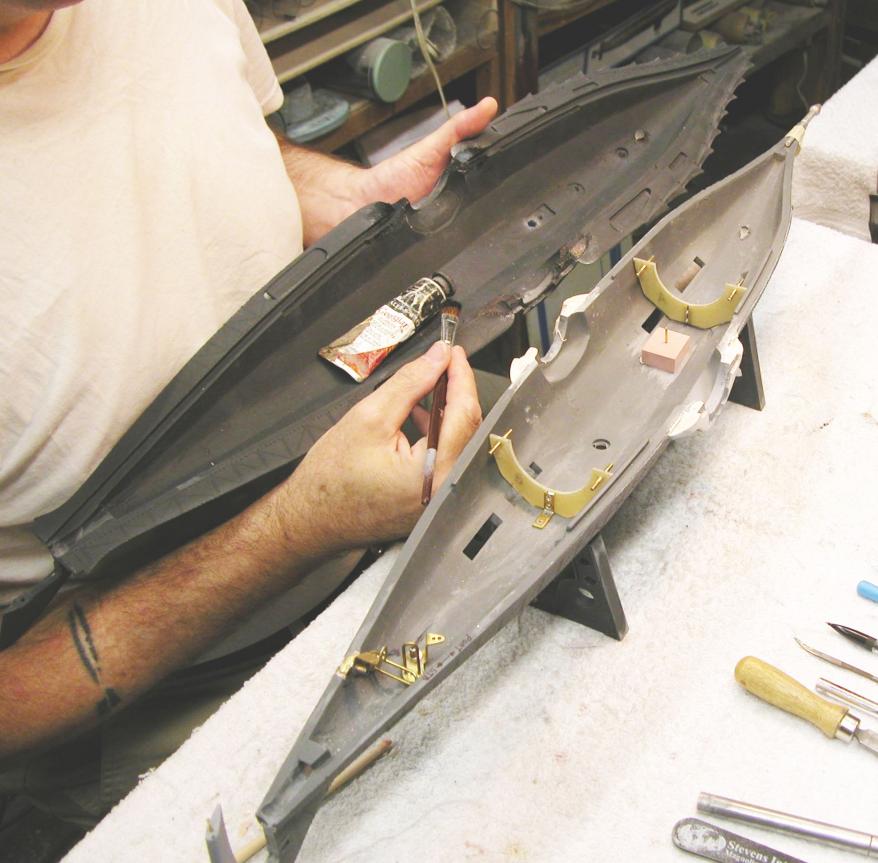

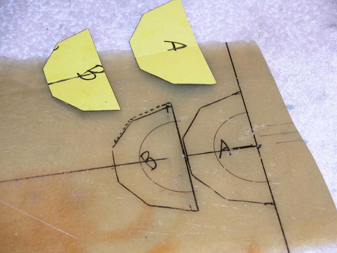

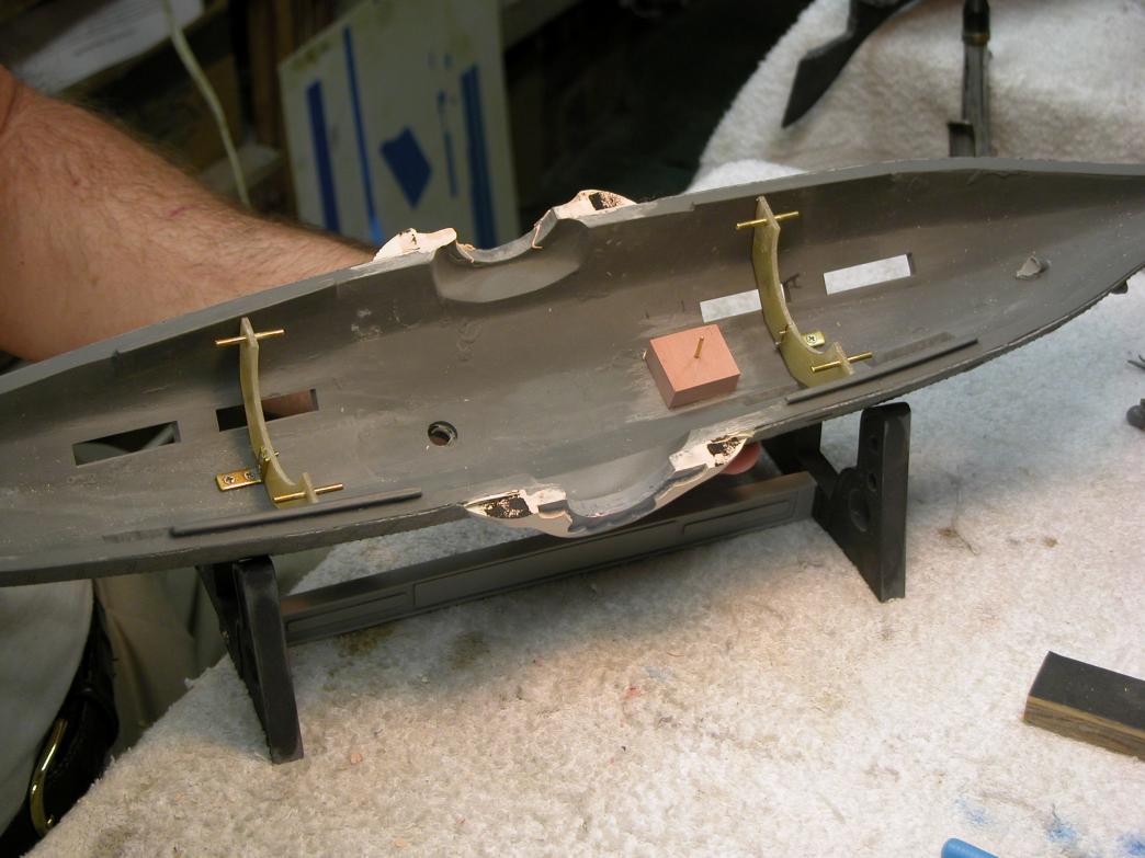

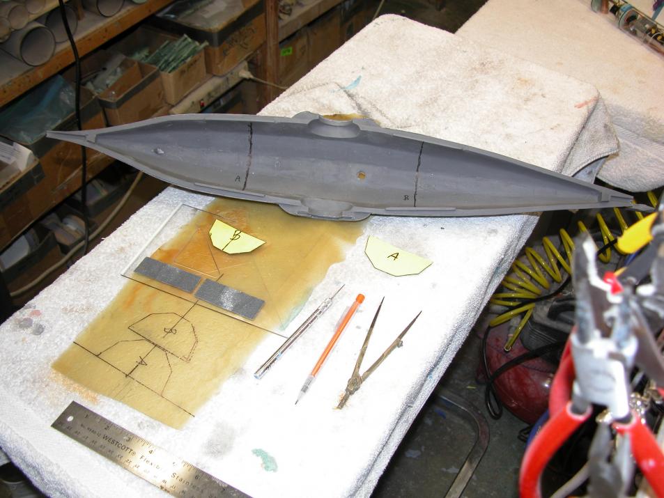

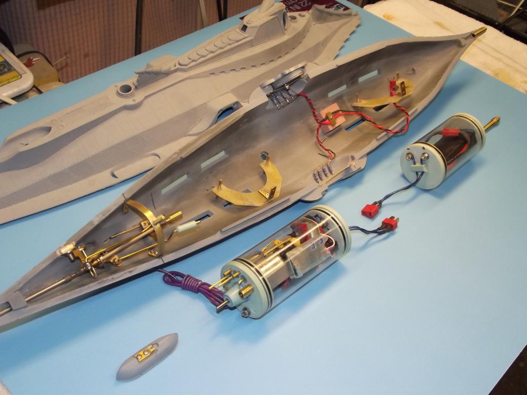

    No, not yet, John. I was thinking of G-10 GRP sheet cut to concentric circles. Kinda like I did here on this 31" Brodeen NAUTILUS:
