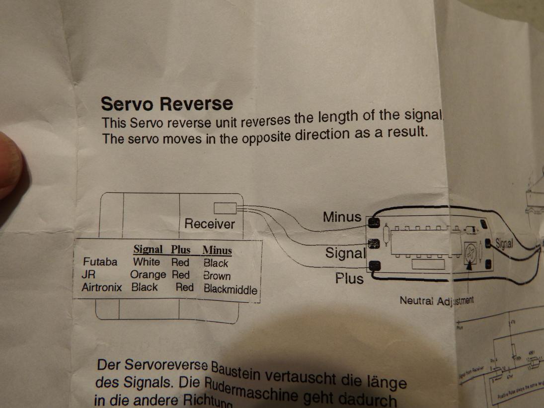

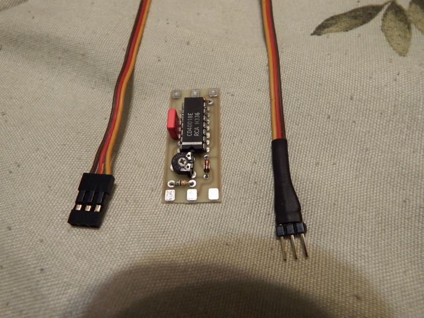

Times Up! Well Im still looking for suggestions but this is another way: Servo reverser
