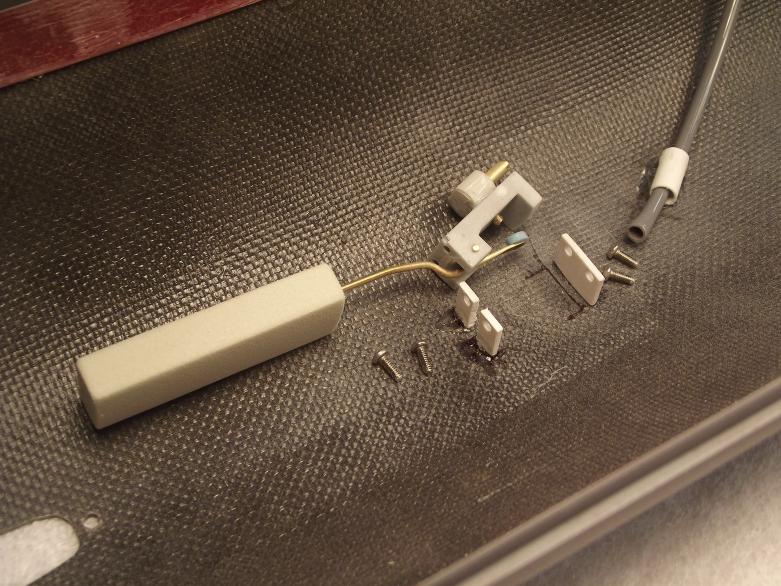

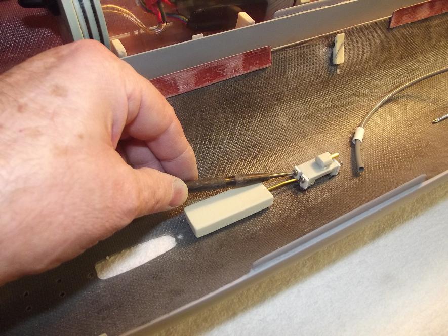

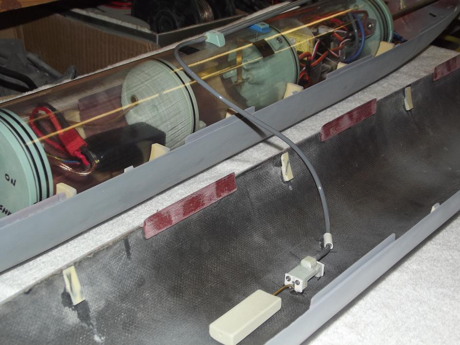

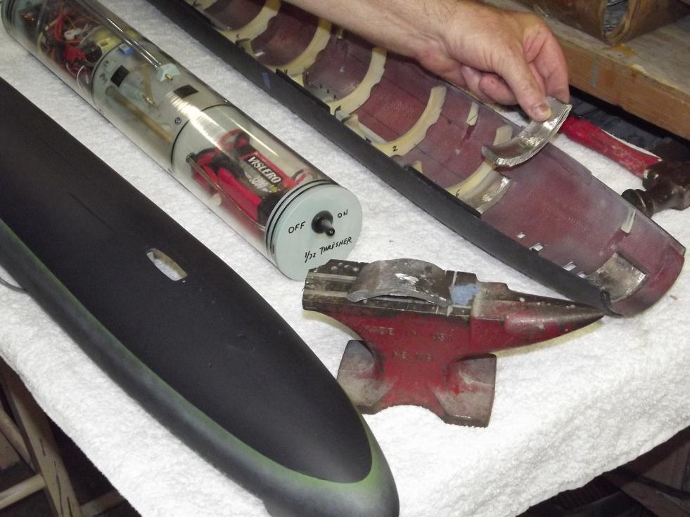

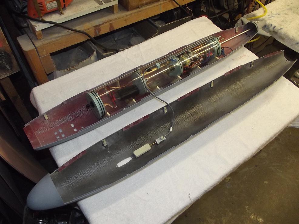

          I got it to work in this big 1/72 PERMIT/THREASHER model. Cake-walk in your narrow assed 1/72 LA.
ID:	91713Click image for larger version
ID:	91714Click image for larger version
ID:	91715Click image for larger version
ID:	91716Click image for larger version
          Note that the 1/72 PERMIT/THRESHER model has enough freeboard to permit the low mounted, horizontal type snorkel induction head-valve to work -- not so with your low freeboard LA. You'll have to use a vertical type snorkel assembly mounted high within the sail. I'll fix you up.

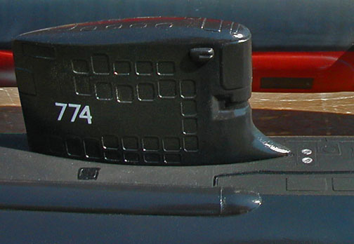

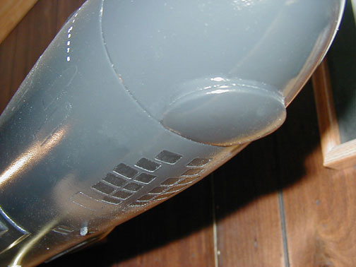

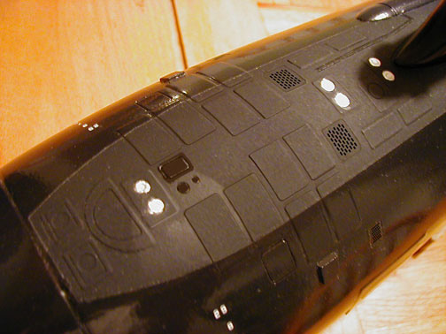

            Thanks Dave, I know I can always count on you. Im also very impressed with Pete Piekarskis Seawolf and Virginia models. Im trying to get a hold of him. Maybe hes out of business.Click image for larger version
ID:	91727Click image for larger version
ID:	91728Click image for larger version

                I was thinking the same thing myself about the prop. Youll notice that Pete gives us some upclose shots of the detail of his boats. I havent been able to find any of Shubars. I wonder if.......................
                  The Phone number(Pete Piekarski) from his website is "No Longer in Service". Hes also not answering the email. I guess that means No Virginia. If anyone knows how to get a hold of him, please let me know. Thanks
