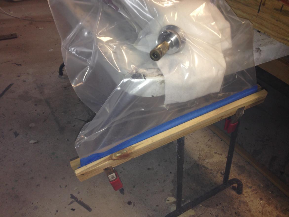

    Here you can see the bag and the airline going to the compressor. I sealed the end of the bag by folding over the edge placing some paper over it, and ironing it with a clothes iron.

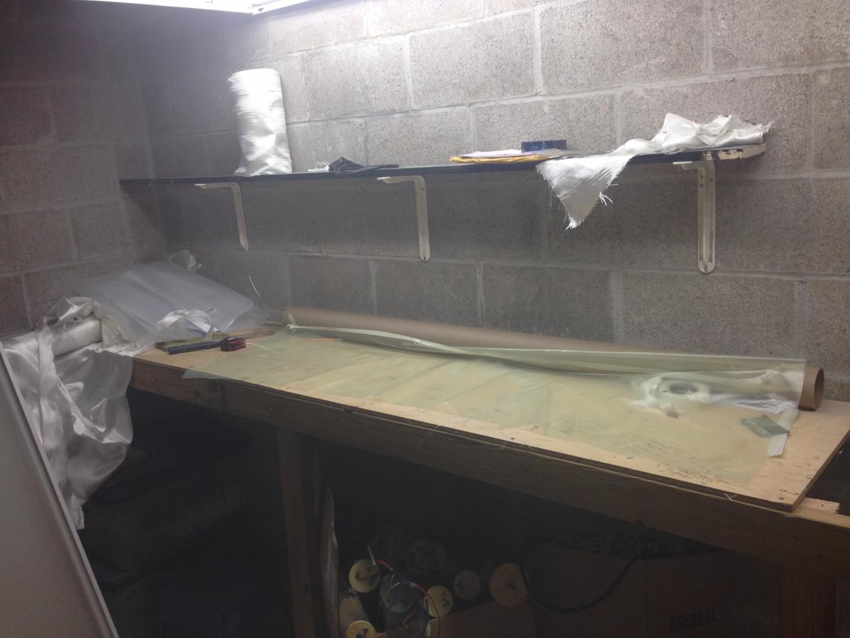

    Here's my clean table where I cut up the cloth etc.

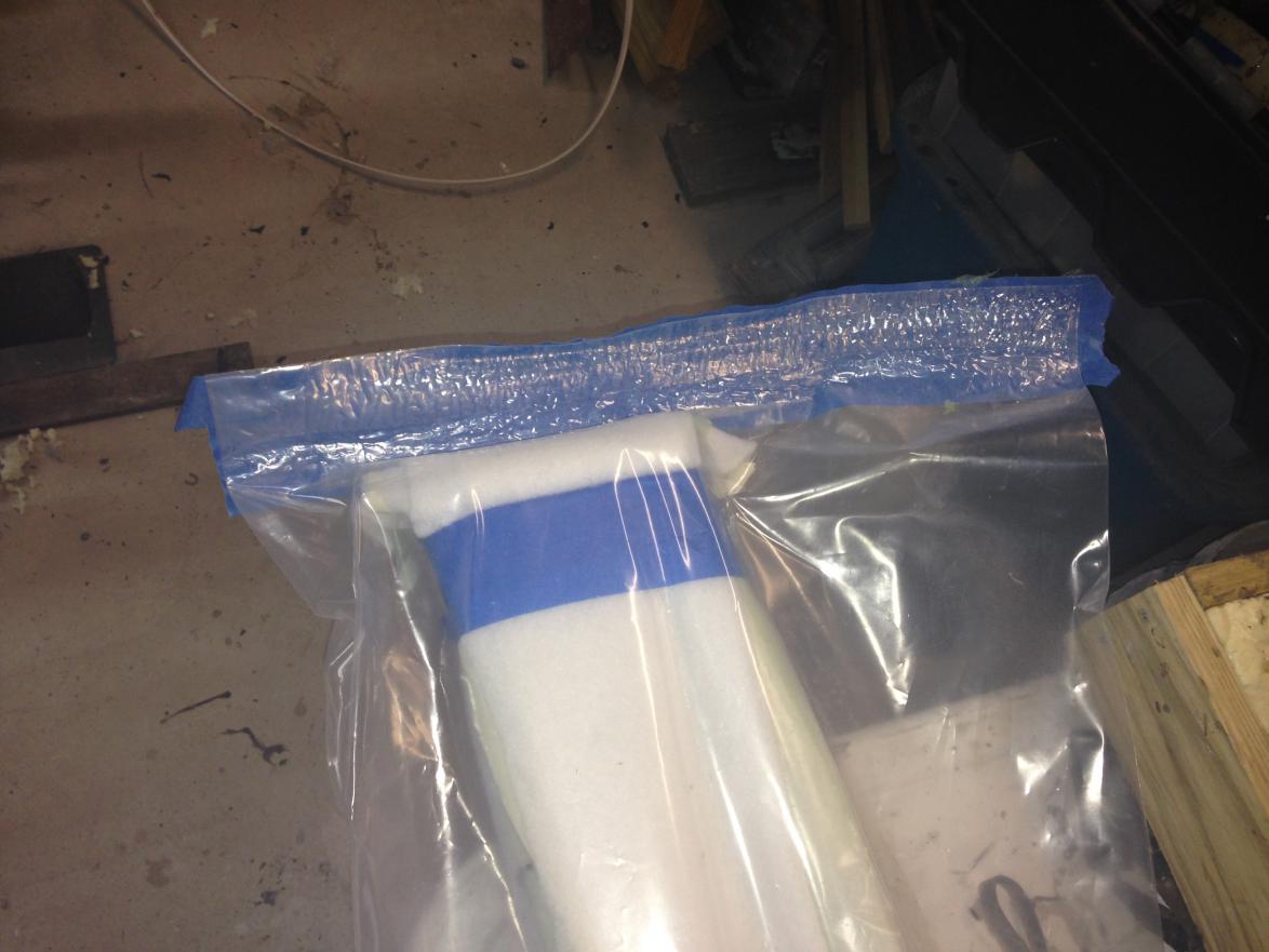

    Here, once I had the mold in the bag, I placed some caulk inside the open end, squished it together, then folded it over a couple of times. Finally, used tape to secure it and clamped it between two pieces of wood.

    The ironed end.

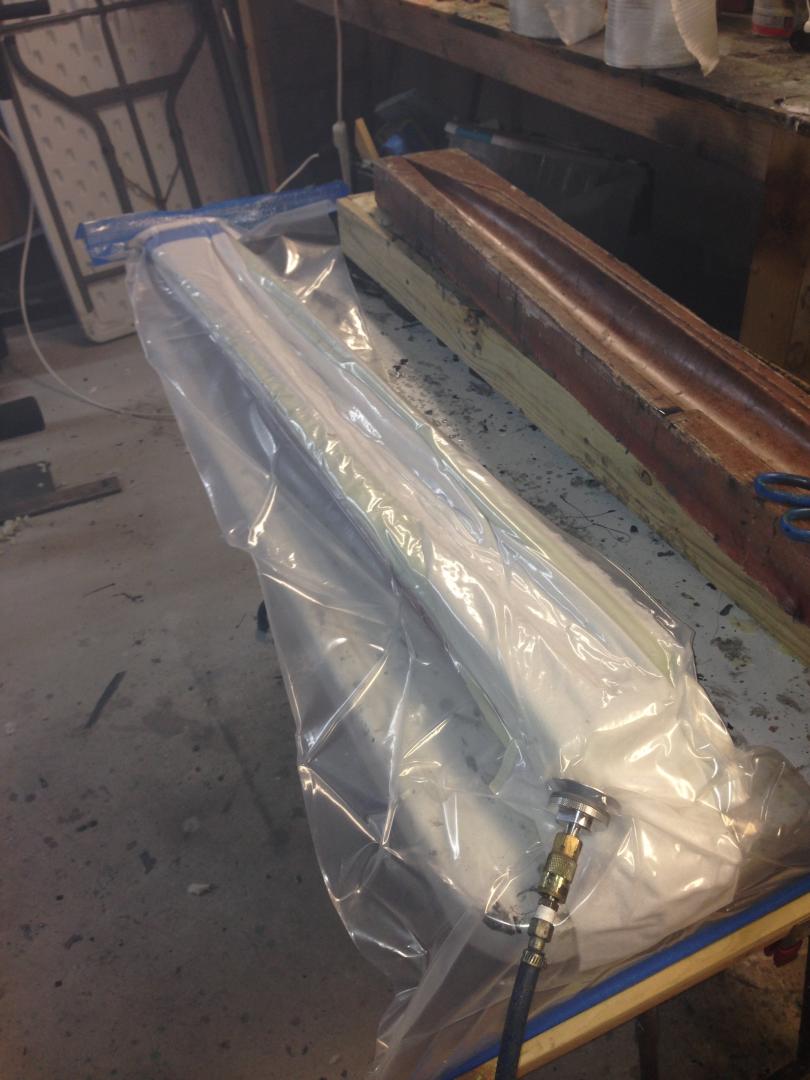

      I pulled the conglomeration apart to find numerous successes and a couple of failures.
      Firstly, No bubbles in the gel coat. (Well, I had two small ones) Major big deal!! Success!
      The finish was smooth and needed little work.
      Overall the resin and fiberglass was even. Resin had oozed through the bleeder film perfectly
      Much better result, and well worth the extra work. Actually, I thought this was quicker and easier than a normal layup method.
