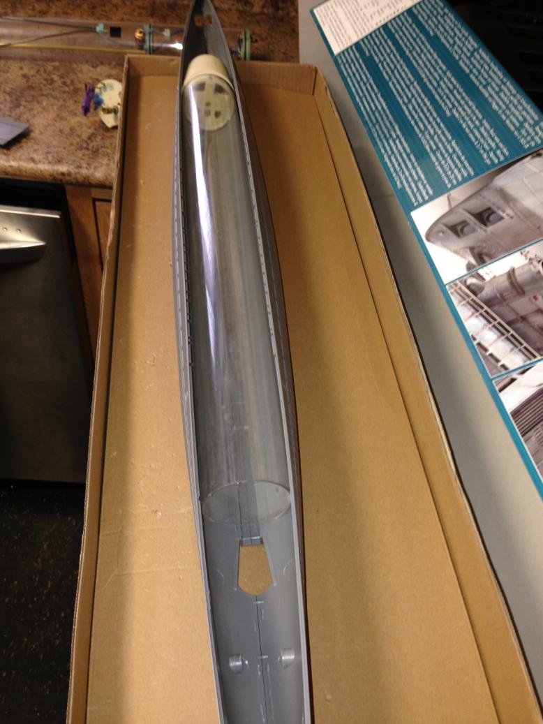

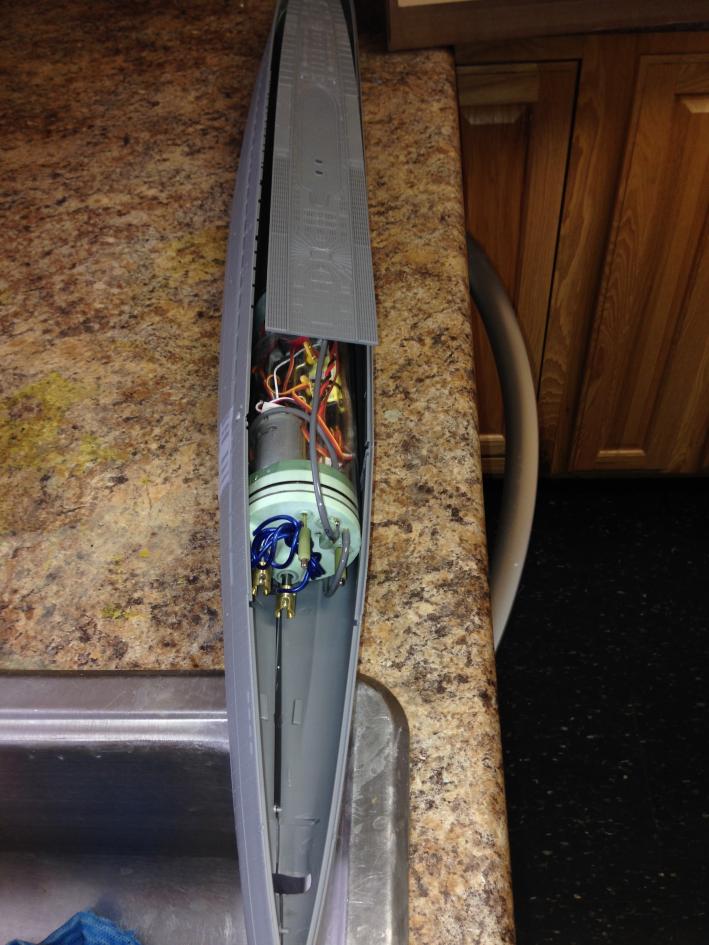

        Here's the Gato Sub-driver. It's too long by a mile

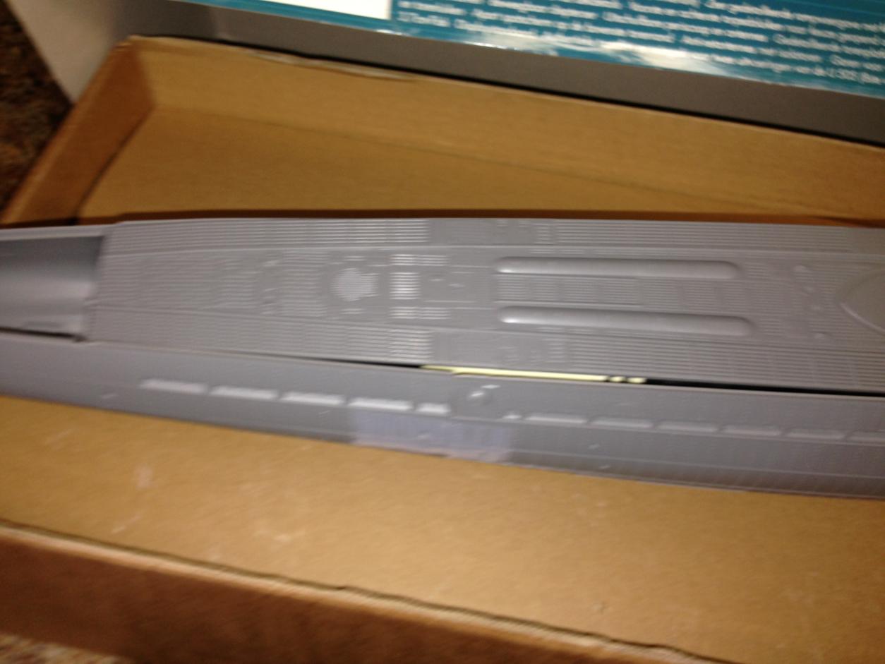

        The deck doesn't fit!

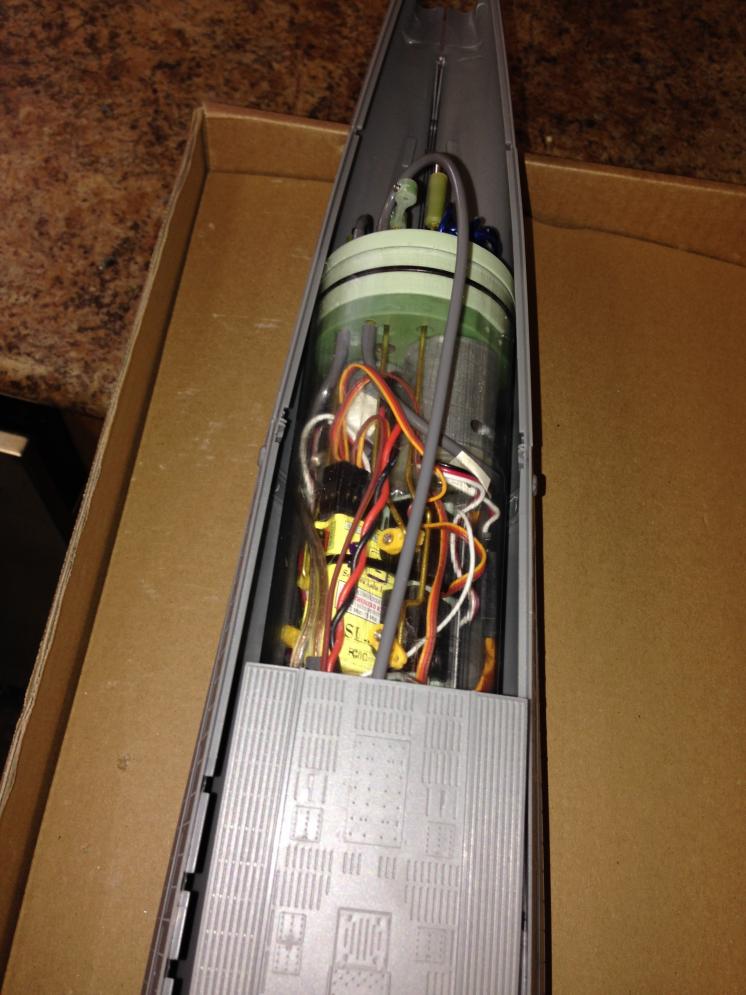

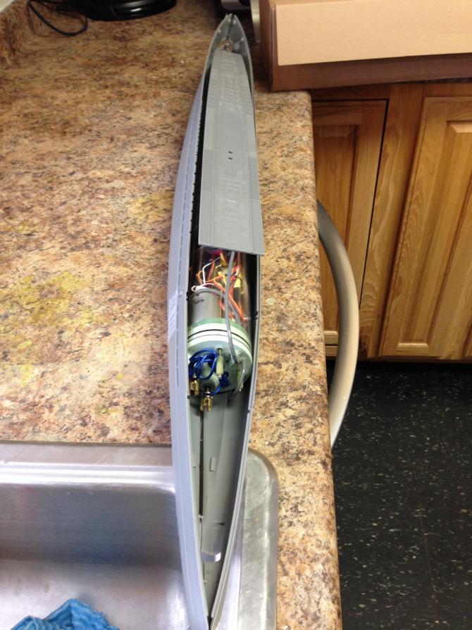

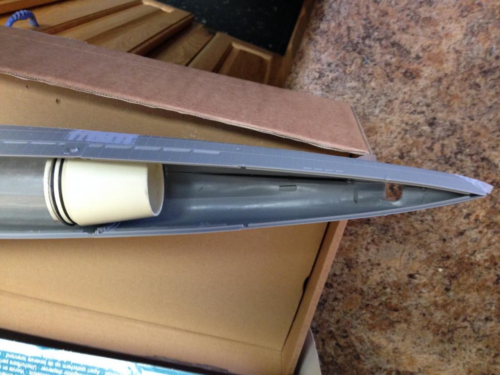

        I used a 20" piece of Lexan with the tapered Motor bulkhead at that fits in a treat. Hardly any effort to slip the unit into the hull.

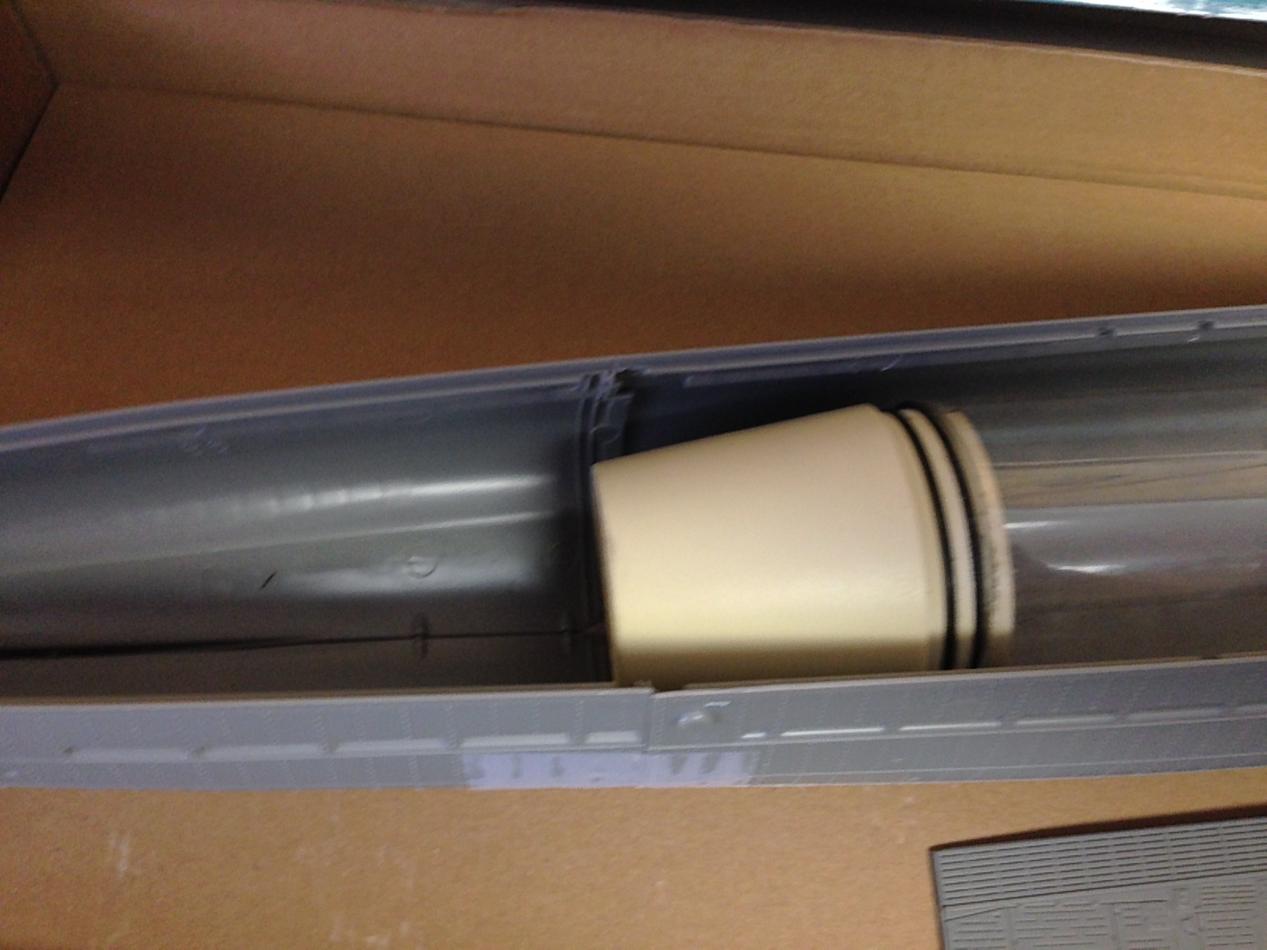

        Here's the tapered motor bulkhead I think will suit this model.

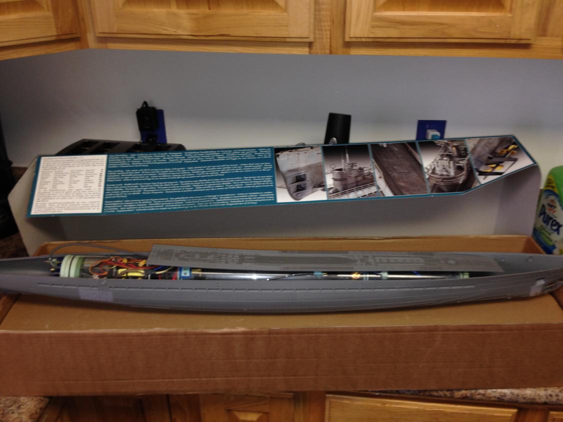

        You can see that the deck fits over it perfectly

        I suspect we'll have a sub-driver within a couple of weeks, and because Revell said we could copy the control surfaces, then this should be easy for HWSNBN -BUT leave him alone, no more ideas, requests, etc. He needs to focus! (Gawd! it's like dealing with a five year old who loved cookies!)
          • 13983
          Well, I think that the Type-9, at this scale, will have substantially less above waterline displacement than the GATO. That means a shorter ballast tank. If so, We can get the forward and after bulkheads away from the tight tapers at each end of this beast, and it will fit. But, if it turns out I need all that ballast tank to operate this model at the correct waterline, then I can adapt a tapered 'motor cup' to accommodate a single 380 motor working a gear-splitter. Won't know which way to take things till I have the kits in hand.
          THANK YOU, REVELL OF GERMANY!
