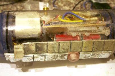

        The Type 23 that I have was built by Mike Dory. He used tire weights directly to the WTC.
        They are lead (the dimensions are 19mm x 17mm x 2mm) and use the adhesive backing that came with the weights (some were adhered with silicon).
Name:	Small World Models WTC_010.jpg
        I think on this sub, it was done that way because of the 32nd Parallels hull has a bit of a flex to it. The sub runs wonderfully with this setup (knowing it is not optimizing the metacenter). As you pointed out steel will be larger and this does not answer your rust concerns. Maybe an auto/tire shop can give you one to throw in a cup of water and see.

          I use the lead wheel weights similar to what trout shows when I need extra weight to balance out my subs. I picked mine up from tyre shops in Christchurch. Some I bought new but latter on, Tony's Tyre gave me a handful of used ones free. even when used the adhesive backing was strong enough to stick in place! If you need less than one square just cut with a pair of side cutters.
