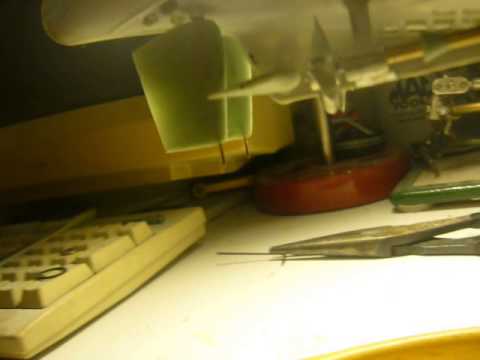

    controll rod linkages fabed up need adjustment on bow planes though...plodding forward on to the deckfoundations...dave in the pdf it shows the lenght but not the depth of the keeper positions.. am i right in assuming that the parralell the decklip about a 1/16th or so?
    • 14013
    Looking good. The keepers are so positioned to put the top face of the transverse deck support foundations in contact with the bobbom of the deck piece when it sits down within the hull, putting the top of the deck even with the top of the superstructure sides.
