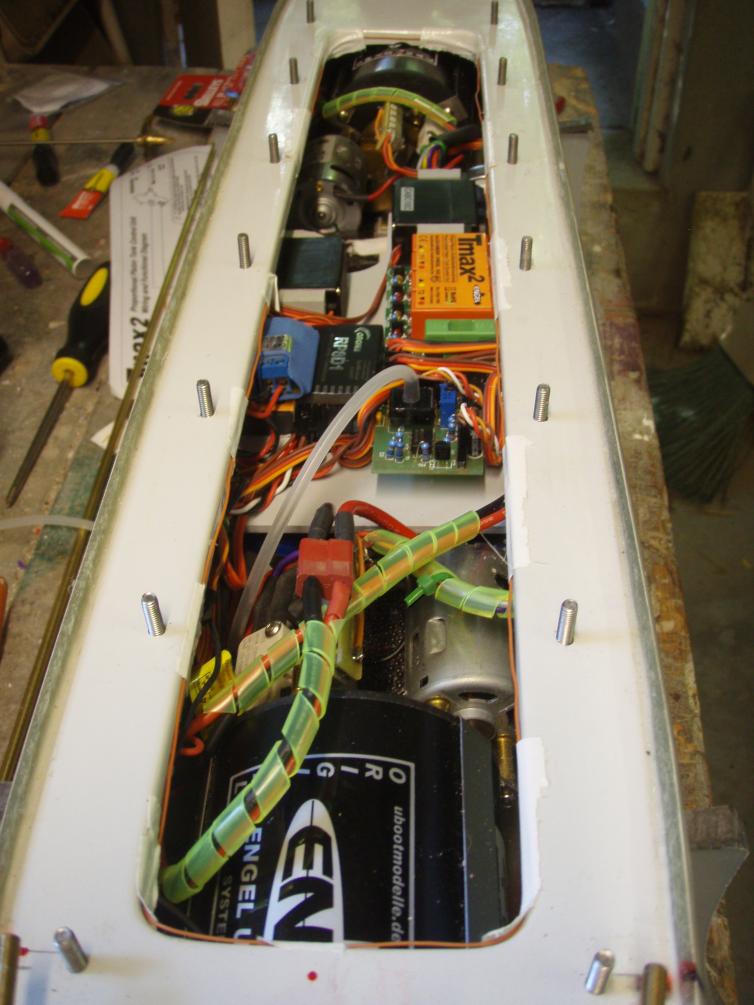

    Does anyone have a detailed knowledge of this thing? I'm attempting to breath life into an Engel Akula and so, I'm using an 8370 (12 +2) decoder to run the retractable bow planes and the periscopes. Unfortunately the two servo functions do not appear to be working and the switching function seems to be having a strange effect on Engle's RME module. Bollocks!

              Seems so... The thing works, up to a point but the servo throws are drastically reduced which results in the bow planes only extending about half way out (at which time the second servo gives a little kick). I've emailed Gregor and he's come back to me twice for more information but as yet it remains a SAMFU. Actually that should probably be SASFU.

                  Yes. I did a basic soldier's check on the whole thing to try to eliminate obvious mistakes and to isolate the problem. The servos work fine when used directly with the receiver; the same servos will not work when plugged into either of the two servo channels on the 8370. That suggests to me that the problem is in the 8370, however, Engle's instructions for using the 8370 in conjunction with their RME module call for the disabling of the memory or latching function in the 8370 by cutting a wire bridge; I've done that and I'm pretty sure that I cut the right bridge but I'm now wondering if that has something to do with the reduced performance.
                  The detailed information that I am looking for is the personal experience of anyone else using one of these things. Engel used to run the retract system with several micro switches before changing to their newer RME module and I wondered if anyone had experience of the older or the newer system. Right now I have an Akula on the bench and I can't put the mid deck in until I solve the retractable bow planes issue.

                          UPDate. The 8370 went back to Robbe and they reported that it was FRIED! Meanwhile the RME module went back to Engle and they reported that it is working as advertised and sent it back to me. Whilst I was waiting for it to come back I purchased a new RME and fitted it to the sub. Result: the new RME works; the old RME does not work and the 8370 is in the bin. Everything now works. Onward!Click image for larger version
