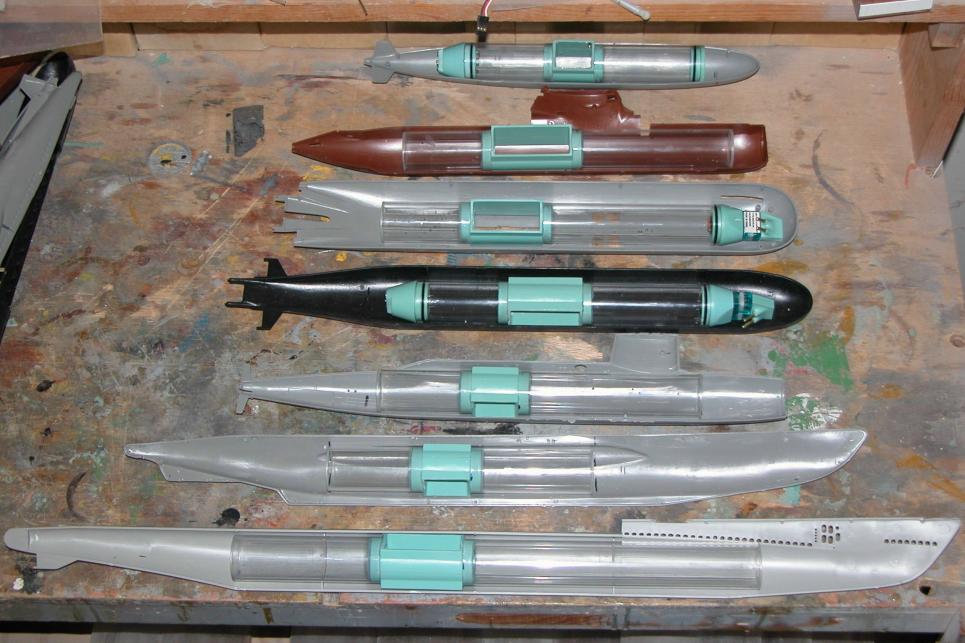

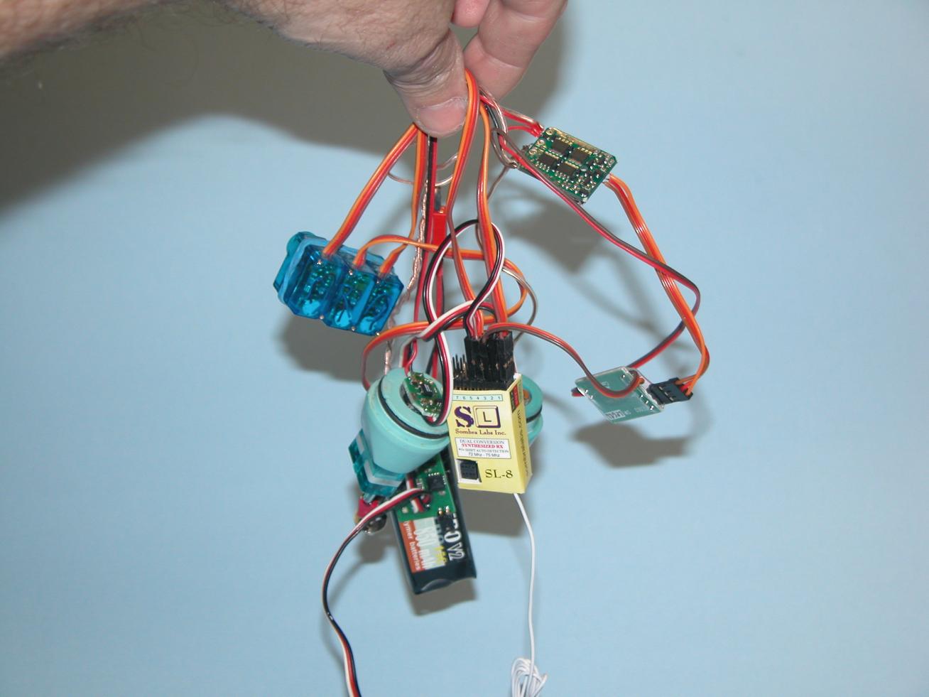

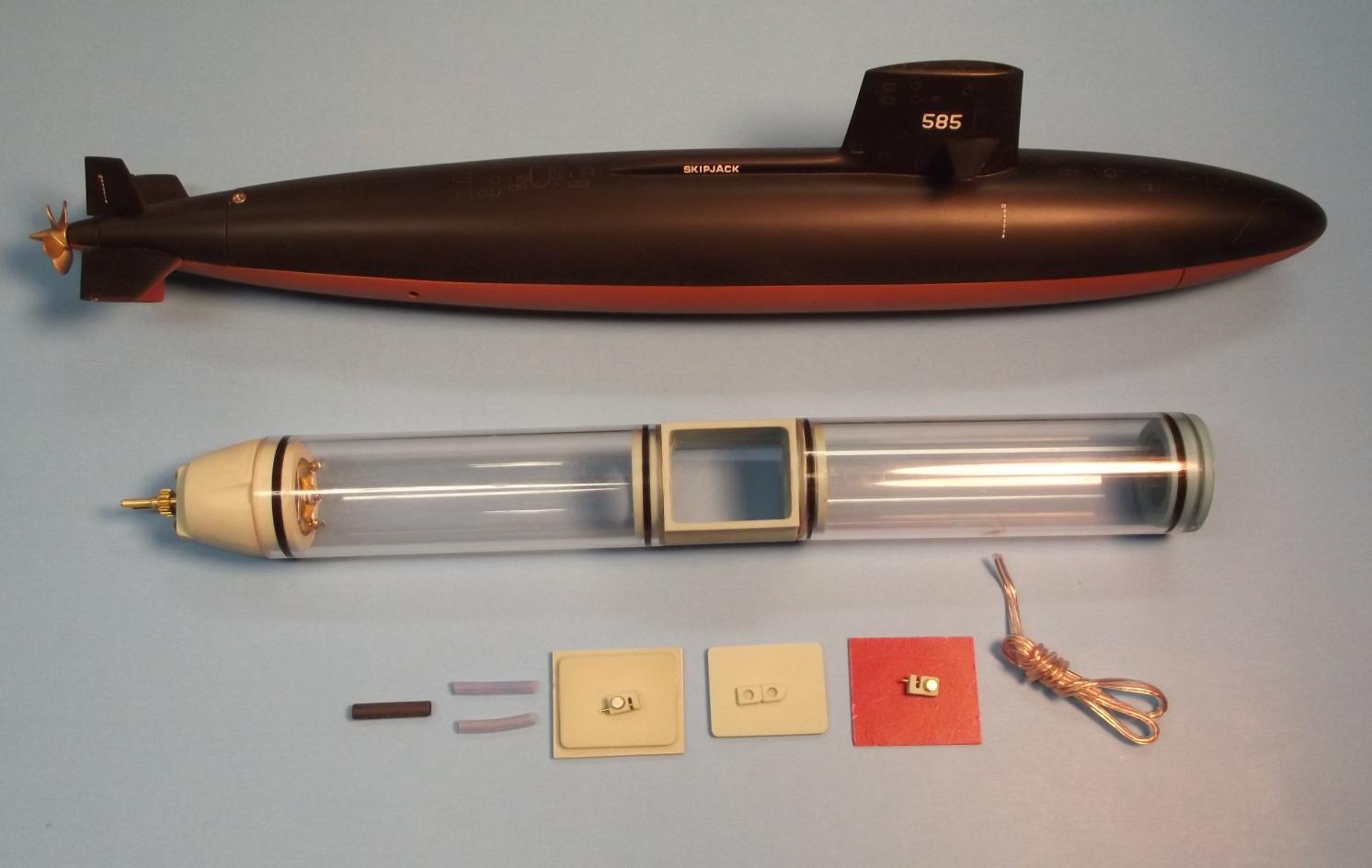

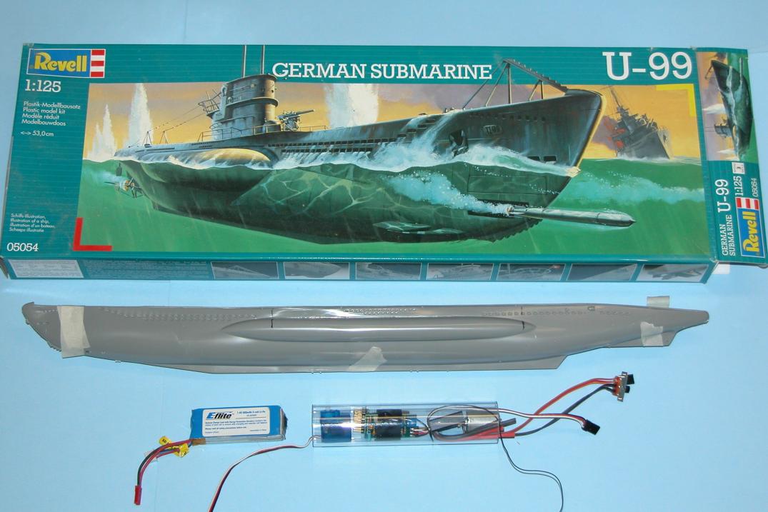

    I've just taken some shots for a brief informative article for the catalog. We're introducing a 1.25" Sub-driver kit that will permit built up and use of a non-ballast tank equipped r/c model submarine. We're aiming this product at those who want to assemble the smaller plastic model submarine kits and get them into the water.

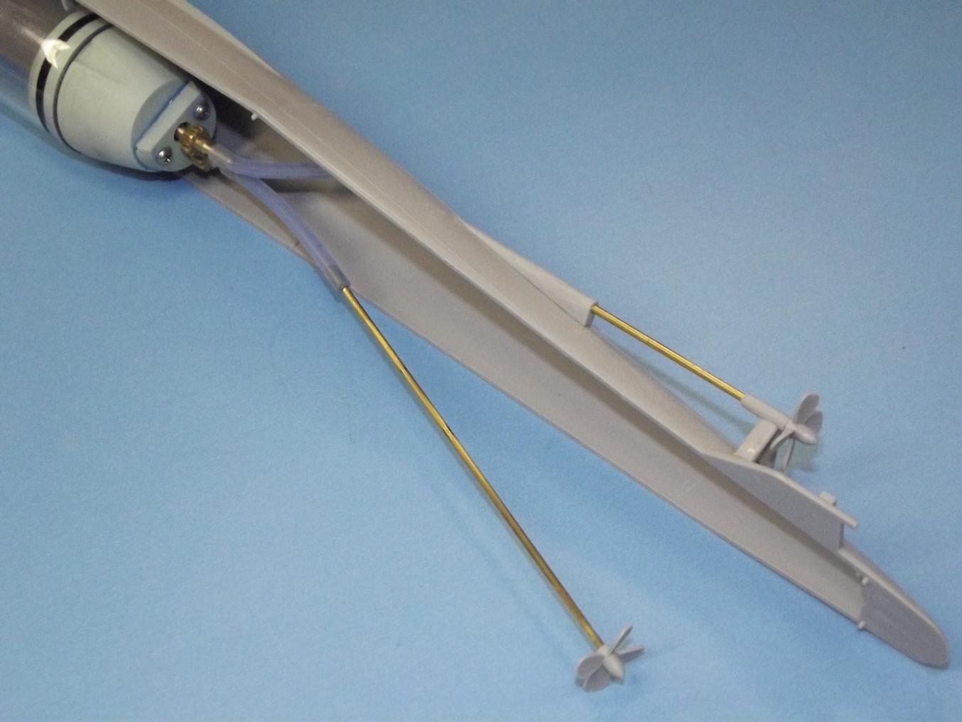

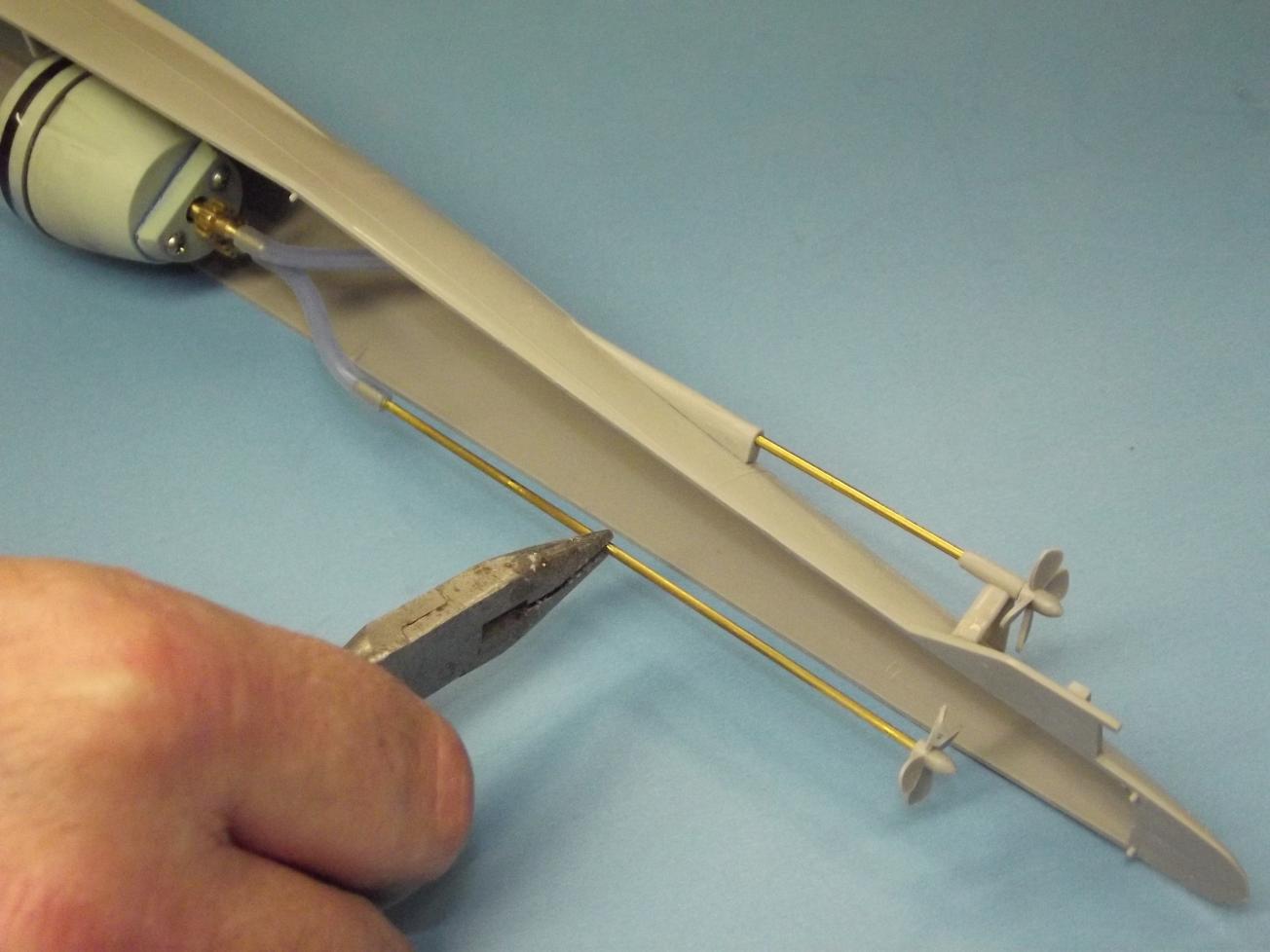

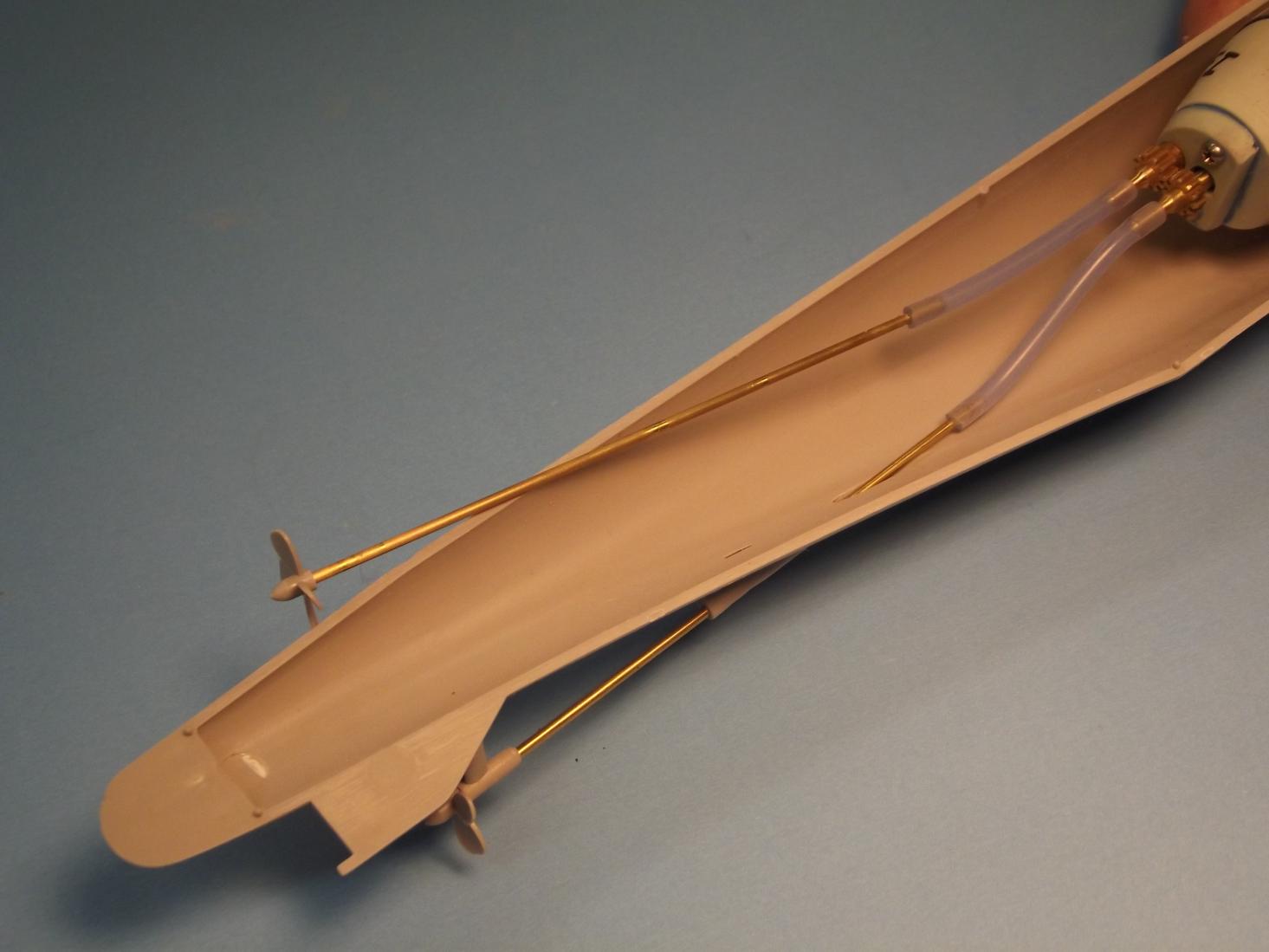

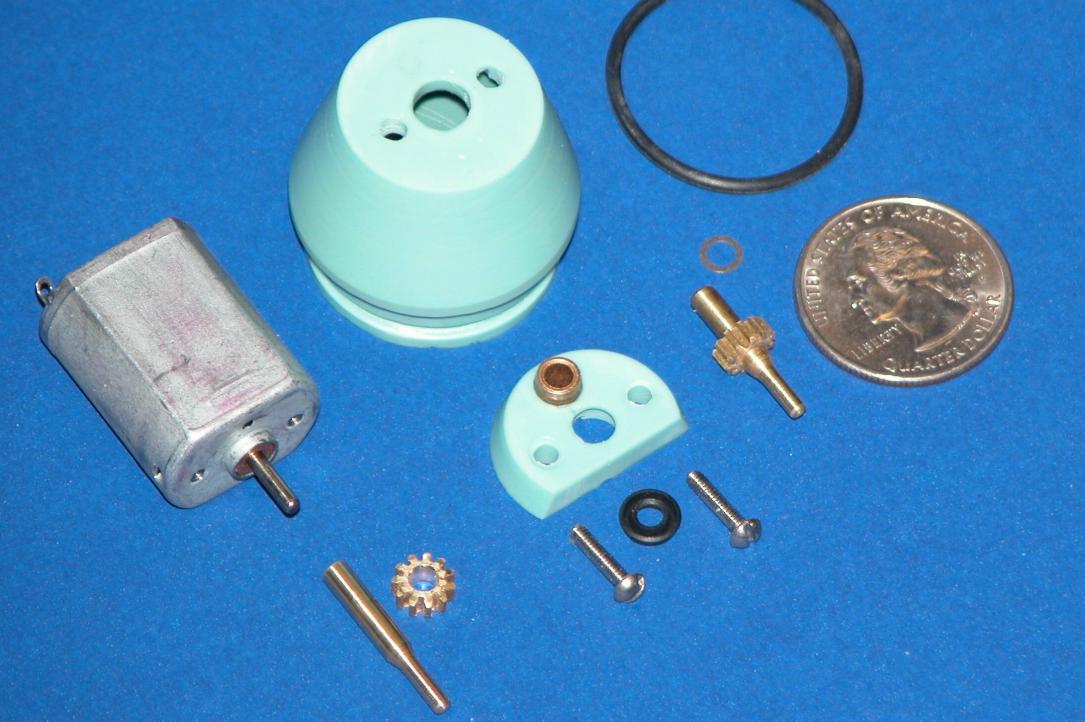

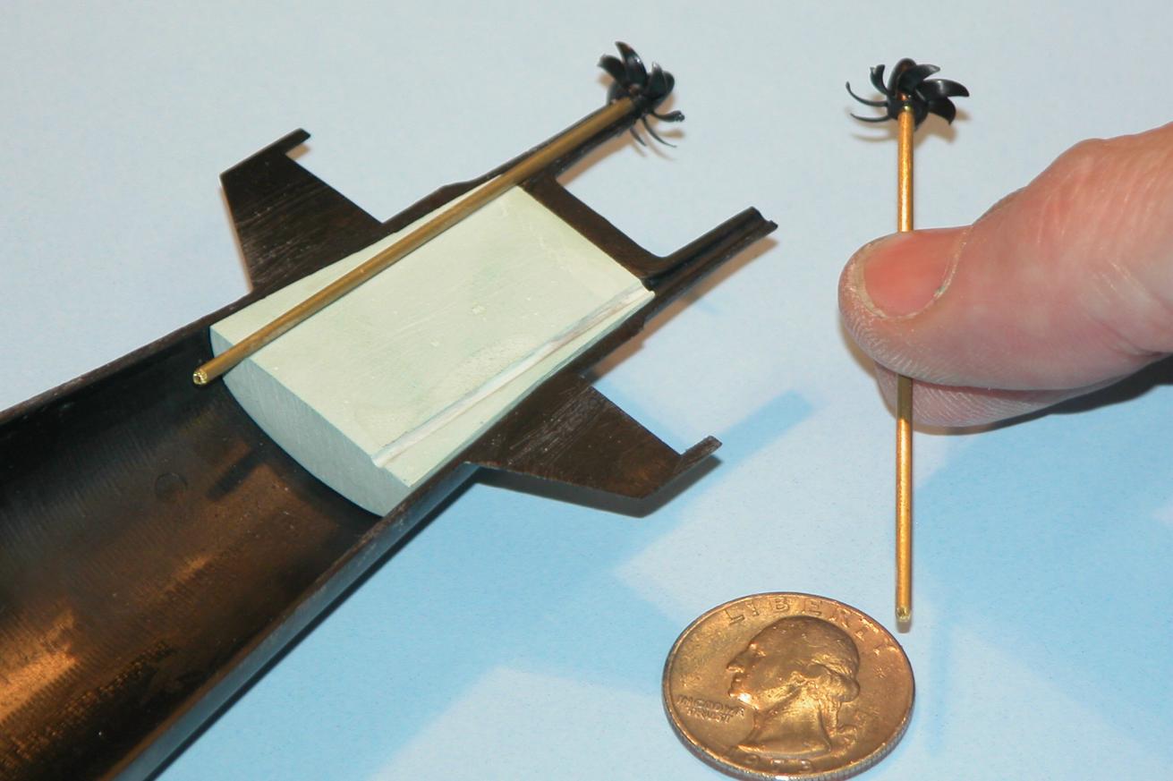

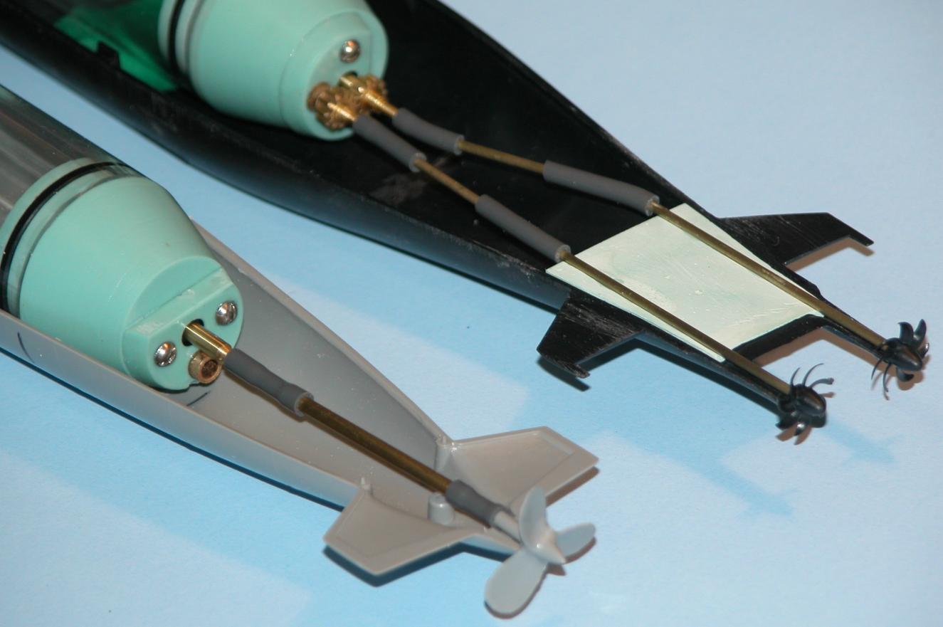

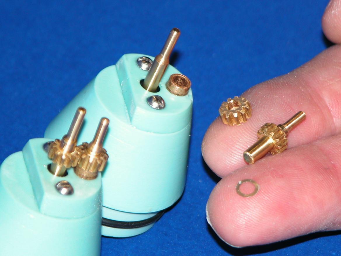

    We're dropping the old 1/230 Revell SKIPJACK SD -- this new version is little changed other than it is designed to either take the 'old' micro sized servo or the new, much smaller microbe linear servo. An addition is the inclusion of a second gear working off the main shaft, which permits running two counter-rotating propellers from the single motor.
