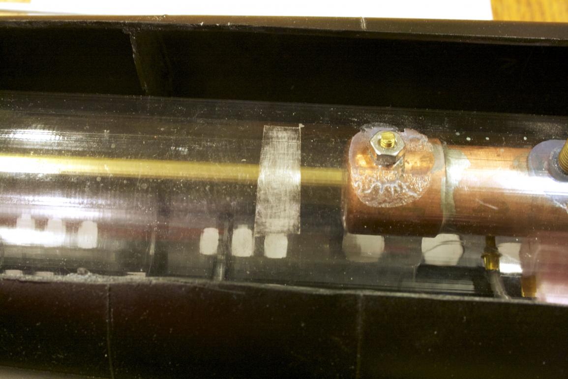

    3. CA. File the surface of the Lexan to give some tooth, contour sand the bottom of the manifold to the cylinder, position, then lay on some thin formula CA.

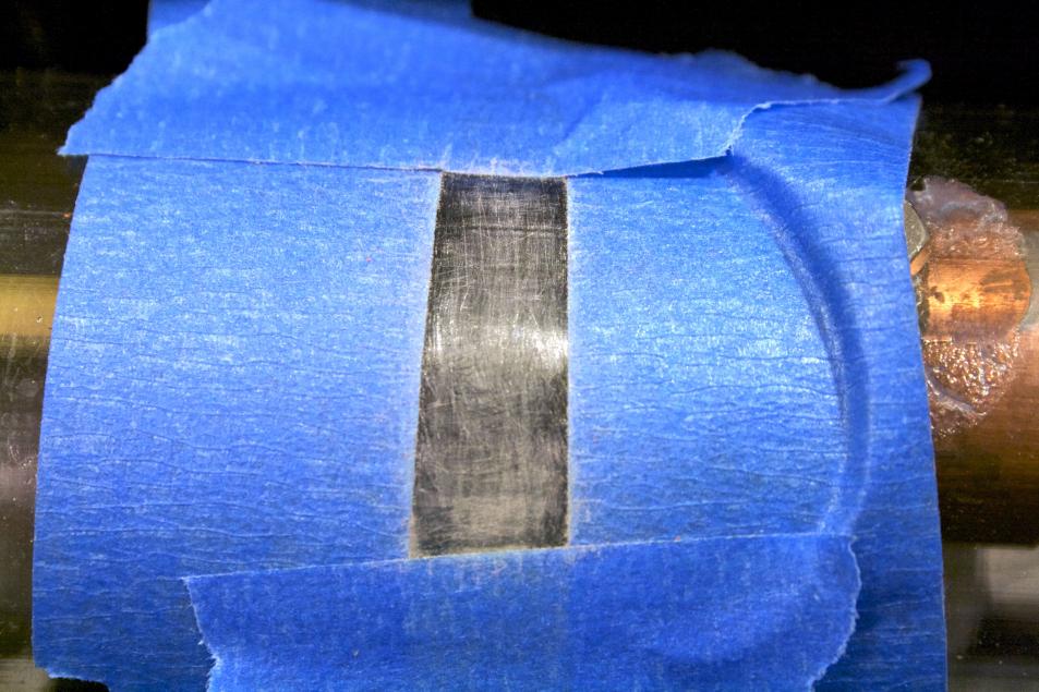

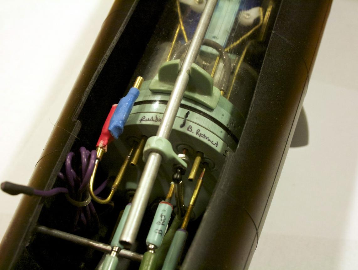

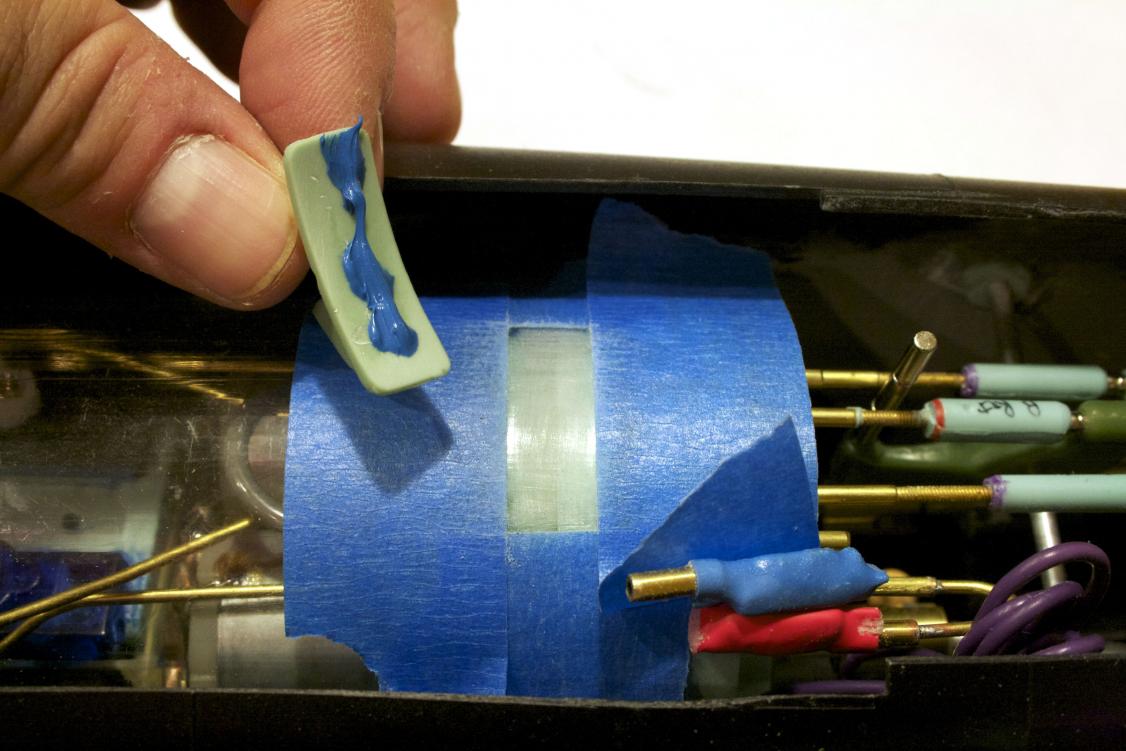

        I attached my blocks on differently, I used RTV. If the attachment is to fit the curve, lay down some sandpaper (rough side up) and sand the block against the tube. This will shape the block to your tube and prepare it to be attached.

        Then I framed the block (where you want it attached) with tape, sanded the area, (second picture was to show the clean lines that it will allow) with tape on I applied RTV to the item to be attached and there you go.
