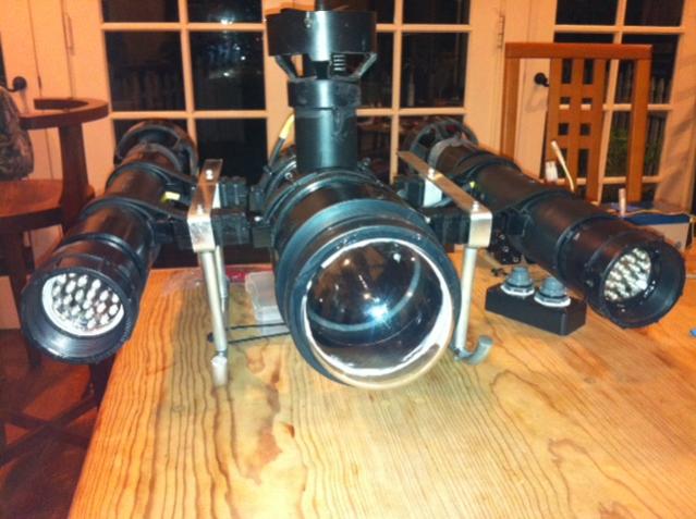

            I built a 5D (3D and 2D underwater ROV camera system that will be shown at a large diving industry show in less than 2 weeks, DEMA.Click image for larger version

              Neat looking ROV!

                  I built a 5D (3D and 2D underwater ROV camera system that will be shown at a large diving industry show in less than 2 weeks, DEMA.[ATTACH=CONFIG]16648[/ATTACH]
                  is that the Las Vegas DEMA conference?
